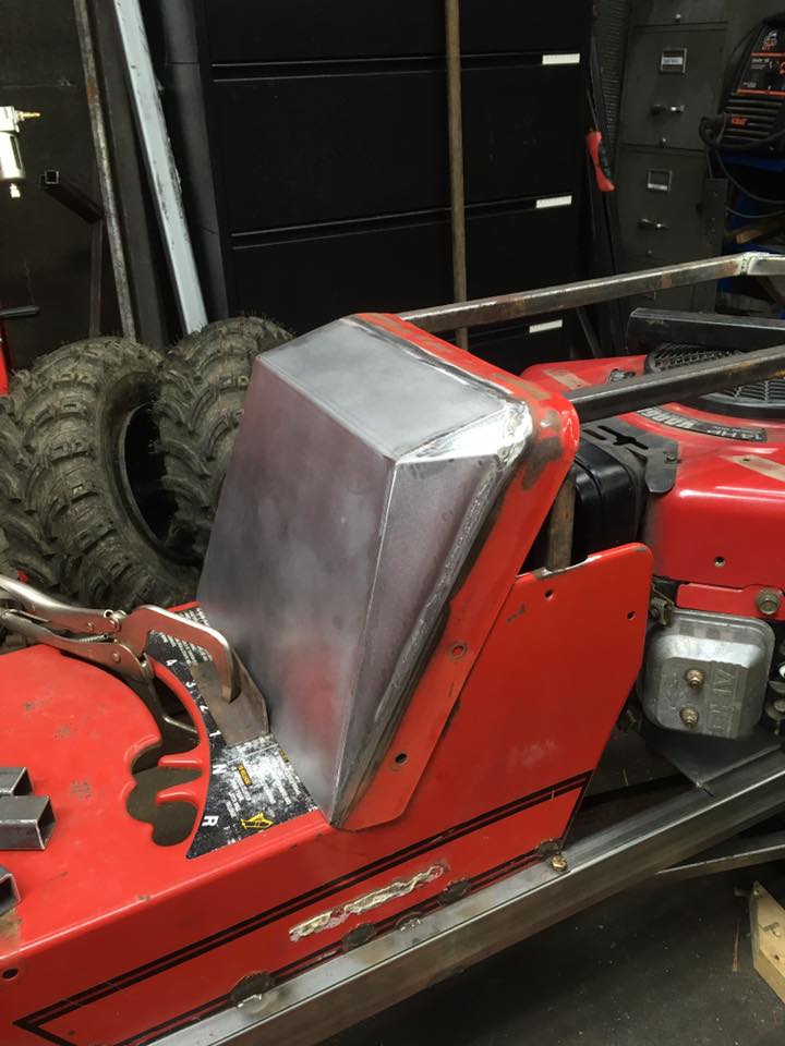

| fab work definitely exhausts me on builds, working on this thing daily has been tiring, but every little bit counts with my motor backwards with the intake facing the rear of the tractor, and chopping the tunnel down i have very limited room for a battery and a fuel tank. so in efforts to gain some room up under the dash, possibly fitting a steering shaft, intake, battery, and fuel tank up under the dash and making it LOOK GOOD is going to be a challenge, i decided to build my own dash well modify the existing dash to obtain more room 14 gauge steel to reform the new dash, welded it to the existing one and cut out the center of the existing old dash, leaving a new slightly bigger dash! ill be cutting a big portion out of the flat of the new dash to accommodated an access panel also have the main dash/upper steering support tacked into place, along with what is soon to be a removable top cage for the motor and a hood mount. i trimmed off two inches off of the grill to try and show some of the suspension more | |

| Looks good! The cage around the engine looks pretty solid. "This'll either wake you up or put you to sleep forever!"- Red Green "Whatever you do you should do right, even if it's something wrong." - Hank Hill - MTD Off-Road Build - Ford LT 110 Off-Road Build - Craftsman GT 6000 Off-Road Build - Sears LT11 Rat Rod Build *2019 Build-Off Winner!* Garden Tractor Collection: Allis B-110 x2, 710, 716, & 410 - Wheel Horse 655, 953 & 500 Special - Case 444 - Bolens Versamatic, G10 & 1668 Diesel Swapped - Cub 106, 124 & 1000/149 Frankentractor - Ford 120, LGT 125 & 145 - White 1650 Yard Boss - Moto Mower 710-100 | |
