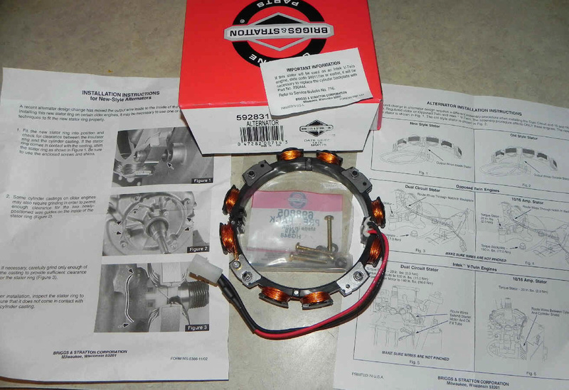

1)  The 2 wires together are alternator wires.  One (red I think) should have a DIODE next to the plug under some shrink wrapping (This goes to your battery or battery side of solenoid for charging).  That other (black) is a lights circuit from the altenator.  Most people do not use that on custom builds but you can for the lights if you do not want them to draw down on the battery.  Only thing is, they dim and brighten depending on the RPM.  There should be another black but lighter grade wire by itself coming out on the other side of the carb that runs to the coil.  That is your kill wire.
Alternator probably looks like this.

just like MightyRaze said, the cables are right, but i dont have the diode in there...i understand that its for one way? so if the battery is full it wont "charge" back? Then i should go and get one...before i connect it? Also i know the kill wire, it comes from the igniton coil... thanks MightyRaze.

The idle speed screw should be the one on the outside of the carb with a spring on it.  I determines how far the throttle plate can close.
Definitely get a diode or maybe a full bridge rectifier before you hook up those charging wires to your battery.
