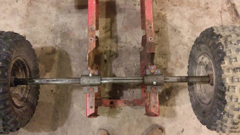

Think these bushings will hold up for what I'm doing
Rear axle mounted
Wheels in around where they will be when finalized

Interesting axle ,bushings? I like the shape of the fenders!

The axle had bearings, I took em off because I didn't see them holding up to what I wanted. Were just in stamped housings. I got the bushings from my old trade school, they were throwing em out and I snatched em up as fast as I could.

The keyed axle might chew em up quick? Can you drill em out and put in some brass bushings?
Atleast then it wearing something that more easily replaceable.
Something else to think about... that alot of un-supported axle hanging out there. That will bend without support closer to the wheel.
Looks like a fun build at any rate.
Posts : 2155
Forum Rep : 126
PostSubject: Re: RichieRichOverdrive's Snapper LT18RS [2018 Build-Off Entry]   Sat Feb 10, 2018 2:23 pm
Rich could easily weld up the keyway in that axle then machine or sand it down to make it fully round. He might already have plans to add a couple more bearings closer to the wheels to support the axle better.
Online
Posts : 1943
Forum Rep : 69
PostSubject: Re: RichieRichOverdrive's Snapper LT18RS [2018 Build-Off Entry]   Sat Feb 10, 2018 4:42 pm
I would get some cast iron axle bracket hangers, you can order full assemblies from bmikarts for around 10 bucks apiece i think. That includes installed bearings , they are what i use and have not had any issues with them.
I dont think the axle is going to bend by being out that far, i ran a 42 inch axle with 22 inch tires and had my brackets 14 inches apart in the center without bending anything.

Those cast iron things already have bronze in them, and they have grease fittings, I think they'll be fine. Aren't stretch and doc running bushings over keyways in their 820s?
I'm not really concerned about the axle bending. Not much room to move the bearings out farther(at least easily), gotta fit my brake rotor out there somewhere. Also this is an actual axle, not just some cold rolled.

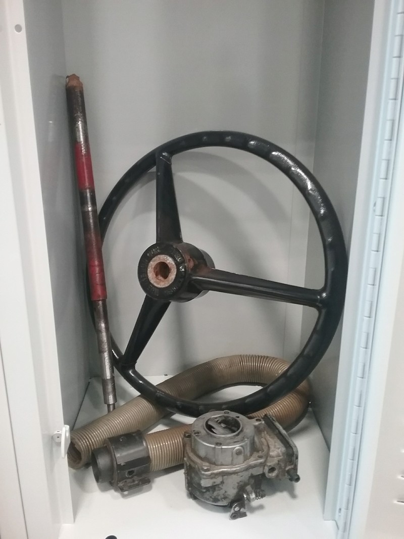

Got the steering wheel apart from the steering shaft.

Steering wheel ,.... in your locker?

My locker in machine tool lol.
