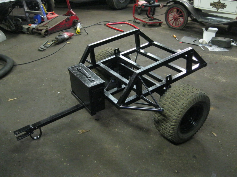

Thanks guys. I agree about the long pin hitting stuff. My plan was to put the pin in from the bottom and have it held in with a J clip. That way it would be short and also the pin wouldn't get knocked out. A normal trailer type hitch would be cool, but only my tractor could pull it then. This way any tractor could pull it.
Today I finally finished the trailer except for paint
Off Road Trailer, Designing one that's usable - Page 2 Img_6692

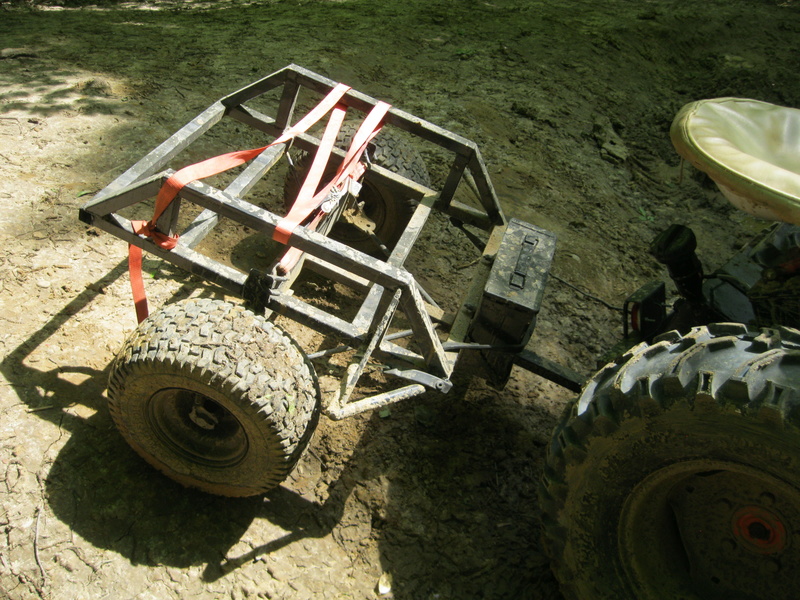

Nerf bars so you don't snag a tree. The ammo box ended up a little sideways but that's how a lot of my builds are lol.
Off Road Trailer, Designing one that's usable - Page 2 Img_6689
Water tight tool box to hold ratchet straps and tools. Place for tie down hooks mid way down the trailer. Or you can also loop around the frame anywhere.
Off Road Trailer, Designing one that's usable - Page 2 Img_6690
Storage space is 2' 2" long by 1' 6.5" wide. Sounds like a small space, but if you pack the stuff in you can hold quite a bit

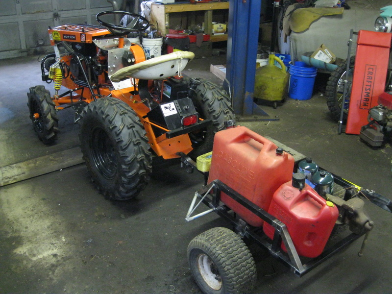

And here loaded for an extremely long cross country trip. 7 extra gallons of fuel and supplies lol.
Off Road Trailer, Designing one that's usable - Page 2 Img_6694

Vice on the back in case you need to make some serious repairs. Anyway, all I have to do now is paint it. This week as soon
as i get a good day that's not raining I'll do it. After paint the tool box has to be bolted on. Holes are drilled. Just have to paint the box separate.

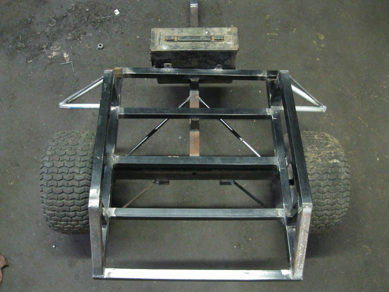

Very nice!  I like what you got going on there.  What are your plans for those triangulated pieces off the front in front of the tires?  Fenders?

Super cool mr.mod! I really dig the nerf bars at the front, makes sense that you wouldn't want your wheels getting caught on stuff and what not.

Thanks a lot. The triangle structure is just to guide the trailer around trees or other obstacles so they don't snap a spindle off or do any other damage...hopefully. On this trailer I won't be putting on any fenders, at least not now. But if and when I build the enclosed box trailer, I have cup cadet rear fenders that I'll use. They're squared off somewhat and I think they would look pretty cool. Guess we'll see how the small wheels work off road.

dose the trailer have more ground clearence then the sears?

I had to check ground clearance, looks like the skid plate under the transaxle on the simplicity is about 8" and the trailer axle is about the same.
A thing to hold a chainsaw off to the side is a good idea, might do something like that when I get time after haspin.
As for the vice, I always thought it was cool having a vice bolted onto the back of a truck. Some power company trucks around here do that too. Bit heavy but looks cool.
I'll probably bring some light jumper cables with me. Just in case someone else has problems. The simplicity is pull start only so it wouldn't help me too much lol.

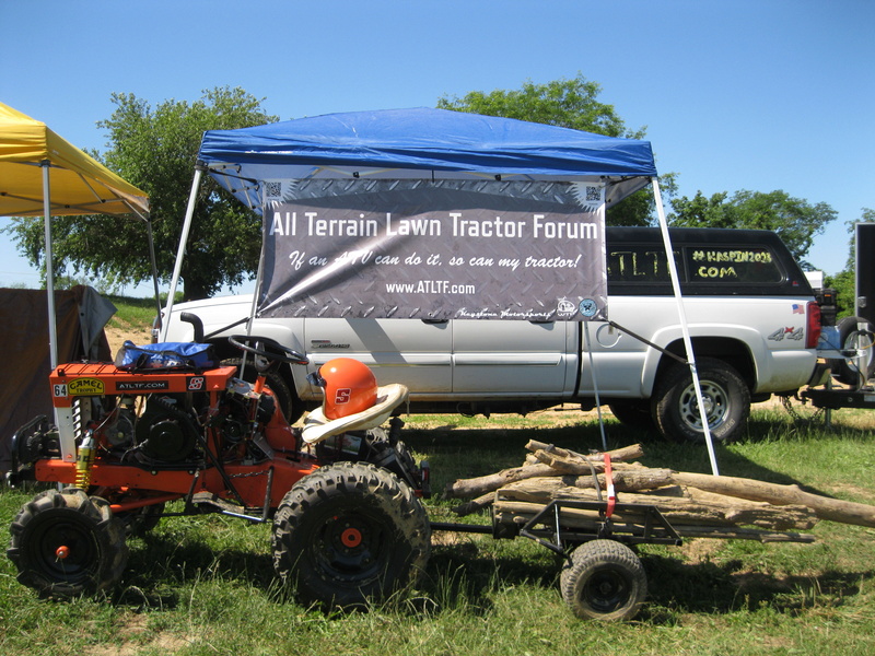

Got to Haspin on tuesday night, wednesday morning I went with Doug for a firewood run.
Hauled back a decent amount of wood.
Off Road Trailer, Designing one that's usable - Page 2 Img_6719

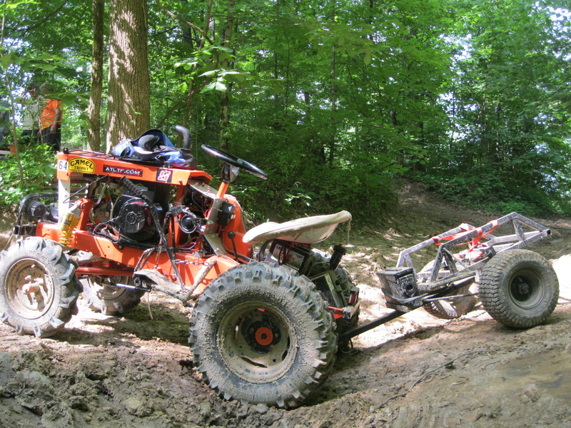

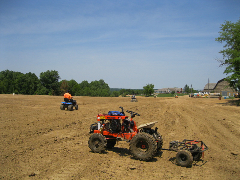

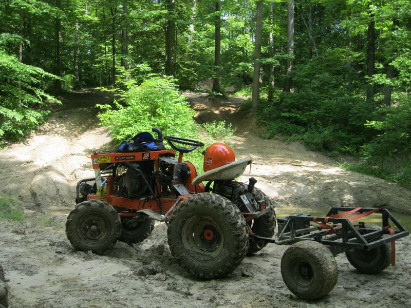

Made a couple wood runs with it and also took it out on a few of our normal rides with everyone just to test it
out and see how much it would affect the simplicity in various off road situations. Here one slight issue is
going through ditches. In extreme cases the hitch will be at the limit of travel and bind up. In fact both the trailer and simplicity
hitch bent very slightly from one tough spot, but almost not enough to notice. In this pic it is close to or at the limit.
Craftsmanquad suggested making a type of U-joint setup built into the hitch which would allow more travel but also
still have the normal style tractor hitch so any tractor could pull it without having special modifications.
Off Road Trailer, Designing one that's usable - Page 2 Img_6726

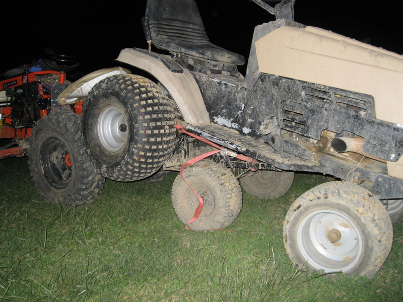

Another issue was forgetting to get the ratchet strap out of the tool box before piling wood over the lid...
So here you see the strap hooked across the trailer to prevent that from happening again. The trailer's small
size means the load is usually hanging over the ends, but I believe it's a serious advantage off road.

hook it up and forget that it's there. Even at high speed over rough ground, I looked back and it doesn't hop all over like
you would expect. I think that's also due to it being so short and close to the simplicity. It doesn't have much tendency
to wag back and forth. A recent check of the simplicity on the road indicates a top speed of around 20 mph, so we can
assume I was going from 18-20 with the trailer on the dirt road in high gear on a down hill.
Off Road Trailer, Designing one that's usable - Page 2 Img_6721
The real durability test was when CraftsmanQuad's machine got a rear flat tire. Various options for getting it back were discussed
before we decided to get the trailer and see if we could tow it back that way.
Off Road Trailer, Designing one that's usable - Page 2 Img_6722
We set the back end of the tractor over the trailer with the rear wheels resting on the trailer's nerf bars. Then a ratchet strap
held it firmly in place for the ride back. He rode on the seat to hold the steering wheel straight, so it had a decent load on it.
Off Road Trailer, Designing one that's usable - Page 2 Img_6724
It was a slow trip back uphill with the simplicity's low horsepower and also experiencing a slight throttle cable issue which
limited power even more, but it made it. I would say the testing was successful and building a more high tech version would
be worth while. Now to think about things like lighting, brakes, suspension, or having a possible passenger from a broken
down machine. Also, weight will be more important to pay attention to if I'm building an enclosed box rather than an open
skeleton trailer.

I was very surprised with how useful such a small trailer was. I’m sorry I was out on a ride when you guys left or I woulda said bye lol. It was really cool to meet you and your dad and be able to bounce some ideas around in person

Thanks. The orange simplicity helmet turned out decent, I had to trace and hand paint the S which was a bit of a pain but worked out.
No problem about being out on a run, we kinda decided all of a sudden to head out that night to get packed up before any rain came in. Drove part way back and stopped at a motel, then went the rest of the way. Broke it up a bit.
I ended up leaving the trailer with Doug, so at some point I'll have to get it back from his house.
