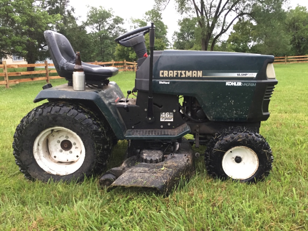

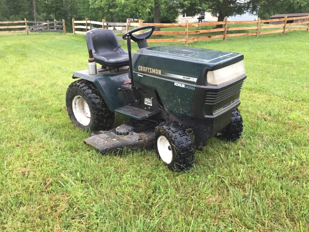

- This looks like a mint one to flip while the market is still hot or maybe keep as your personal mower.
I have a simplicity 12.5 LTH and a GT 5000 for personal mowers, but people love these green craftsmans, and I have two more.... so 3 different LTs hanging around at the moment, one I havent picked up but I bought it..... Anyway I bought some 18x6.5-8 snow tires today for the GT because I wanted some skinny taller tires for it, because I mow mostly taller grass with it, and it is bumpy in the fields around our fence..... No problems with the steering or turning radius since it turn pretty wide anyway.... | |
