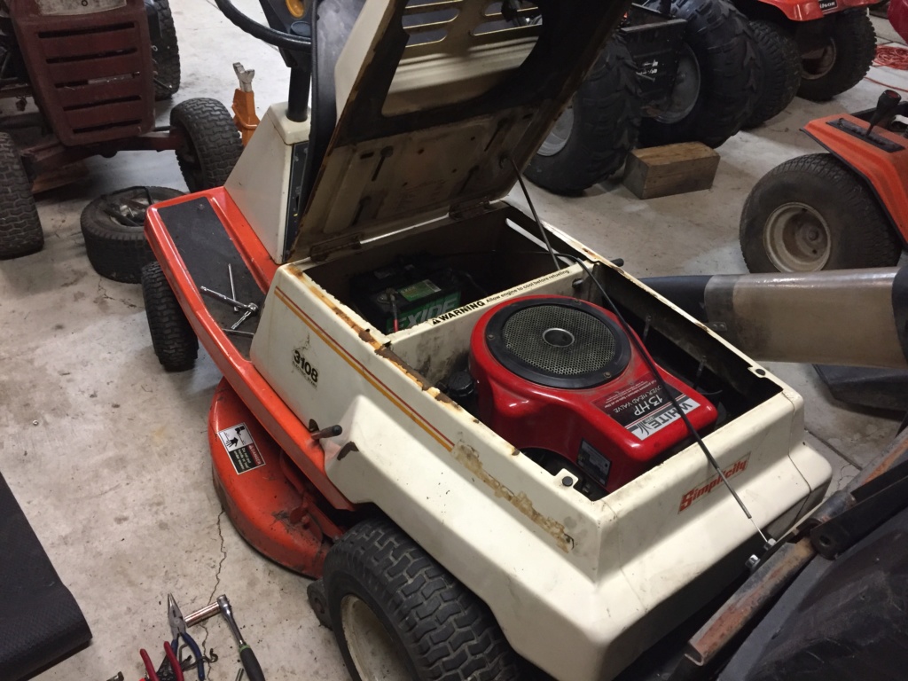

| Picked up a few more things lately but this one is pretty cool, 16horse limited slip rear, only issue with it is that reverse grinds & mostly doesn't work. Has a cool lever on it that lets you slowly take off from a stop so you don't engage the clutch fast and jump.... | |

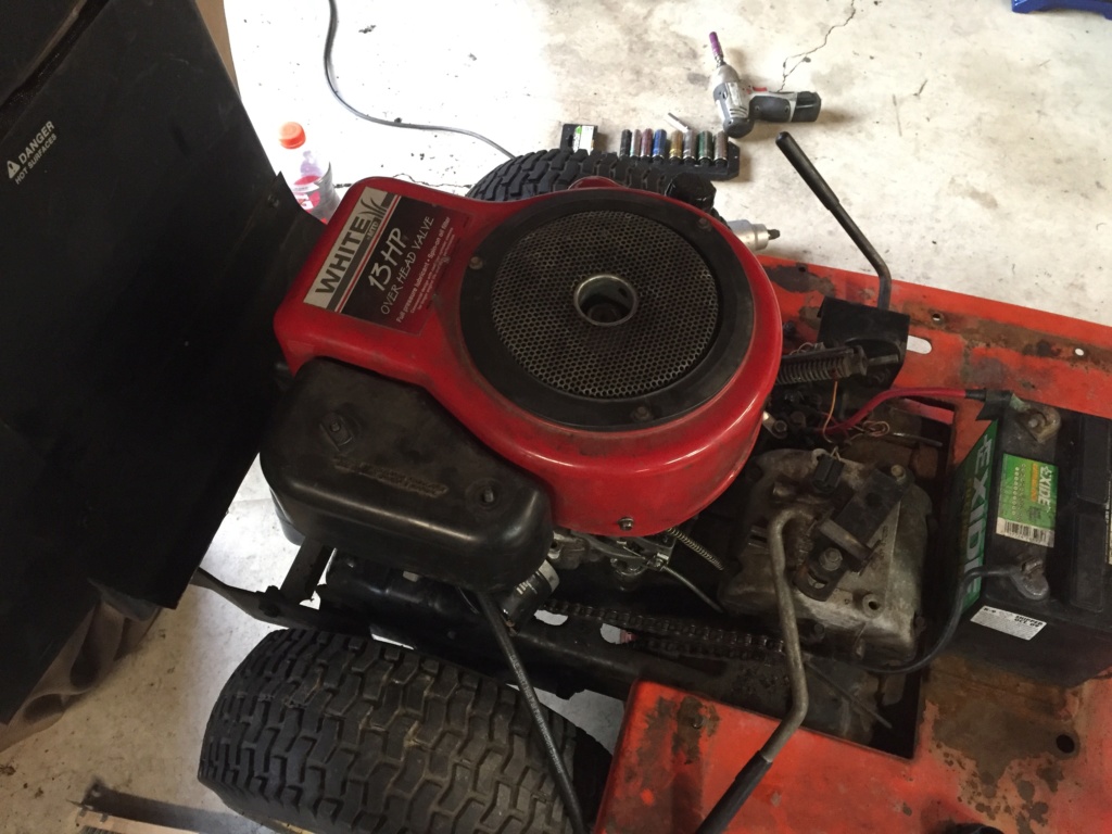

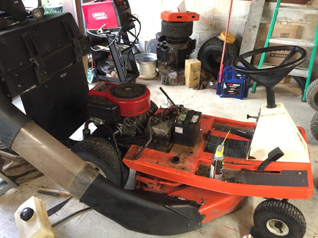

| I just completed a motor swap and started it up tonight on my 3108 rear engine rider... I put in a 13hp tecumseh OHV I pulled from a MTD White tractor... I haven't driven it yet but I hope to this weekend... | |

I really like that Simplicity! Probably a fairly well built unit. Its a 1984 believe it or not, but yeah its a nice machine... I have ok luck with the more late model Tecumseh engines but I really don't like to touch the older stuff...All the parts are more expensive than briggs IMO if you can find. I actually removed a 8hp briggs that would not run correctly to put this in. Its easier for me to take the engine out and try and mess with it then install another so I can move on. No telling how long it will take to get that 8hp motor working or if it even will. | |

| finally got the gas tank mounted, its really tight, ran the fuel line & had to mount a choke since it has to be different... Had to use a different drive pulley since the original broke & is not available... Ill have to take a pic of what i did to "lower" the pto pulley tomorrow... ran out of time as usual... | |

| I finally drove the RER and its a beast, way to much power for what it is. It is super loud with the small inline muffler. Only issue I have to fix is the drive belt slips so I have to deal with that tomorrow. So the gas tank is working the way the lines are routed etc. so I am pretty pleased. Took a min to get it started, and since the engine is spun around the throttle works opposite of normal...

| ugh i have a minor major problem, i replaced the drive belt on this thing and it still was slipping & wont go up hills, I thought maybe the clutch pulley was too small and put on another one and i still have too much slipping....
is it possible that the clutch pulley spring is too weak?, I dont want to put a smaller belt on because i know i wont be able to stop and shift etc... I hate to have to take the deck off and put on a stronger spring but that is all i can think is going on... | |
