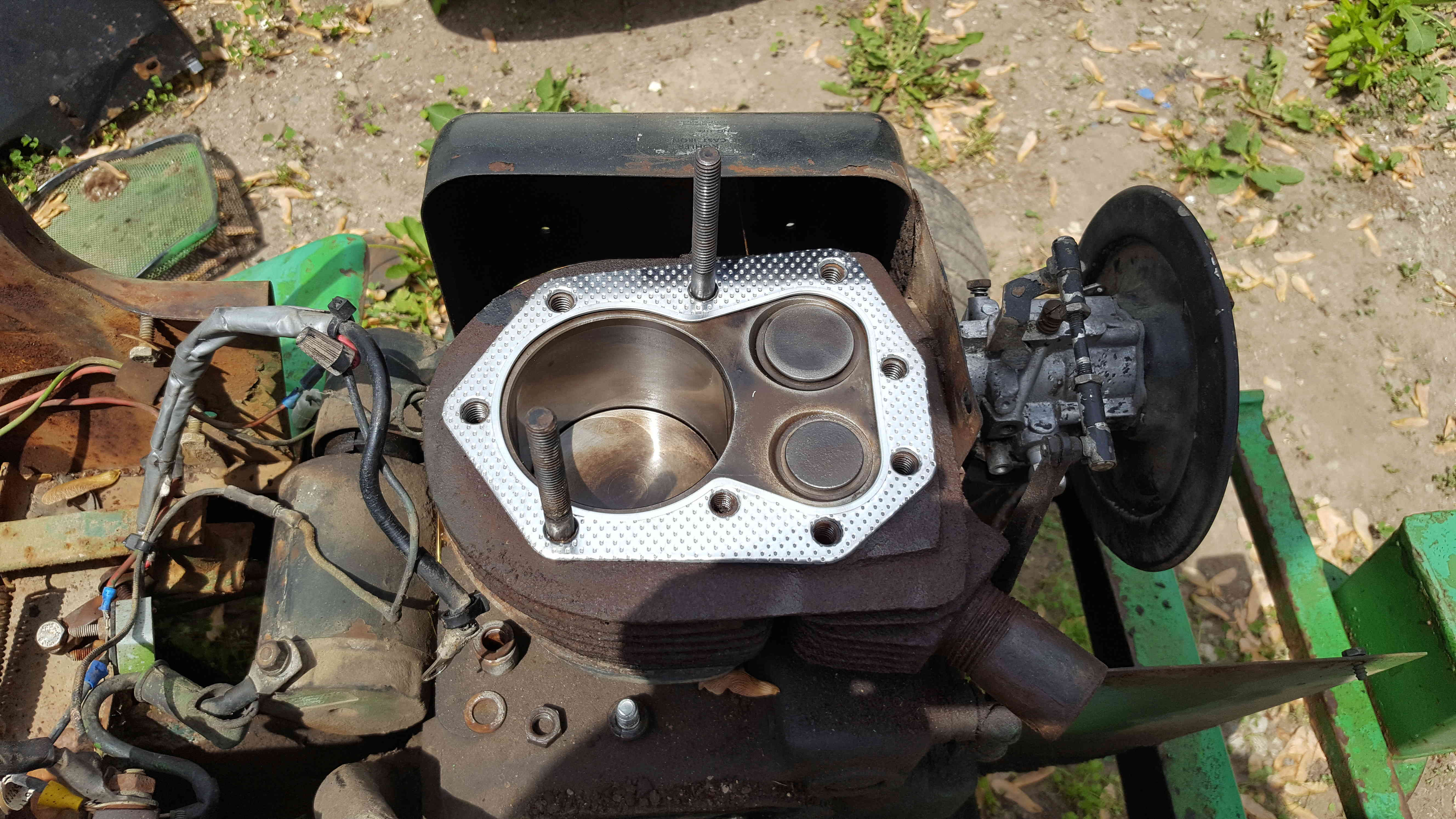

Made some more progress on the ol' 10 horse yesterday.
New head gasket in place:
John Deere 110 Project - Page 2 20180610
Did a basic head clean up:
John Deere 110 Project - Page 2 20180611
Should be good.
John Deere 110 Project - Page 2 20180612
Got the head all back on and tourqued to the proper spec using the proper pattern:
John Deere 110 Project - Page 2 20180613
Some tin work back on:
John Deere 110 Project - Page 2 20180614
Battery tray and fuel tannk mounted up!
John Deere 110 Project - Page 2 20180615
Then, after checking operation of the fuel pump and some cranking, I got 'er to fire up!! Runs pretty decent so far, no knocks or bad noises. There's a video of it starting up for the first time on my channel too. I guess I just gotta start figuring out a way to rig up a belt and clutch, shouldn't be too bad hopefully. Let me know what ya think!

Nice, I love the sound of those K series Kohlers! Cylinder bore and valves don't look too bad, seems to be in pretty good condition inside.
Posts : 4835
Forum Rep : 231
John Deere 110 Project - Page 2 Empty
PostSubject: Re: John Deere 110 Project   John Deere 110 Project - Page 2 Icon_minitimeSat Jun 02, 2018 4:00 pm
Yeah me too Matt! This one apears to have what looks like a homemade muffler on it too and it had a kinda deep exhaust tone to it, pretty cool. Also yeah the upper end is definitely in pretty good shape, haha.

Sounds good. In the pic the intake valve was a little up. That could be positioning. Does it fit good in the seat?

Haha yeah it's good that there's no knocks or anything. Also Mighty the valves do fit down in their seats pretty well, might just be the angle of the picture. It definitely has good enough compression, haha.

That's good! Like I mentioned it could have just been in the part of the cycle for it to be partially up. Looks to be a good engine!

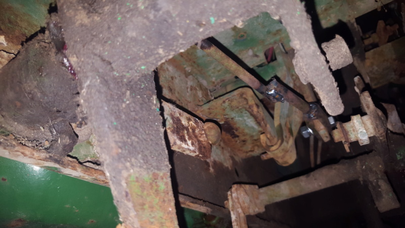

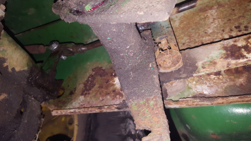

Little more work on the old JD today. Still needing a transaxle pulley so no more progress on the clutch, but I did manage to rig up some brakes.
Having it up on the hoist makes it a hell of a lot easier to work on, haha.
John Deere 110 Project - Page 2 20180658
Here's the linkage all welded up:
John Deere 110 Project - Page 2 20180659
Stuck a spring in there to bring the brakes back to the disengaged position.
John Deere 110 Project - Page 2 20180660
The linkage all mounted up.
John Deere 110 Project - Page 2 20180661
Fits up in there quite nice!
John Deere 110 Project - Page 2 20180662

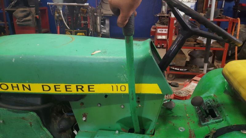

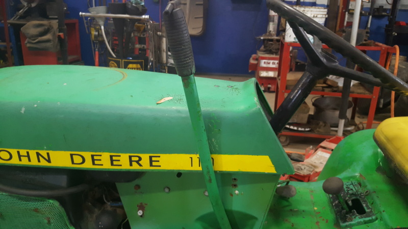

Works great! The handle doesn't have to move very far to lock the brakes up either.
Disengaged:
John Deere 110 Project - Page 2 20180663
Engaged:
John Deere 110 Project - Page 2 20180664
Should work great!
