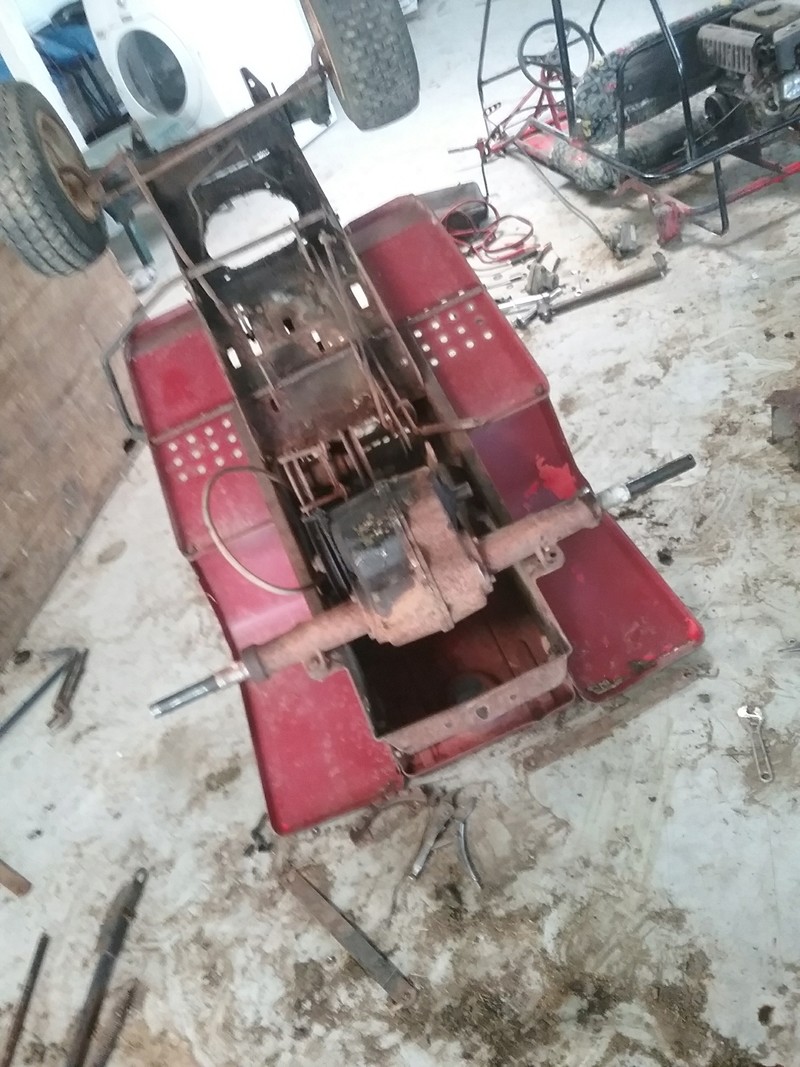

Took the trans out and managed to get one rim off with the help of a torch, the other had to cut off with the angle grinder.

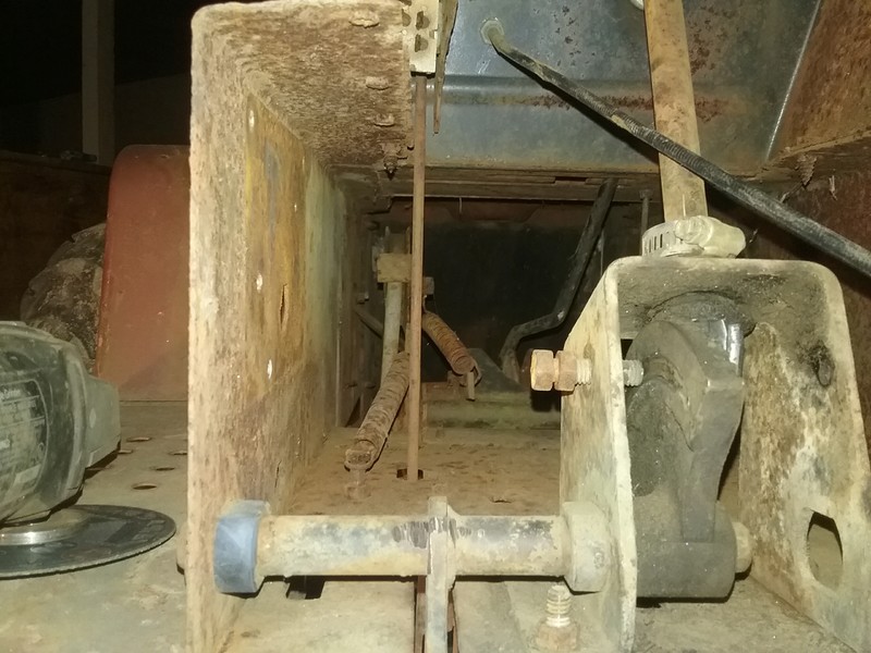

also would you look at that steering tightener bolt mmmmm

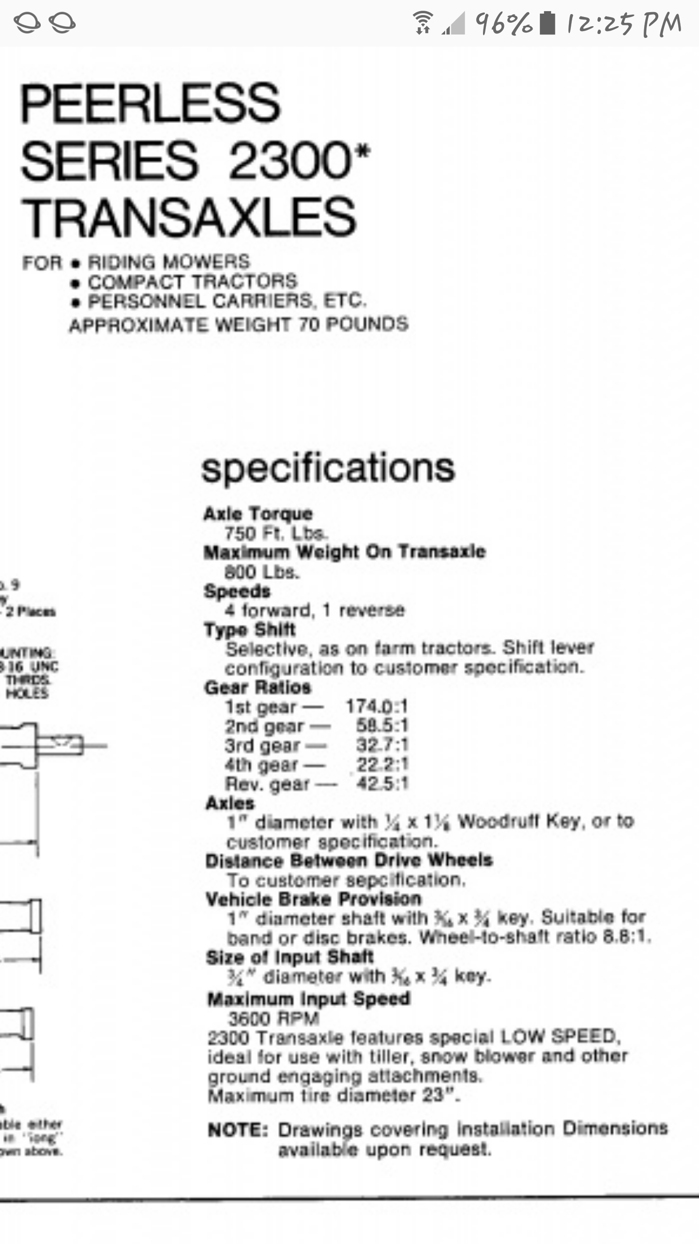

Anybody know the gear ratios on these 2300s? I think i have a pretty narrow pulley selection at the moment and I'd like to know what speed I'm gonna get lol
Posts : 1943
Forum Rep : 69
MTD - "Budgie"  Empty
PostSubject: Re: MTD - "Budgie"    MTD - "Budgie"  Icon_minitimeSun Jun 03, 2018 12:18 pm
No idea, pretty low, I will go out and get a ratio in about if you want
Posts : 2524
Forum Rep : 84
PostSubject: Re: MTD - "Budgie"    MTD - "Budgie"  Icon_minitimeSun Jun 03, 2018 12:22 pm
I mean i can go out and get a general gear ratio myself, but I'd like some more exact values lol
Posts : 4644
Forum Rep : 208
PostSubject: Re: MTD - "Budgie"    MTD - "Budgie"  Icon_minitimeSun Jun 03, 2018 12:29 pm
Here ya go Rich:
MTD - "Budgie"  Screen20
22.2:1 in 4th gear. Definitely some fairly low final drive ratios, but at least you know what they are now.

Holy hell, this thing is geared lower than i thought! Lol

Took some mower mounts off and getting the trans back in

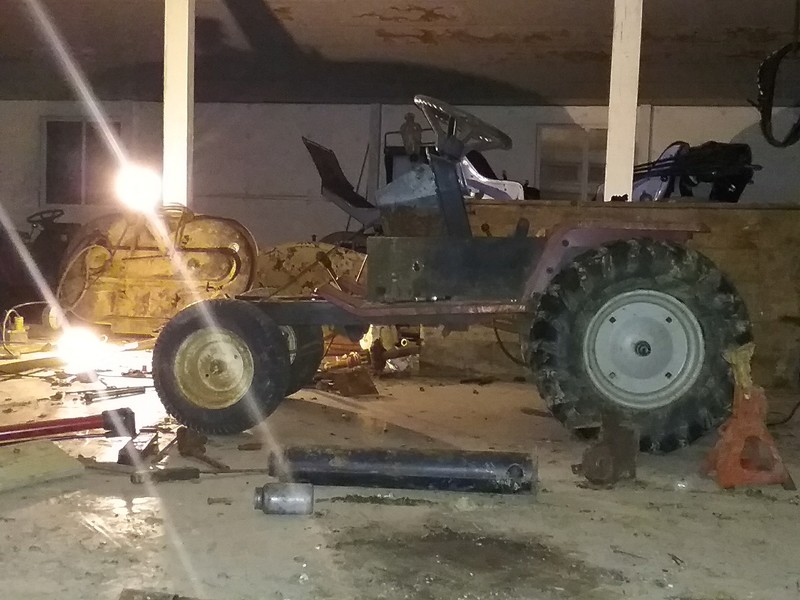

Well she's back on four wheels at least.

Looks good on all four. ITPs look nice Smile
