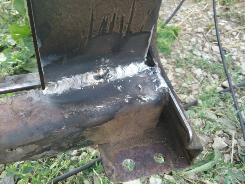

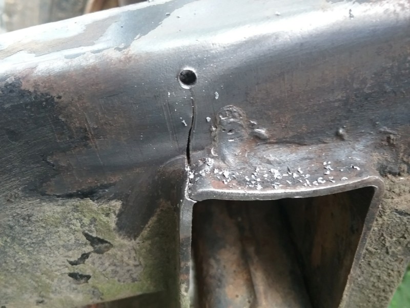

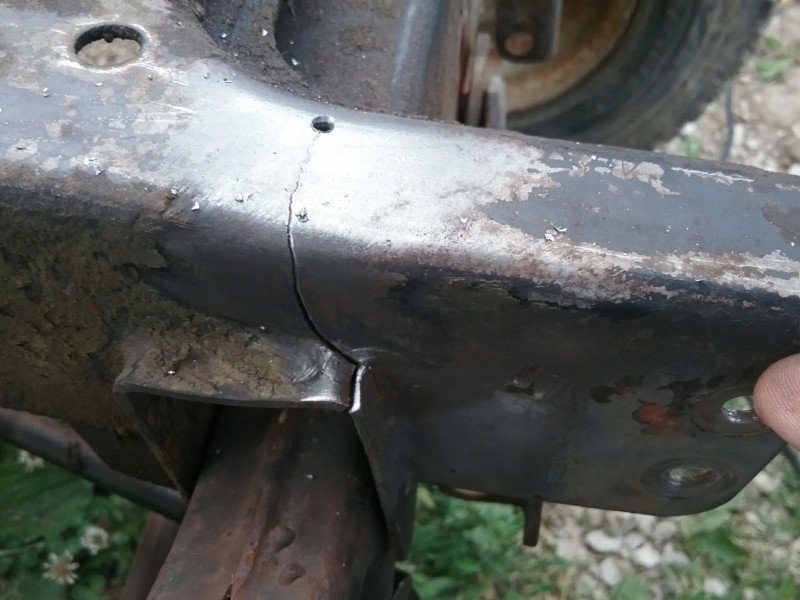

Most important part of welding cracks, you drill a hole at the end. Welded it and grinded it but forgot to get a pic.
MTD - "Budgie"  - Page 2 20180630
MTD - "Budgie"  - Page 2 20180631
Not a good example of my welding
MTD - "Budgie"  - Page 2 20180632

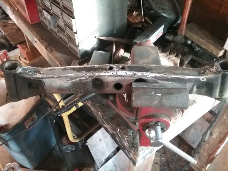

Now for some front axle strengthening
MTD - "Budgie"  - Page 2 20180633
Turned out ok, not done yet though.

Yep, always a good idea to drill the ends of a crack before welding it, that way it doesn't just keep going. Haha. Looks good! Gonna do the steel on the bottom of the axle too or no?

You see a lot of people splitting the ends of the these stamped steel axles open.  This bracing should help a lot.

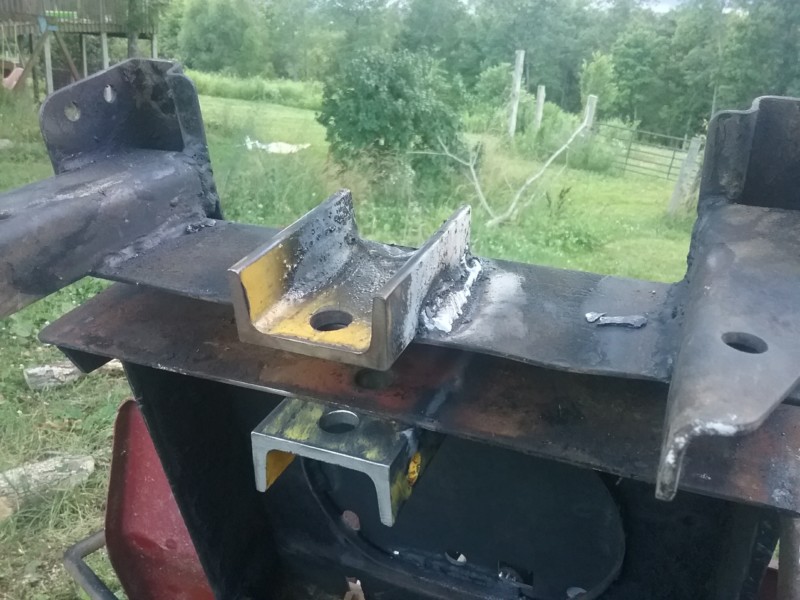

I guess this is it. Ends are ugly but oh well. Welded up the seam on the bottom a bit better, and added a better center pivot by drilling out the hole and welding in 1/2" pipe and drilling it out to 5/8".
MTD - "Budgie"  - Page 2 20180639

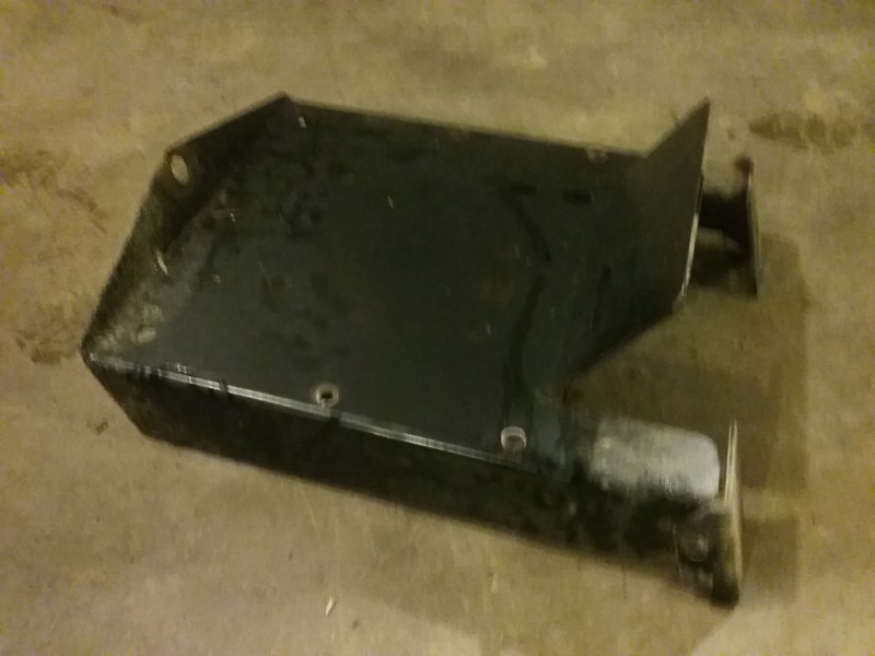

Oh, and found something to use for an engine mount plate. Hitch plate from the murray gt i stole the 820 and all the other stuff from. 3/16" or 1/4" plate, plenty heavy for what I'm doing.

Yeah welds aren't the greatest but it looks strong.  That looks like some great scrap material to make a motor mount out of.

Cut the plate down to fit. The sides just happened to come down as far as the frame, which is cool. Perfectly cut a 13/16" strip out of the middle, honestly I'm proud of myself lol.
MTD - "Budgie"  - Page 2 20180641
Welded and painted. Would have kept going with the axle pivot but the sky turned kinda dark and i didnt wanna get rained on.
MTD - "Budgie"  - Page 2 20180642

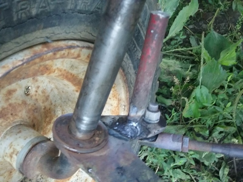

Got one steering stop welded on.

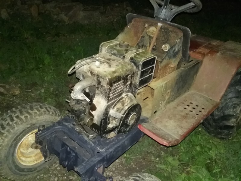

Got the other steering stop on so i decided to work on the engine. Decided on using this big beautiful 60s 6hp Briggs
Took a bit to get this pulley off. I wish it wouldn't have broke.
MTD - "Budgie"  - Page 2 20180646
Looks good on there. Under the hood should be pretty roomy.
MTD - "Budgie"  - Page 2 20180648

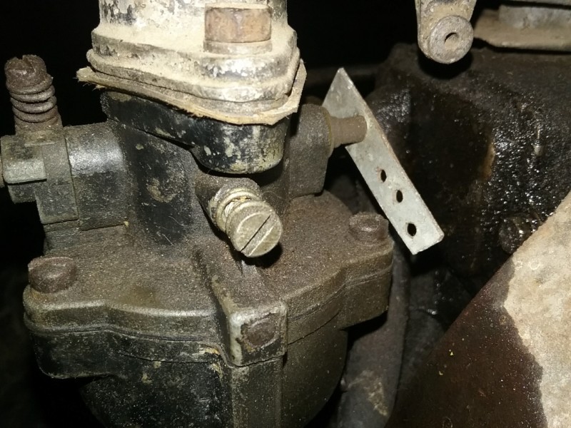

The original throttle arm was broken off, I put this thing on but i dont know how it will fare. We'll see i guess. Running it ungoverned.

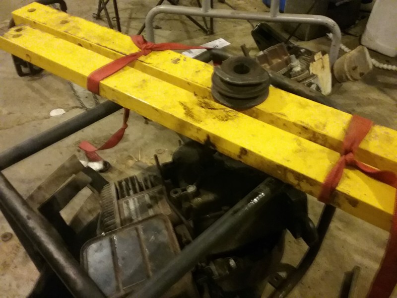

Oh, and i made a pulley for her out of the Murray GT deck pulley. Pretty much the same as the one on Mutt.
MTD - "Budgie"  - Page 2 20180651

Good old updraft carb, haha. Looks pretty good in the frame there Rich, should work out well.

The engine suits the frame quite well. That Briggs will outlast a Honda clone by far. Btw, what happened to the clone engine?
