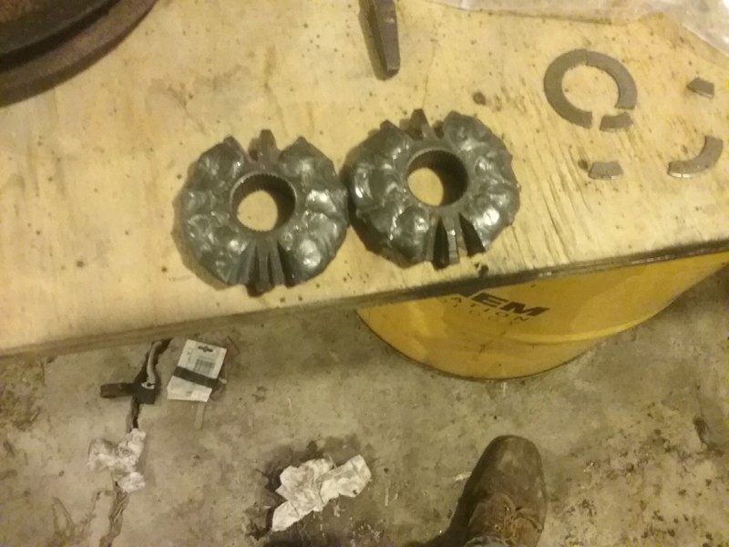

The inner axle seals were displaced and letting oil through(explains the problem i was having) and these roller bearings were all blown apart, and the shims/thrust washers behind the spider gears were broken. Remind me to just cut the wheels off next time, lol...
I got a close enough OD measurement and found a part number for these bearings. Guess I'm lucky peerless uses almost all off-the-shelf parts rather than in house parts.

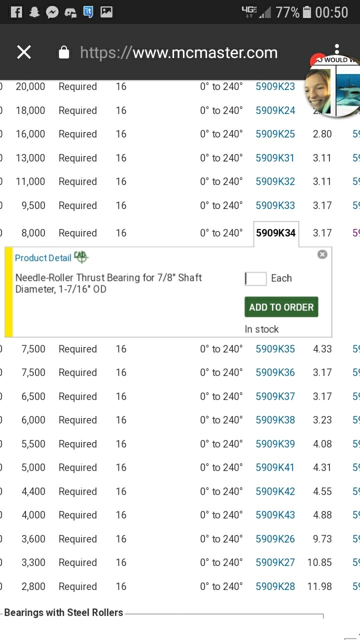

Ordered a pair of NTA-1423 thrust bearings from ebay, should be here before next friday or so.

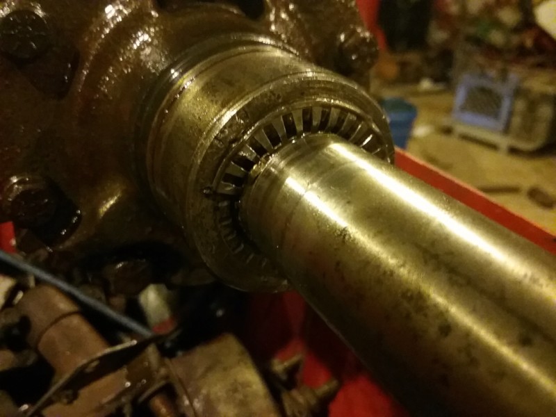

-There is a little knurled part that prevents the diff carrier halves from coming off, right before the splines for the spiders gears start. On both sides, when I tried to drive the axles out, a sleeve that was pressed into the diff carrier(oddly enough, 1" OD, so if I were going live axle, I wouldnt even have to drill the sides out to 7/8") came out of the diff carrier sides and stayed on the axle halves. I pushed it back from the knurled part and ground the knurled part off on the bench grinder so I could assemble and disassemble the carrier easily. I don't get why they made a whole extra step of knurling that little 1/8" part, especially after the diff carrier halves and needle bearings are on. Possibly just a thing to ease assembly. Who knows.
-The input shaft is splined. Shouldn't have expected much else from an MTD order. Luckily the pulley came right off. In the future I can probably turn the shaft down to 5/8" if I really want to pulley swap it, without doing the whole pulley hub swap thing.

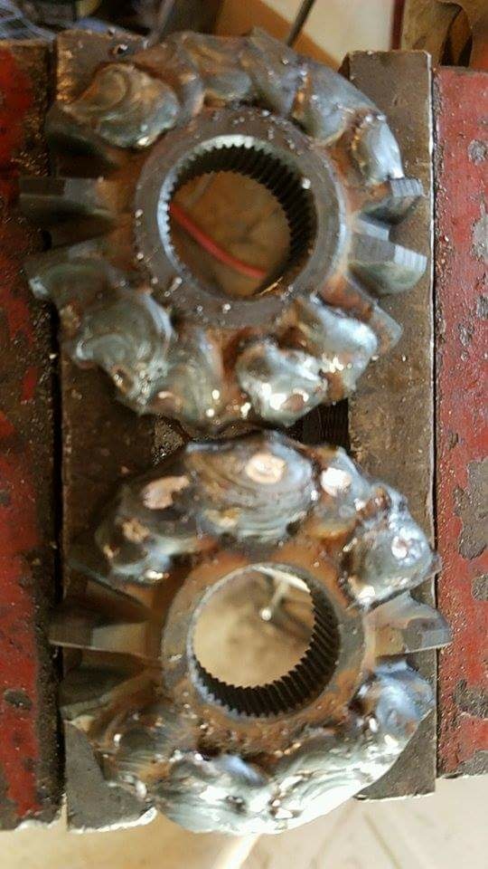

Oh, and some thoughts towards locking this thing. I'm going to have to do a really clean weld job with the fozzy and build the welds up so the axles/spiders are as tight as possible. This diff carrier is open to the rest of the trans, I don't want any metal particles getting into the bearings and such. Maybe I should consider a magnetic drain plug just in case? Lol

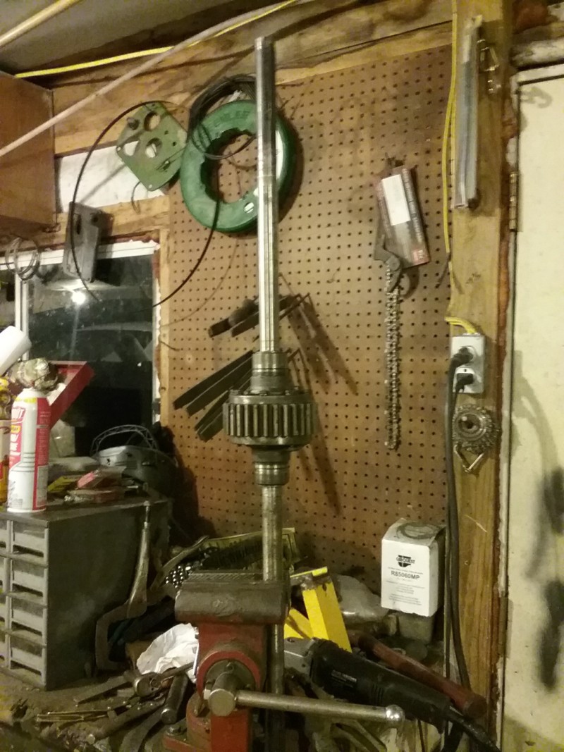

Roller bearings got here today

Got to filling in the first tooth and the mig ran out of gas. Naturally, lol

Weooo
Man this thing is tight. No slop at all.

Nice job on the fozzy lock.
