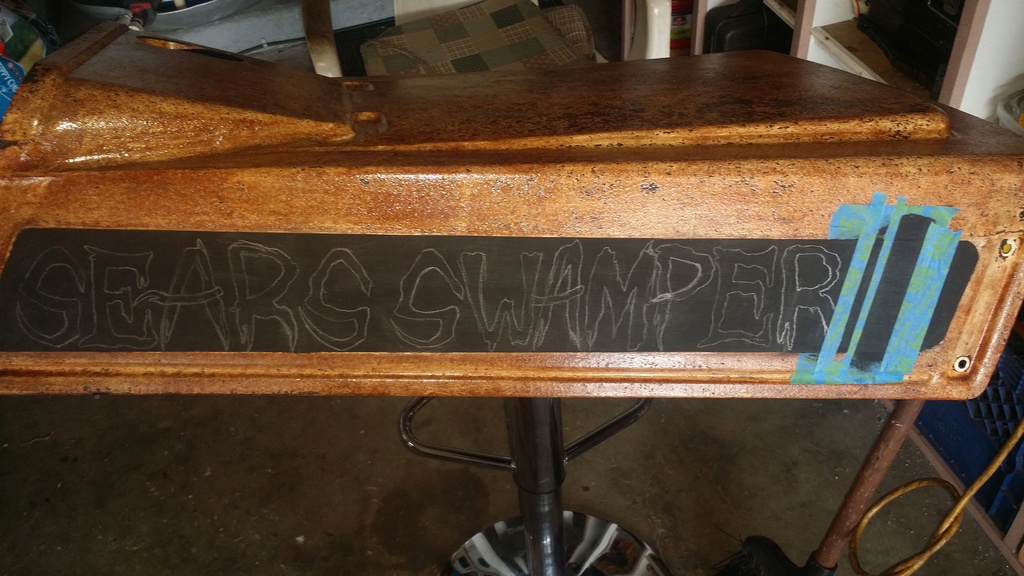

So far( in the above picture I masked off the stickers and clear coated the hood . I'm actually now going to start painting hood stickers tonight . Also I got creative on the grill but I may went a little nuts on the vents on the grill.

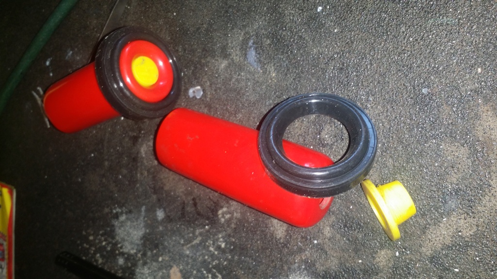

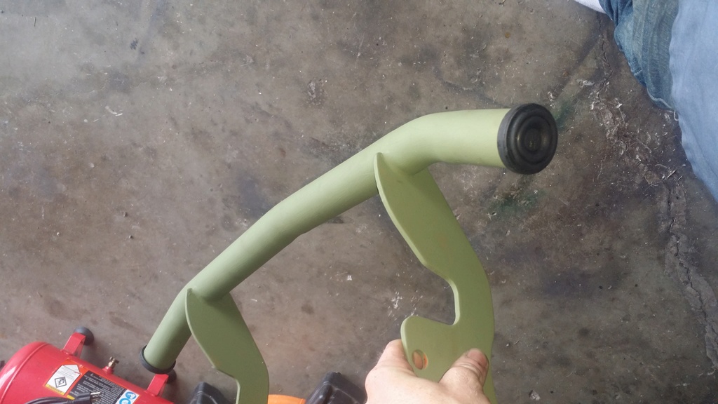

Since we are getting some scattered thunderstorms down here ... I been messing around with paint in the garage . And found some use for the milk jug of plugs from new parts in dealer , I accumulate many throughout each week. Nice for plugging leaks during r&r on tranny lines and etc. So for the bumper, I thought the open sides were eye sores . So I made up a plug with 2 valve cover spark plug tube gaskets and 2 different styled plugs . Take a look
GasketCase's SEARS Swamper LT [2018 Build-Off Entry]  - Page 2 20180611
GasketCase's SEARS Swamper LT [2018 Build-Off Entry]  - Page 2 20180610
I then painted them black to look like this . I think they came out pretty neat.
GasketCase's SEARS Swamper LT [2018 Build-Off Entry]  - Page 2 20180614
GasketCase's SEARS Swamper LT [2018 Build-Off Entry]  - Page 2 20180615
I've also clear coated the transaxle after painting it and came out very well . I'm anxious to put it back under the sears but with the wheel still giving me trouble, I'm deciding to leave it off for now until I get the hole shot tires from my buddy . Here's where it stands as of now

I'm currently sketching a new logo on the hood . Not looking forward to duplicating it, to the other side . But it shall be done tonight . Maybe even painted . I'll take a picture in a few of the pencil sketch . Just got 3 more letters.

OK, so here's how it looks so far. After sketching 80 different styles. I think I've found the one I like. What do you guys think?
GasketCase's SEARS Swamper LT [2018 Build-Off Entry]  - Page 2 20180617
It will be painted in the same color as transaxle to give it the swamp/lagoon feel

Very nice looking.
