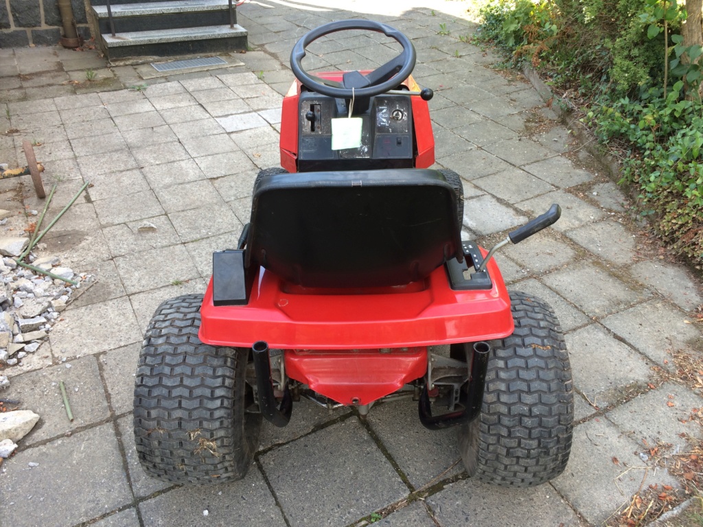

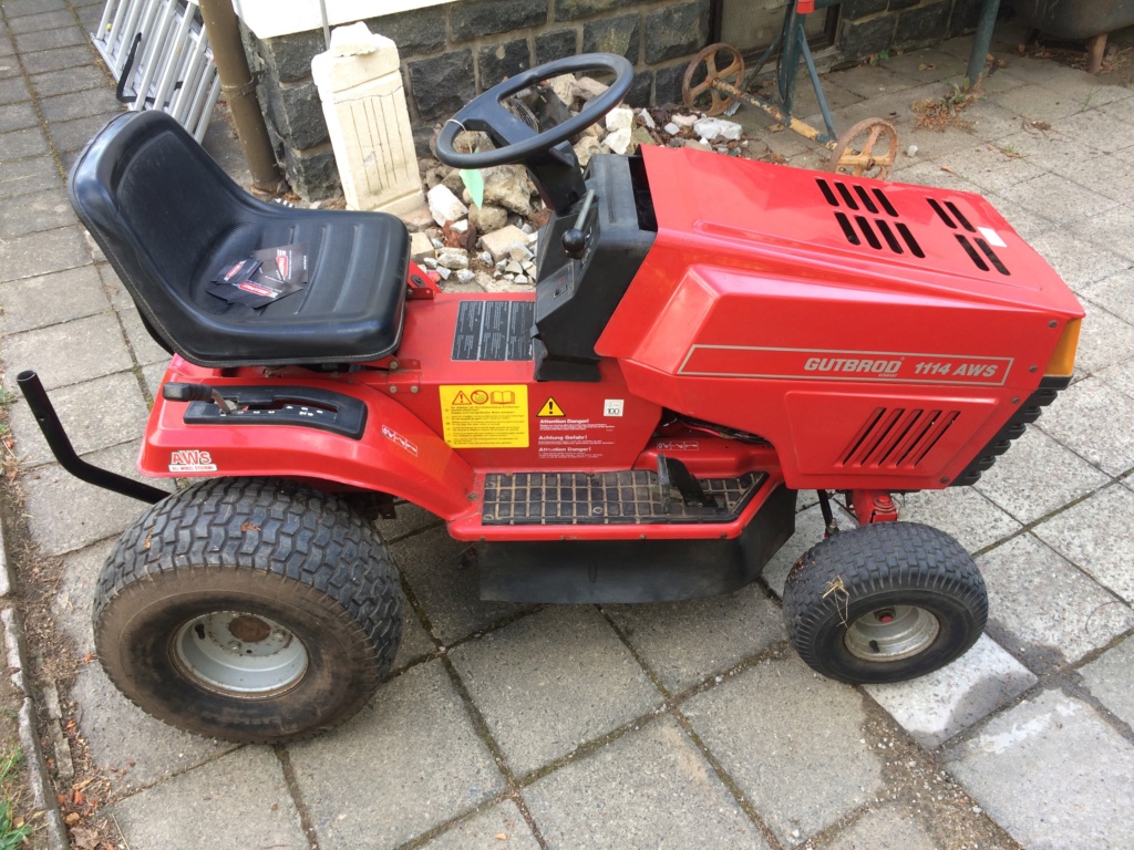

| I MADE TODAY THE BEST DEAL OF MY WHOLE LIFETIME!!!!Well, let me calm down, tell you the whole story, while enjoying a Beer! I looked for a AWS Transaxle since long time. Then I found this: an Dynamark-based Mower from the 90s without deck, but it had a AWS Transaxle, and a Vanguard Engine! (I wish I could show U the pics the seller sent me, but in G we got new laws, so we get punished if we share pics U hand't took your own public. ) I foght a pretty bad, hard fight, trying to show Dad, the Mower would be fully worth it. And after Long hard Work, I finally got him to agree. We Drove the seller, and again stuffed it into my dads car, like every other mower I own. Here are some Pics I took off him at home: For DOM 1990 it's in pretty good Shape! here are a few Pics I made off the AWS Transaxle. It seems to be an Peerless 930. And finally some Pics of the Vanguard. I got it running and driving just 1 hour after we unloaded it! The Engine is complete, I just needed to pull the air filter off, cuz the fuel pump was pumping gas into the carb, and the Engine wo'nt run on the carb, and the seller said, he ultrasonic cleaned the carb. It was the Fuel Solenoid that was stuck and someone ripped off the wire accidentally. I pushed the plug in the solenoid all the way down, and then it ran! Now you ask: ,,Why I share that stuff in the Mud Murray Thread? Easy Answer! It's kind of a shame, but I will do it! I will PART THIS MOWER OUT! The AWS is going into MUD MURRAY, so I build a 4X4 Mud-Murray!! The Engine into Murray Widebody! I hope you like that! | |
Age : 23 Join date : 2016-04-12 Points : 5709 Posts : 2617 Location : Indiana
| Subject: Re: Mud-Murray Offroad Mower August 11th 2018, 2:43 pm | |
| Read redzz02’s 4wd thread very carefully, because he built his on the dynamark platform, which is pretty similar to the stamped frame on the Murray. You might learn some tips from it | |

| I had some time, and pulled the AWS Peerless 930 outta the Gutbrod (it has now his own thread) Was some hard work, but 1 step closer to a 4X4 Mower! | |
