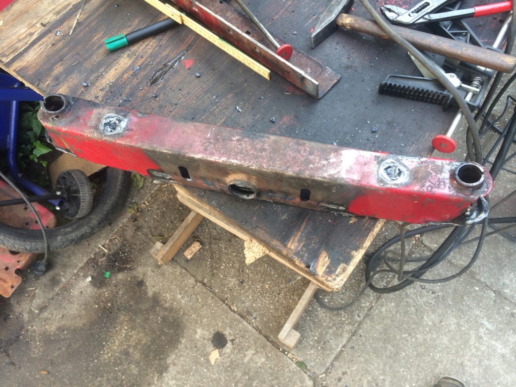

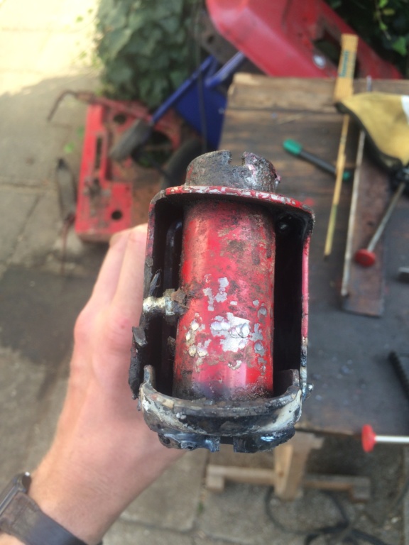

I welded the last parts of the front axle.
Stock... (looks very weak)
4X4 Mud-Murray Offroad Mower - Page 4 20180818
PLEASE DO'NT EAT WHILE READING THIS POST! U CAN PUKE FROM SEEING MY WELDS!!
4X4 Mud-Murray Offroad Mower - Page 4 20180819
Front Axle is now double as haevy as stock! Sturdy enough for my applictions I would think!

Are you going to put a grease fitting back in that?
Yep just sideways cuz the old area is blocked. Need to machine Bushings next.

@MatthewD wrote:
Good job on the bracing, this frame is really beefed up. Now you shouldn't have to worry about it flexing when you off-road. I think you need to turn the voltage setting of your welder up a bit, and the wire speed. Those bearings are cool, I need to get some for my MST.
I weld this thick stuff with the Stick welder, at max power setting. The Wire Welder wouldn't handle it really Good i think. I need to figure the right technique to feed the slag outta the weld while welding too. But i hope it will hold. Otherwise I Hate myself for building Mowers.
Posts : 2221
Forum Rep : 132
4X4 Mud-Murray Offroad Mower - Page 4 Empty
PostSubject: Re: 4X4 Mud-Murray Offroad Mower   4X4 Mud-Murray Offroad Mower - Page 4 Icon_minitimeWed Aug 08, 2018 9:33 pm
Looks like the frame should hold up.  You made have gone a little overkill under the floorboards.  Are you doing anything where the transaxle mounts?
SebastianAlbrecht
SebastianAlbrecht
Join date : 2018-02-27
Posts : 1102
Forum Rep : 45
Location : Saxony, Germany
PostSubject: Re: 4X4 Mud-Murray Offroad Mower   4X4 Mud-Murray Offroad Mower - Page 4 Icon_minitimeWed Aug 08, 2018 10:10 pm
Overkill is way better than too weak. I haven't planned anything to the transaxle mounts now. I can add some reinforcements easily.

I looked at Ebay for 8" ball bearing front rims.....
with shipping to me..
220$ !!!
Mad Mad Mad Mad
I needed another solution!
So I saw the Vid of RCG modding Snowblower rims to fit his mower with ball bearings in them
I had the FNR Rims lying around off my buds POS Rat Rod Mower things
and I have 10 Axle bearings...
that sounds like: HOMEMADE FRONT RIMS! YEP!
I chopped off the hub
4X4 Mud-Murray Offroad Mower - Page 4 20180840
4X4 Mud-Murray Offroad Mower - Page 4 20180842
and I found some steel pipe that fitted the outside diameter of the bearings.
I cut off some slices and put them in my metal lathe to get them perfectly flat at the ends and at the right length.
4X4 Mud-Murray Offroad Mower - Page 4 20180841
and I hate throwing something away, even if it's junk, it could be helpful someday. So it was with the Axles off the blown FNR.
I put the axle in the part what's left of the hub, a axle bearing on the shaft, slide the pipe over it. Centered!
4X4 Mud-Murray Offroad Mower - Page 4 20180844
I used the outside of the rims as the new inside, cuz otherwis I would get into trouble with my front axle, and the rims would hit the axle.
4X4 Mud-Murray Offroad Mower - Page 4 20180845
this is the old inside, now the new Outside
and I machined the longer bearing guides for the inside
4X4 Mud-Murray Offroad Mower - Page 4 20180843
I welded on the other side too
4X4 Mud-Murray Offroad Mower - Page 4 20180847
now I just need to take the rims to the company my dad works for, and ask them if tey could drill me the center out to 20mm.
4X4 Mud-Murray Offroad Mower - Page 4 20180846
I really like the new rims, and they cost me nothing then the bearings. And hopefully the drilling job will be free too.
