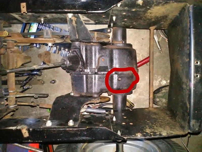

PostSubject: Re: MTD trail build   MTD trail build - Page 3 Icon_minitimeSat Jun 30, 2018 11:10 pm
Does anyone know what this plug in for?
MTD trail build - Page 3 20180640 thought it might be for a vent tube that was never hooked up, i don't want to hook up a vent tube if it's for something else.

PostSubject: Re: MTD trail build   MTD trail build - Page 3 Icon_minitimeSat Jun 30, 2018 11:59 pm
Interesting... I do not have a plug there on mine.

PostSubject: Re: MTD trail build   MTD trail build - Page 3 Icon_minitimeSun Jul 01, 2018 4:12 pm
Just checked mine, doesn't have it either. I call it fair game for a vent line.

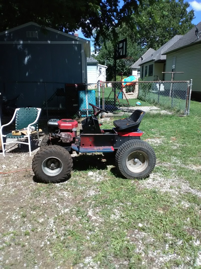

PostSubject: Re: MTD trail build   MTD trail build - Page 3 Icon_minitimeWed Jul 04, 2018 6:43 pm
Got the front wheels done
MTD trail build - Page 3 20180711
MTD trail build - Page 3 20180712I don't think that it looks too bad but now the frame flex is really noticeable, guess I'll work on the frame Bracing next

PostSubject: Re: MTD trail build   MTD trail build - Page 3 Icon_minitimeThu Jul 05, 2018 1:35 am
Looks good. You better get on bracing that front axle too. Mine had a lot of flex and the pivot hole was hogged out like 1/2" lol.

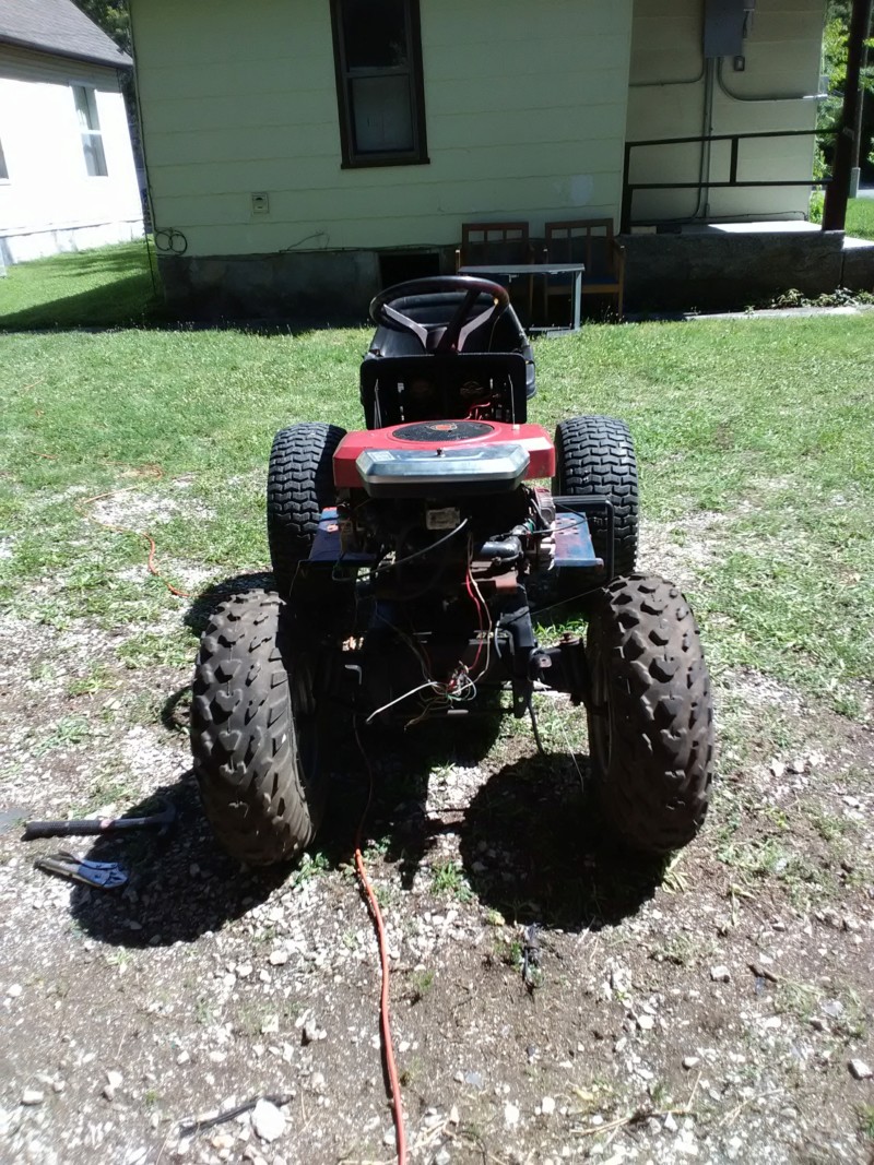

PostSubject: Re: MTD trail build   MTD trail build - Page 3 Icon_minitimeSun Jul 08, 2018 7:46 pm
What I've done today.
MTD trail build - Page 3 20180713
MTD trail build - Page 3 20180714
MTD trail build - Page 3 20180715
MTD trail build - Page 3 20180716
MTD trail build - Page 3 20180717
MTD trail build - Page 3 20180718 put some head tins on, smoothed out the hubs and painted them and put the body back on to see how it looks and get some more ideas. Once I get everything done how I like it then the sheet metal will come back off one last time for paint

PostSubject: Re: MTD trail build   MTD trail build - Page 3 Icon_minitimeSun Jul 08, 2018 7:58 pm
I do like the big front tires, but the chamber looks a little bit out of wack.

PostSubject: Re: MTD trail build   MTD trail build - Page 3 Icon_minitimeSun Jul 08, 2018 8:22 pm
Yeah I know, the one hub got a bit warped when I was dismantling the old 8" rim, ran outa cut off wheels so I ended up using a grinding wheel, chisel and a hammer. Going to try and find some Honda hubs next week
