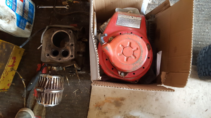

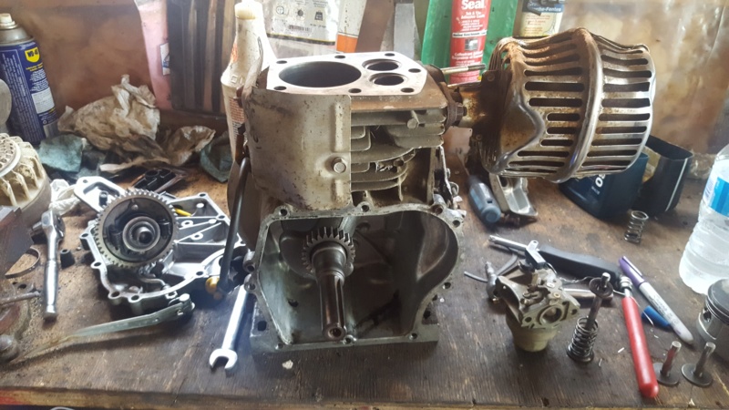

So as some of you know I recently aquired a neat old Honda G200 engine in pieces:
Never worked with one before but this one seems pretty cool so far. Has some pretty cool features like ball bearings for the crank, aluminum cam lobes and gear, governor built into the cam, etc.
It's breaker points ignition with the points, condenser, and coil under the flywheel:
I'm gonna try and rebuild it without buying any new parts as it's in fairly good condition. Might do a couple of performance mods along the way and make into some mild mod go-kart engine or whatever.

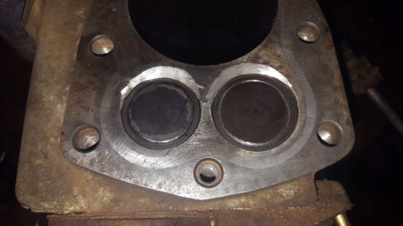

First minor mod I did was shave some material away from between the valves and the cylinder, hopefully to allow for easier flow:
Not sure if it will really help but it sure won't hinder anything, haha.
So I plan to do some more minor stuff like that, should be fun to mess with. Let ne know what ya think!

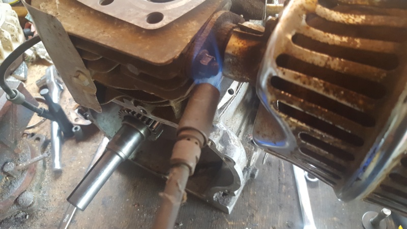

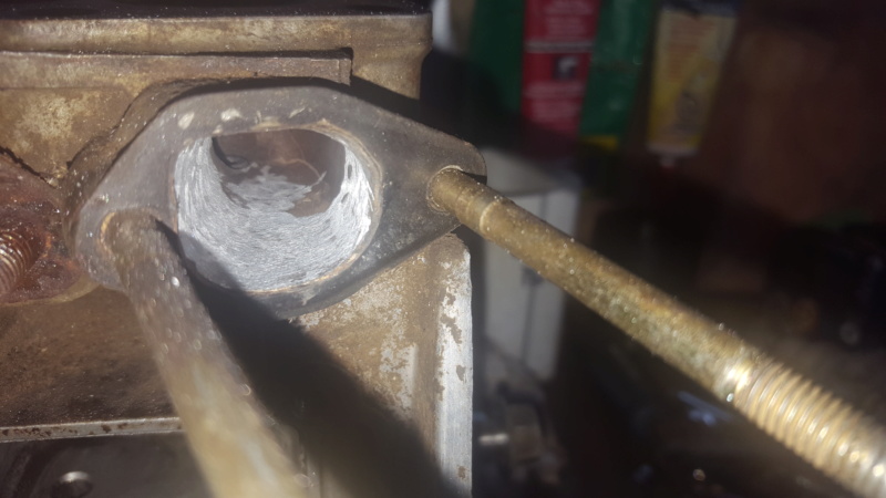

Speaking of which, I was finally able to remove my muffler from the engine today:
Tried some heat on the nut as they were both siezed pretty bad. Not really sure if it helped but I eventually got them both off, haha.
The exhaust port was pretty dirty so I cleaned them both up a bit and did some mild porting:
Should be a bit better.

The exhaust port definitely needed that.

Yeah for sure, definitely glad I was able to get the muffler off to check it. Also now I can make up a cool header pipe! Hahaha.

I see Honda has been preferential to their stud design rather than the Briggs or Kohler bolt or screw design for a long time, that's cool. Does it have a similar carb to a GX160? They're both about the same HP. Pretty neat engine.
Posts : 3992
Forum Rep : 148
PostSubject: Re: Honda G200 Project   Thu Jul 26, 2018 12:32 am
The studs do make it a bit hard to get the die grinder in there though. lol!

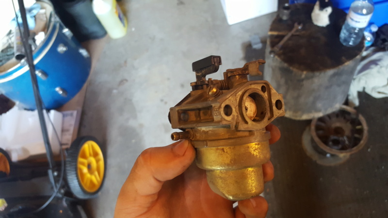

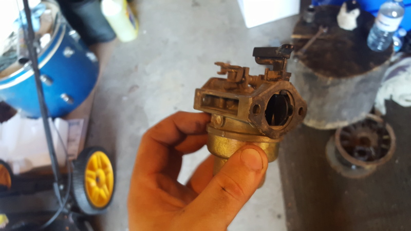

The carb looks similar to the ones on the OHV engines to me, but I don't know my Hondas very well.
The carb:

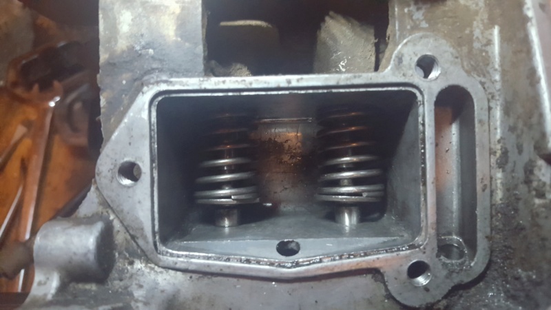

Anyways I got my valve train all put back together, figured I was pretty much done with that part of it:
Valves seem to seat nice and the valve guides are nice and tight, so that's good to know. After that I half assembled it enough to be able to rip the flywheel over and check for spark. There wasn't any, haha. So I'm most likely gonna have to be checking into the coil and condenser. Not too big of a deal, just glad that I checked before I got it all put back together. Haha.

You can take the studs out using vice grips on the shank. The G series carbs are pretty similar to the GX range, the choke and throttle 'levers' are different though.

If you're gonna take those studs out, lock two nuts together on them and use that to turn them out with a wrench. Lot less sketchy than vise grips.
Posts : 3992
Forum Rep : 148
PostSubject: Re: Honda G200 Project   Fri Jul 27, 2018 6:25 pm
Nah I don't have a reason to take them out now. That trick does work good though. That's what I did when I put the head studs in my K321, haha.

I'd probably run a die down those exhaust threads to clean them up. But that is totally up to you!

Yeah that wouldn't be a bad idea. I already attacked them with a wire brush, but a die would really do the job, haha.

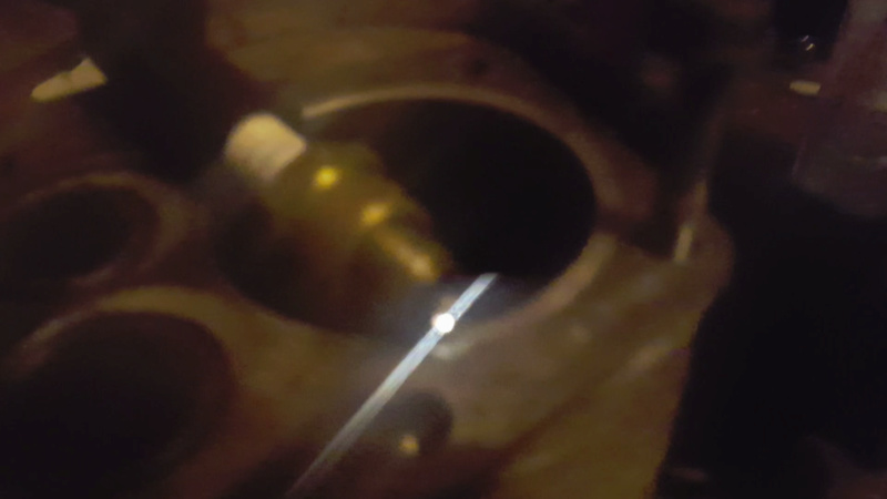

Well I dove back into the ignition setup on the ol Honda tonight, and since I couldn't find anything out of the ordinary I tried a few small things that still didn't fix the no spark issue. Then I gave the points contacts a real good cleaning with a flat file, threw the flywheel back on and ta-da!
A nice bright blue snappy spark! Very happy about that, one less thing stopping me from getting it running, and I didn't even have to buy any new parts! lol!

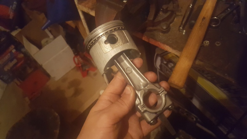

After that I just installed the piston on the rod and called it a night:
Making a little more progress, haha.
