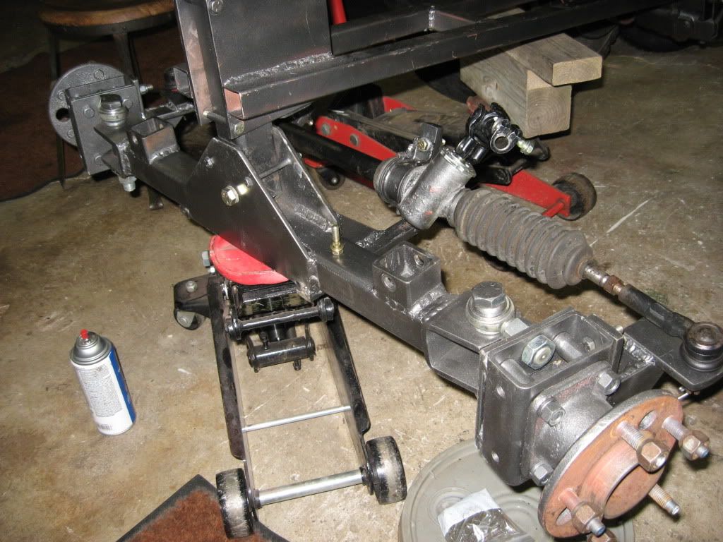

I broke the John Deere steering gearbox i was going to use which was ok because I wanted to use a rack and pinon to start with. Its out of a 1990 Toyota and cost $39.00 at salvage yard.
Technically it should be mounted to the frame and not the axle because the axle pivots. It worked out best on the axle. I will add another steering U-joint on bottom of steering shaft. Hopefully that will take care of the changing dimension between rack and steering column shaft.

holly crap man!!! are you gunna make power steering??? thats sweet! And i love toy suspension idea too. Just make sure that when the tractor articulates that it doesnt interfere with your steering. Maybe add another u joint closer to the top? good luck! and keep the build coming!!
Yea the double u-joint up top didn't work very well. Got a intermediate steering shaft off a Ford. Took the nylon out of it so it slides real easy when the front articulates. Only one u-joint on each end now.
