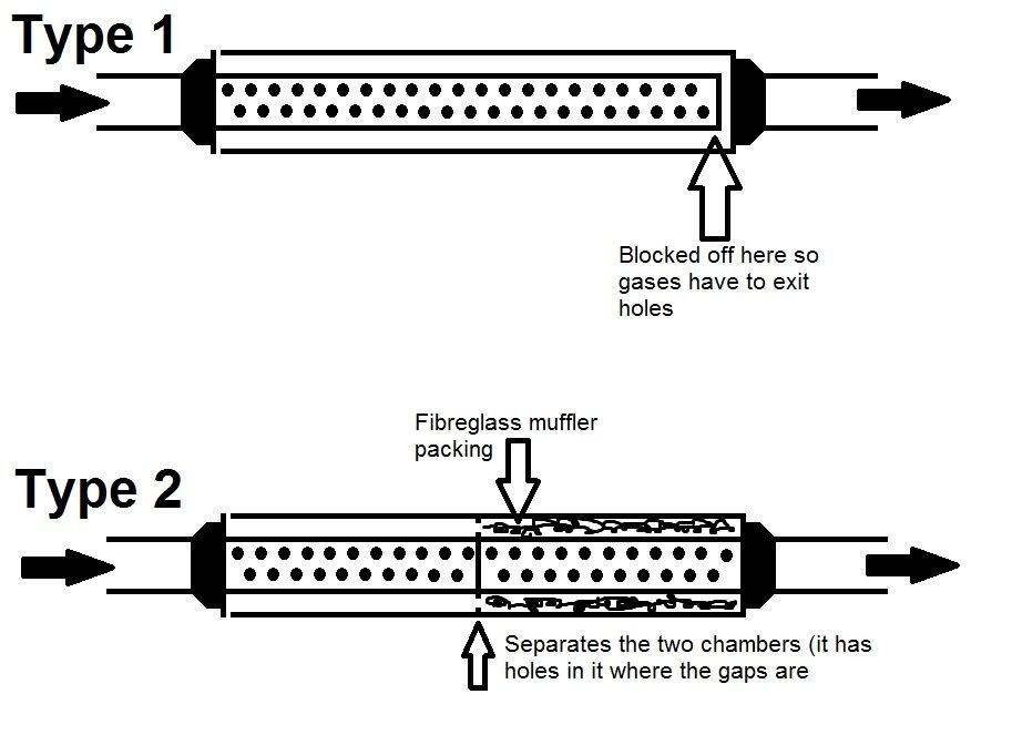

so i got the great idea of trying to build my own muffler aha i got two designs. lets hope we got some muffler gurus here cuz i want the quietest possible. heres a pick of my designs. critisize all u want i need a muffler thats gonna work!

That should work man! should make er pretty quiet. Just make sure not too make it so that theres TOO much back pressure or else you loose power and it may not run right. Maybe try a small car muffler? good luck!

which one do you think is the better choice and i cant use a car muffler because theyre too big it has to be quite small haha

Packing with the exhaust fiber will make it quieter than without.

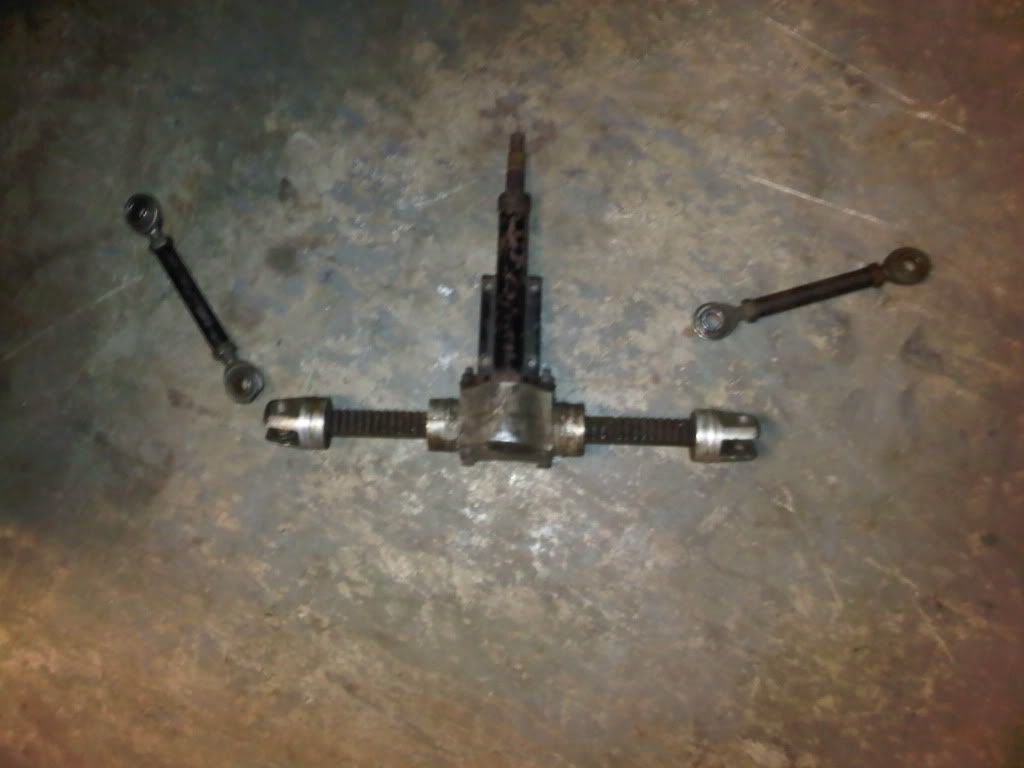

winters comin in the great north so we took them to my buddys little garage so we can weld and build these things in warmth. (hes got a wood stove)

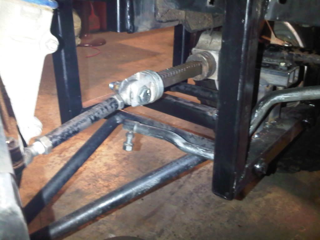

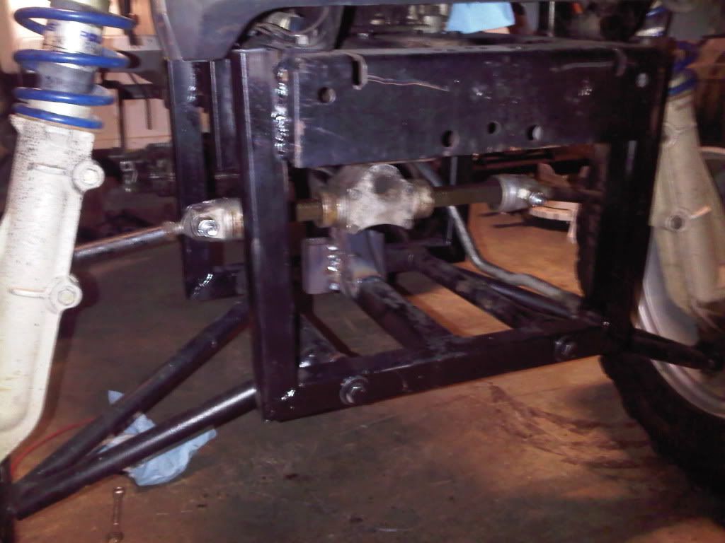

couldnt believe it but my buddy scored 2 rack an pinions off a guy, YES
mounted that rack and pinion in there

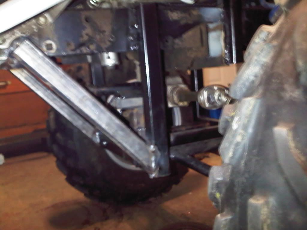

another view

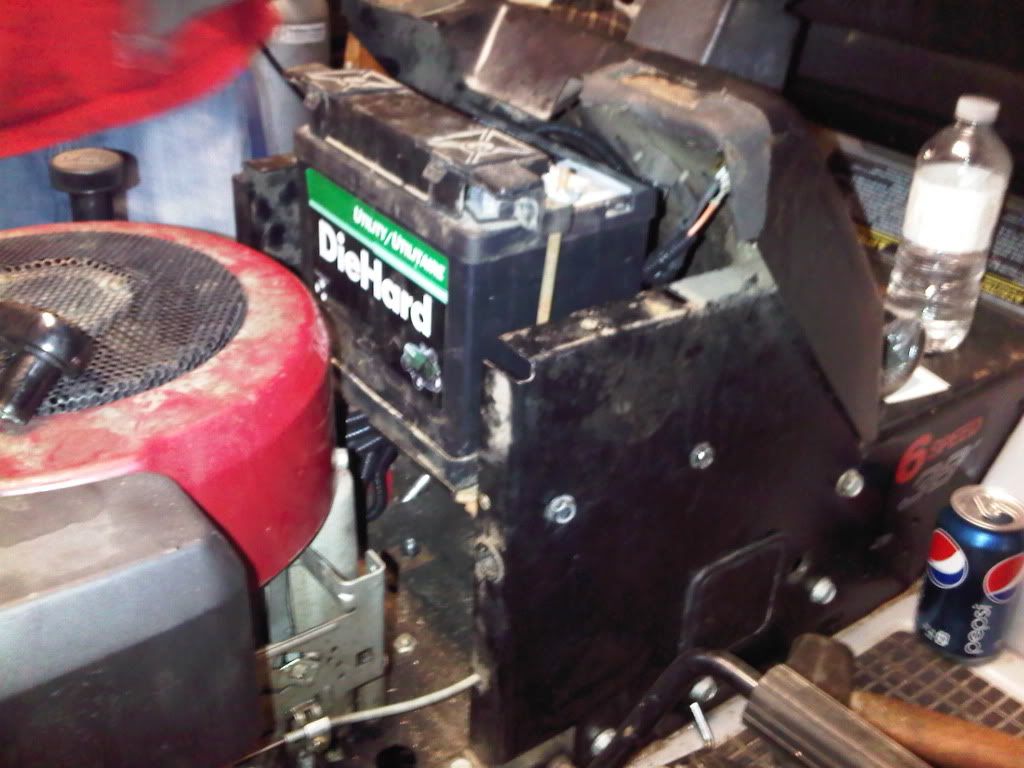

did my front mount battery relocation! looks factory! im very impressed by it

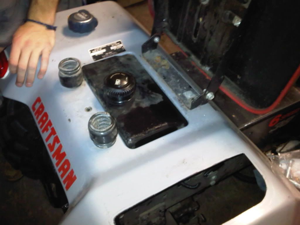

did the gas tank relocation too! fit liek a glove in there couldnt believe it

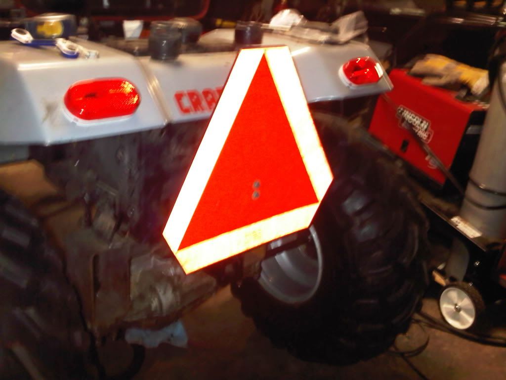

gettin road legal
drop bracket support bars
transmission support brackets
arild365
Join date : 2010-02-11
Posts : 320
Location : Canada, BC
PostSubject: Re: My Tractor Build   Sun Nov 13, 2011 10:28 pm
WOOT!!! Yah man! shes looking real good!! i think this is the only current in progress build right now Razz Cant believe your buddy scored those tho you lucky b*sterd!! Razz soo jelous. Did he say what there off of? id like to try to find a set up like that! looks pretty stong. Sooo...whats left? just bout time fer a test drive?? Very Happy is that still the stock pulley on the back? planning on changing that?
keep us posted! thanks fer the pics!

thanks man! and yea i couldnt believe he got them either, and they were off of go karts he was pretty surprised wen we told him theyre going on lawnmowers. and yea its super strong thats y i like it Smile and whats left? hmm i gotta get my steering shaft done and my exhaust stack, which im doin friday, and hook up my brakes! then im done that'll get her goin! for other stuff i wanna build a front bumper and what not but shes so close. im aimin to get it done next weekend so i can have her in the parade on the 3rd

Im not sure how the local authorites would consider that road legal - lawntractors down here in the states arent legal for road use , altho people have driven them short distances from yard to yard ( to mow) - i was pulled over on my mod 94 murray by a sheriff a few years back , just taking a spin down the street- he didnt give me a ticket, he was just curious about the tractor .
ATV's are 'street legal' down here in Florida - only on dirt roads/side roads up to 40mph if theyre liscenced and insured - up north its manditiory for both, but arent street legal at all.
I know golf karts can be made street legal up in Canada with certain changes, they also sell street legal golf karts here as well.
Just be ready for a ticket....
The tractor is comming along pretty cool - the steering setup should work good , almost ready for a first run- i like the cleaness of the build, looks like craftsman almost factory built it.

i cant say im 100% sure im gonna ask a cop to be 100% but ive gone thru the highway traffic act of ontario for agricultural vehicles and lawn mowers r actually considered tractors and it can be counted road legal agricultural equipment. the vehicle just has to be on 4 wheels, go under 40 km/h, and display a SMV sign, also needs front aqnd rear lights if traveling in the dark. and if the cops gets techinical he can bust out the "you have to be traveling to a farm or home" i can either say im going to my buddies farm or im coming home from it. and here in ontario ATV's r only street legal when the lake is frozen any other time no way ur getting a ticket.

She's coming along good !! I like that steering rack that is awesome! Do you have a fuel pump to run the tank under the seat? Or is it high enough for gravity to work??

im gonna have to run a fuel pump. i went on ebay and ordered the oil breather cover that has an extra threaded hole for a pulse tube fitting. that way i dont have to drill into my block to get a pulse i just swap the covers and thread a fitting into the hole. and for a pump im just gonna use one out of a ski-doo safari lol
