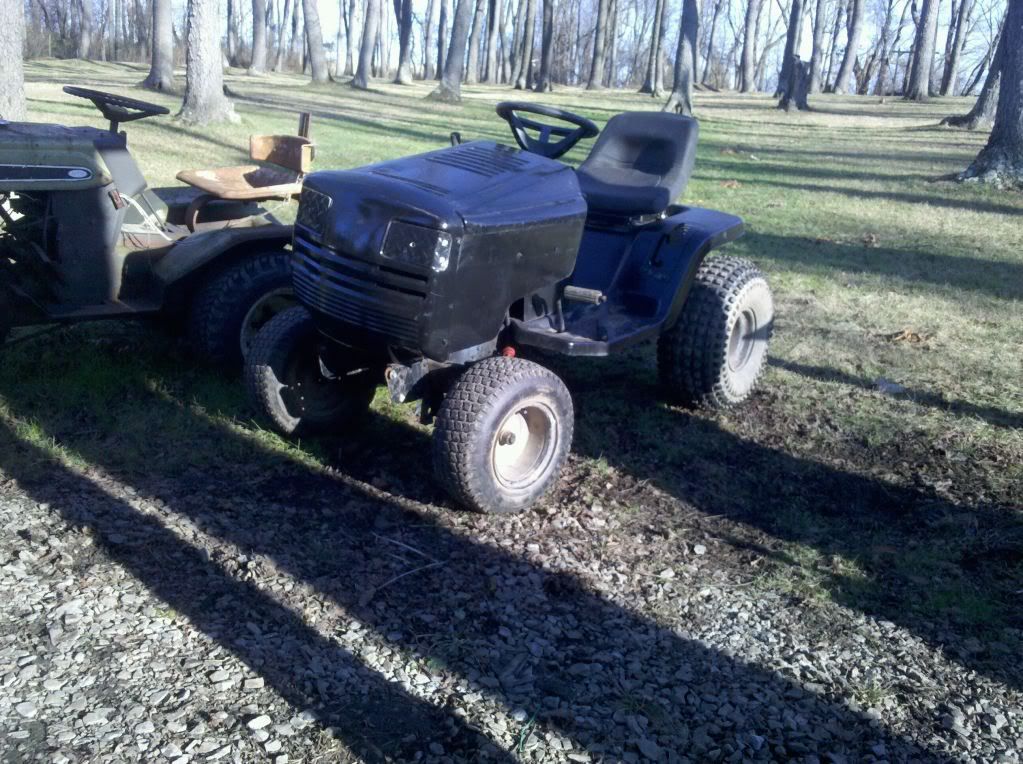

I did a little work today, (until i slipped and fell down my shed stairs, and decided to call it quits for the day). Since i didn't get to much done, I did brainstorm some idea's. I have one current question that i would like to hear some opinions on. Should i try to find a governor plate ( or make one off another engine work) for the 15.5 engine that is currently in the tractor. Or should i try to find another engine ( probably a flat head 10,11,12, or 12.5 hp). comment what you think..
before i fell, i took some pictures of the murray with the stock hood, and with the mtd hood and grille. (note the hoods are only sitting on the tractor, they are NOT bolted on at all). I like the mtd hood much better.
Stock Murray hood
MTD hood and grille
Which one do you like?? Comment!
