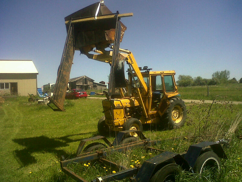

A couple of years ago, I started building my own 4x6' utility trailer. I got the frame and axle done- and no further- too many projects.
Last year, a relative gave me a 4x8' trailer with a drop-down loading ramp that was rusting out pretty badly. I thunk to myself, "Self, what if you extend that homebuilt frame another 2 feet, and used the sides and ramp from the rusty hulk?"
So, today, I set to surgically removing the body from the frame: that's the weird part- the body panels have a bit of surface rust but no perforation. The frame was rotted so badly that when I lifted the body off (after much grinder work) the frame literally collapsed to the ground! I'll include some pics of before I started (being hauled by the trusty UTLTV I have named the MULE*), with the rotten wooden floor out, the body held up high by the trusty 535, and the frame carnage.

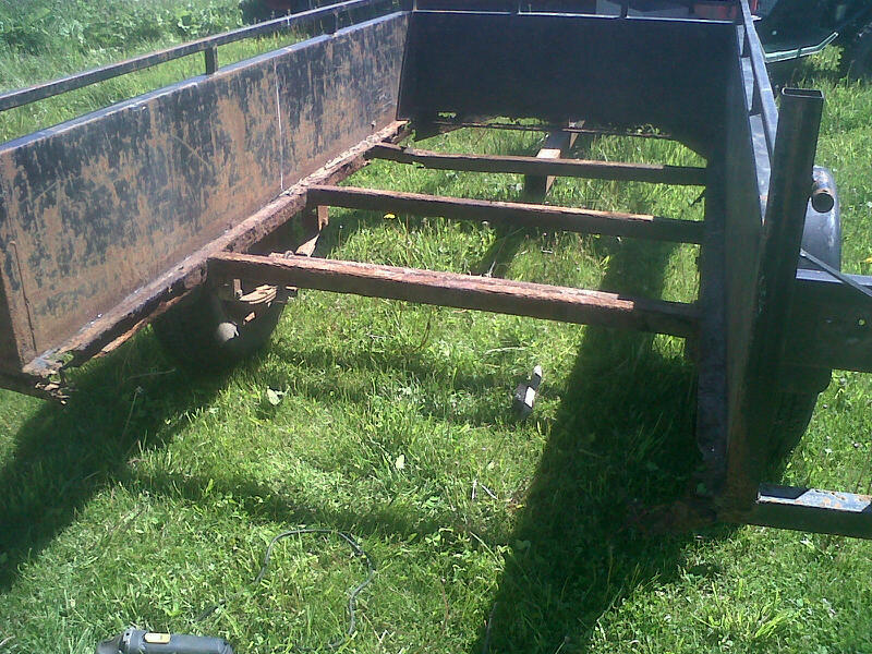

I totally fluked out on the width. I build my frame to 50" wide overall, so that by the time I built the wall framing out of 1" SHS, I'd still have 48" inside to carry building materials. This box is exactly 50 " wide!
Basically, I need to extend the frame another 24", and then relocate the spring hangars to center the axle in the wheelwell. Then I get to address the finer points of what will make this my own.

Aside from some surface rust, the axle and suspension are still very good. I am replacing the U-bolts (so I will feel better...LOL) and probably the leaf spring bushings. I will clean and examine the wheel bearings, but they feel good.
The main part of the tongue (3" square) is good, but the two side struts that come off it and brace to the corners of the box were bad. I may re-use the 3" tongue section, I'm undecided.
The trailer will be street legal, and used for hauling anything and everything. Our go karts and tractors will go on it, as well as for dragging projects home. I will also use it to haul plywood, drywall, and other materials to job sites. In addition, I am thinking about how to make a removable upper deck- kinda like a double-decker, for if I want to haul more than one wheeled toy at a time. I could have a go kart on the main floor, and then my son's kart up top, for example.
Tonight, I extended the length from 6' to 8', and added on a replacement rear member at the same dimensions as the original. I have not yet relocated the suspension mounts. Fortunately, they were only tacked on in the first place.

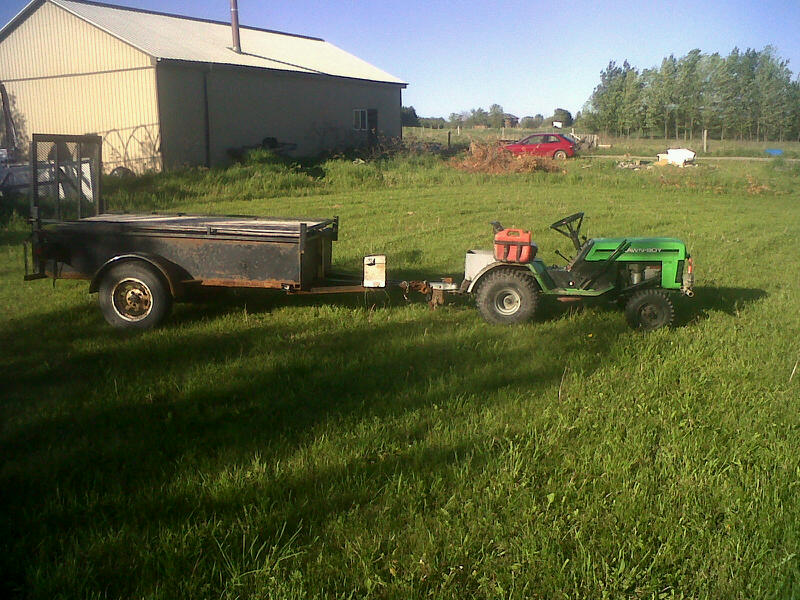

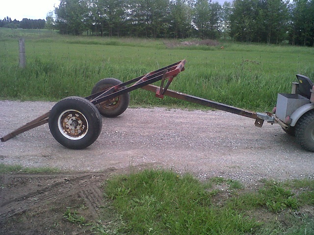

Today was a good day. It was supposed to rain all day, and didn't. Got some good work done...
I took apart all the suspension components and relocated the axle according to the wheelwells on the box. I got new U-bolts to tie the axle to the spring packs, new bushings, and new hangars and shackles (bushings, hangars and shackles were NOS from my original trailer build plans. U-Bolts brand new).
Did the ol' hack and whack to recover the beefy 3" tongue from the "tetanus trailer" and reconfigured the tilt mechanism I'd cooked up to suit. Some detail on that-
I wanted a tilt trailer, but didn't want an uncontrolled tilt, where you had to break your back heaving it up, or gravity slamming it down hard. Didn't want the cost, complexity, or weight of electric, pneumatic, or hydraulic.
Used a bottle jack from an old Toyota pickup truck and built mounts and pivots from what I had. Seems to work very well, and there's enough stroke on the jack to put the back bumper of the trailer on the ground. Simple, light, goofproof, and requires no power. The crank handle you see is entirely temporary. I will figure out something better, later.

Wow! That's a very cool design. Those yota jacks are great for the telescoping, and the tilt looks great! Its such a great idea haha, really I woulda never thought.
