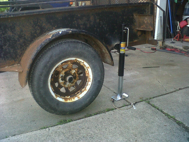

A bit of progress for today. I began by cutting two 2 1/4" lengths of 1 1/2" Sch40 gas pipe, and welding one to each side of the frame behind the wheel. Using the ring-mount tongue jack, I can service the bearings or change the tire at the side o' the road without digging through my vehicle for the crappy factory scissor jack...

Utility Trailer Rebuild - Page 2 Jack10

Thats a great idea. I probably never would have thought of that. Now you wont have to remove the ramps if you dump.
