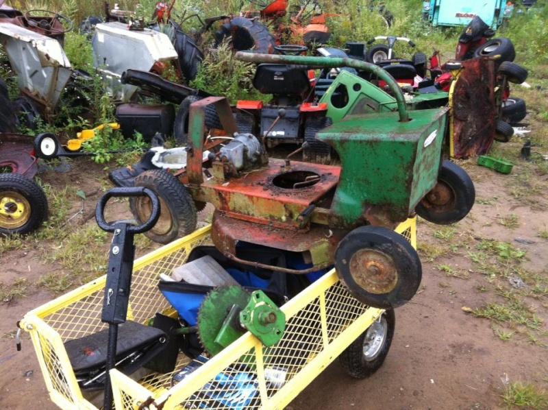

Ive been crating some buzz bout it. Ever sence the mtd build I told myself I wanted to make a speed mower. Well after catching my eye in the junkyard in summer it stayed around enough for me to get.
When I found it:
60's springfeild mini tractor speed mower.  48797211
60's springfeild mini tractor speed mower.  12366512

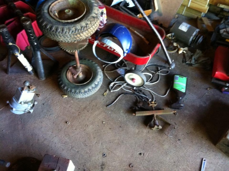

What I left with today. I pulled the stock engine, it was seized and I shure as h*** wasn't going to use it. (twin coming soon)
60's springfeild mini tractor speed mower.  12347_10
60's springfeild mini tractor speed mower.  94217410
What I left with was a john deere r72 rear chain driven axle + hubs, and a peerless 700 series transmission.

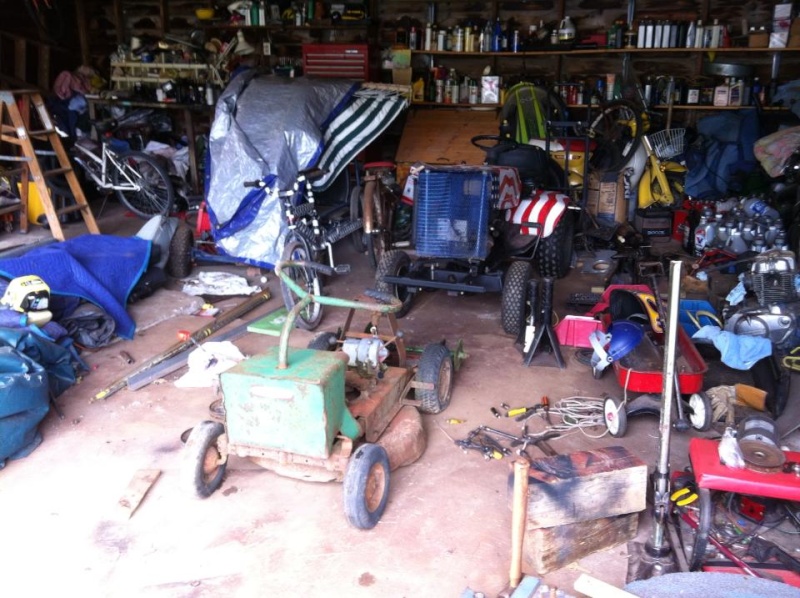

When I got home I took some over view pictures.
60's springfeild mini tractor speed mower.  99682910
Big brother in the back round

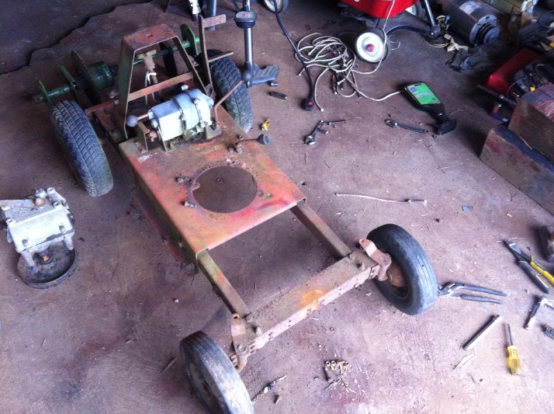

Tearing into it.
60's springfeild mini tractor speed mower.  11872011
Then it decided to do the chevy.
60's springfeild mini tractor speed mower.  52172310
60's springfeild mini tractor speed mower.  12551510
Seized steering.
60's springfeild mini tractor speed mower.  11860710
Heres the way the belt went. im going to reuse the stock clutch arm, add springs linkages and get a new flat pully.
60's springfeild mini tractor speed mower.  12340510
Every thing is kinda rusty some pitting but there isn't much on here that im keeping.

More progress.
Holesaw'd the pully to pull the tranny. Its for sale.
60's springfeild mini tractor speed mower.  13748910
60's springfeild mini tractor speed mower.  57866910
Switching sprocket sides
60's springfeild mini tractor speed mower.  13765210
60's springfeild mini tractor speed mower.  12349810
One bolt was already broken, two broke when I took them out, and one came out good. im in seach of new bolts now lol.
Speaking of axles, I pulled the old one. One word, rusty.

hey red, what is that motorcycle in the back in that last pic? :Dim curious
Good eye riche! I believe its a Honda c70 or something along the lines
60's springfeild mini tractor speed mower.  Screen17
Join date : 2011-08-04
Points : 6041
Posts : 1434
60's springfeild mini tractor speed mower.  Empty
PostSubject: Re: 60's springfeild mini tractor speed mower.    60's springfeild mini tractor speed mower.  Icon_minitimeOctober 1st 2013, 9:53 pm
nice, can you get some pics of it? i like the honda motorcycles lol
Points : 7122
PostSubject: Re: 60's springfeild mini tractor speed mower.    60's springfeild mini tractor speed mower.  Icon_minitimeOctober 1st 2013, 9:54 pm
Its just a moped, I guess. just a lot of stuff round it.
