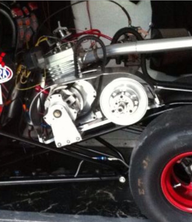

Speedfreek241
Speedfreek241
Join date : 2013-07-12
Points : 3970
Posts : 137
Location : Loxahatchee
craftsman drag race mower - Page 3 Empty
PostSubject: Re: craftsman drag race mower   craftsman drag race mower - Page 3 Icon_minitimeNovember 22nd 2013, 10:13 am
I'll upload pics when I get home it's practically the same clutch that's on a snowmobile.
1st Place Build-Off 2016
Age : 50
Points : 6959
Posts : 2914
PostSubject: Re: craftsman drag race mower   craftsman drag race mower - Page 3 Icon_minitimeNovember 22nd 2013, 10:53 am
Ahhh. That's a CVT.

PostSubject: Re: craftsman drag race mower   craftsman drag race mower - Page 3 Icon_minitimeNovember 22nd 2013, 9:11 pm
craftsman drag race mower - Page 3 Image29
This is the clutch that's on my car now the one I might use on the mower is the same but doesn't have an overdrive.
