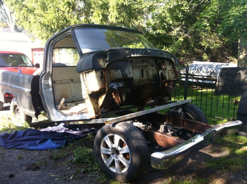

| Update. Been busy on this and school, bleh. Joined fordification.com but they want me to upload photos to a host and then upload them to the forum. what a hassle. Havnt started a thread unless theres a easier way. sub frame for cab removal, pain.   Vic suspension almost done, just gotta box the frame.  Box off.  Rusty!  Spending a lot of time with the grinder, 16ga sheet, and the hobart mig. Floor pan got cut out.   And traded my 6.0 gm motor for 18" v6 mustang GT rims. Mmmmmm. Cousin works at a high end auto detailing shop.  And IRS is in the future | |

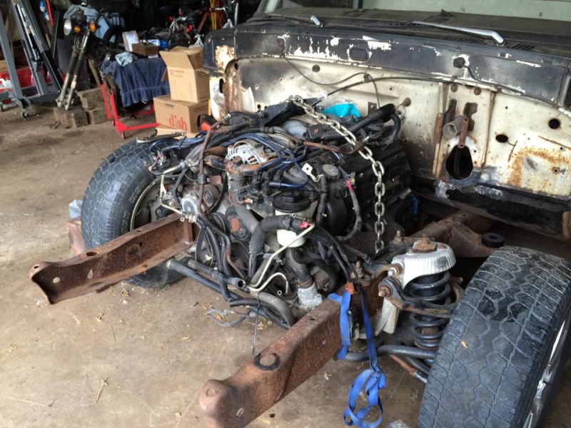

| Almost one year bump on this thread. Figured id update. Thunderbird Super Soupe 8.8 IRS. 28 spline, trac lok, 2:73s  Lincoln Mark 8 aluminum diff/control arms. 3:73s.  4:10s from a explorer 8.8. Complete rear end rebuild, and thanks to 98svtcobra Carbon fiber trac lok clutch packs!  IRS mounting material (still laying in the garage  )  New engine and trans from a lincoln mark 8. 4.6 32v DOHC, 96K miles, 4r70w (overdrive yee), and complete wiring harness with it.   Cab just needs new cab mounts welded in but need the cab on straight so i dont weld them on wrong.  Rolled it all inside.  Swooped in and got parts from a junkyard truck that showed up.   Motor mounts bolted on (from a 03 vic and up-bolts right to any mod motor basically) and the engine just laying in there. frame needs plating and rear trans mount made.  | |

| Hay Kid, Coming along nicely. So switching from the original motor to the 32v 4.6 with fuel injection, WOW, major change there, I think those motors are rated at 400hp stock. Curios on how you are going to seal the bottom of the cab? I sure can tell you what doesn't work, LOL. I did the same thing to my jeep on cleaning and prepping. Believe it or not, my jeep was solid and little rust when I got it. Did all the body work also. Now 15 years later it all rusted out, but then again it's a daily driver even in the winter time. I did my wife's car also when she got it almost 10 years ago, using a different method on rust proofing. Here car is holding up pretty good. I usually run my vehicles till I can't and are ready for the scrap yard. I hauled away 2 cars to the scrap yard in my jeep by cutting them up, LOL.
Well anywho... On my jeep after I prepped I used roofing tar over the paint, didn't work too good. Then I tried that spray on bed liner from a rattle can, that crap don't work too good. At that point I'm cutting out the floor for fresh metal and used the paint on bed liner, didn't work too good either. So I sand blasted the metal, that sucked, and used the paint on bed liner on the raw metal. The sand blasting gave it something to grab good, worked longer then I expected but it rusted through and came off. My wife's car on the other hand, is still solid underneath with the coating still on. On her car, I kept it simple since it was rust free when she got it. I used an SOS pad to clean the underneath, the the paint on bed liner. No rust holes or spots on the floor pans with rust. I'm thinking that a real good primer/sealer will do the trick with the enamel paint, then the paint on bed liner. I'll be doing that to my next jeep I build up. It's the gold one in my tank vids, that will replace my current one. I'm thinking an epoxy marine paint for the primer or maybe an aircraft epoxy paint. Well hope it helps. | |
