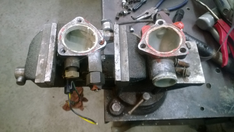

 | Subject: Re: The Millennium Falcon Tue Apr 14, 2015 6:09 am | |
| Woo, more parts!  Including the most important part of em all, the spacers. Getting them apart was a bit difficult, quality tool probs. All of my sockets, even the non impact ones, were too thick walled to fit in the hole. Thankfully I have neighbors that buy cheap tools.  Lookin decent.  Little bit of poke now, but at least they clear the calipers  _______________________________________________ - Quote :
