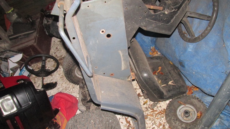

Here is the pile of parts...................
the Honda GX160, story is i got it from a engine repair shop. traded a $80 chain saw for it, was pressure washer, pump blew, ceased on shaft, cut off, need new crank.
Honda MTD Build (HMTD) Img_0610
Honda MTD Build (HMTD) Img_0615

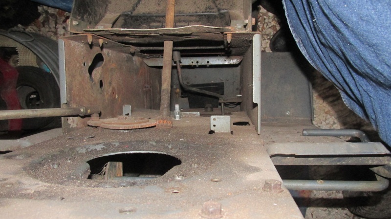

the MTD frame, here ether cut out recess and weld on new top plate, or make a elevated mount and new plate for the engine to mount with the recoil facing front, then a pulley on the crank, and on the soon to be drive shaft mounted on the right hand side from sitting on the tractor......
Honda MTD Build (HMTD) Img_0612
then here is where the rear diff shifter come out and the trany is mounted about here....... (ment to be IN the crotch hole in front of the seat)
Honda MTD Build (HMTD) Img_0613
then, i will turn the diff (the single speed tranny) so that the input shaft is parallel with the frame......
Honda MTD Build (HMTD) Img_0614
the whole drive train will be on the iner left side (from this view), while the engine on the right......
Honda MTD Build (HMTD) Img_0520
thats the whole idea, still thinkin on the brkes, would NEED dual brakes on each wheel, cuz the diff is staying open, clutch linkage will be fun.
