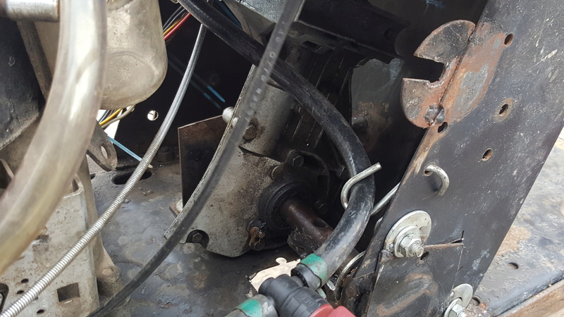

Well I found the weak link in my steering today when I tried to go for a romp.
MTD off-road build (Mobile Terrain Dominator) "1" - Page 20 20170810
MTD off-road build (Mobile Terrain Dominator) "1" - Page 20 20170811
Yup, the pitman arm sleeve. Hit the front wheels up against a tree and I heard a crack. Luckily it wasnt the box or anything, so I wasnt as upset as I thought I was gonna be. I got the box out tonight so I can weld it all back up tomorrow morning.
MTD off-road build (Mobile Terrain Dominator) "1" - Page 20 20170812
I'm probably gonna open it up as well just to see what shape it's in. Hopefully I'll get pics of all that tomorrow!

Yeah, I was thinking that wasn't as skookum as it should be. Maybe you could do something out of a lock collar or two? That'd be a lot stronger, plus easier to remove if need be

Yeah, we just happened to break basically the same part on our tractors today too hahaha. Weird, anyway I probably should have made something a bit heavier to begin with, but I suppose this is a chance to make it better.
