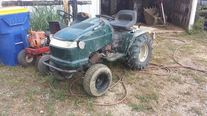

| Guess I'll start a build thread on Mutt, my GT3000 I aquired in August. Briggs 18HP Opposed twin, Peerless 820. Mods/additions/swaps so far: -5" to 5" pulley swap -Steering out of a Snapper LT16 (because it was adjustable/tightenable/not so horrible) -26x10-12 Kenda Executioners -3 lug front hubs made from a Snapper LT16 trans -18x6.50-8 Armstong turf fronts, might groove them because there is a lot of tread there -Pull start -40ci heads (on a 42ci block) -16HP main jet/bottom half of carb (stock one was stuck in original carb and got screwed up) -Turned the air box around, now a coldish air intake -Extra clutch spring -Walmart LED headlights (along with stock ones) -Custom Gas+brake pedal -Rear rack made out of Snapper LT16 frame and Hitch -Custom front axle in progress -Crappy looking decent sounding dual exhausts -Snowplow mounts/48" Snowplow -Mirror on left side (so I can watch everybody eating my rooster tails lol) -Dual Batteries -Stainless Steel ball shifter knob In the future I am hoping to Doc-lock the 820 and get some Carlisle Snow Hog fronts

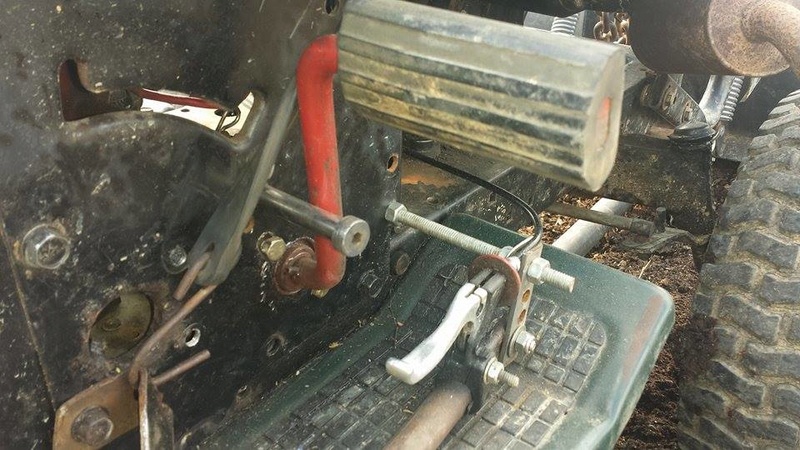

| Btw, the bike brake gas pedal is now removed and replaced by this which is like 1500X better  | |

| Looks good. Is that the brake right above the gas?  Head Forum Administrator ** Chat Moderator ** Facebook Page AdminATLTF Facebook Page ** Chatbox ** How To Upload Pictures

| Yes, when locked down (it locks itself down due to return spring placement/cams over) It helps me remember to pop the brake back when I have it down, you'd have to use the tip of your boot to hit the gas with the brake locked. I always forgot to pop it back with the bike gas pedal, and the oppy didn't give a crap whether it was on or not, she'll just take right off | |

| Nice Craftsman man! That's cool that it has an 820. What's that tractor in the beside the GT in the first pic with the 3hp Briggs? | |

| Cool! It's got some pretty good articulation on the front end. I think you may need to support those exhausts on your Mutt. They might put stress on the block if anything fell or hit them. | |
