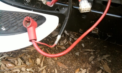

Ive removed my wiring and I dont know how to wire it back up. Photo016
i have what i think is the charge wire going to the other side of the dash(red) .... yea im lucky i managed to have enuf room under the dash for the battery:) it was under the seat but when i lowered the back i didnt have room for it there

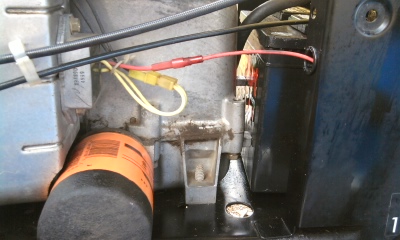

Ive removed my wiring and I dont know how to wire it back up. Photo017
then the charge wires goes into this bigger wire that is connected to the battery under the dash
