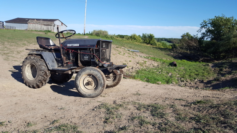

Nothing new with the ol' GT lately, just been doing a lot of off-roading with 'er and loving the new steering, haha.
Craftsman GT 6000 Build - Page 20 20180758
Craftsman GT 6000 Build - Page 20 20180759
Craftsman GT 6000 Build - Page 20 20180760
Haven't had anything go wrong with the rack setup, and I've been putting it through it's paces for sure, so hopefully that means it's all sturdy enough, haha. Think I'll maybe get some bumpstops rigged up for the axle next.

Looking good!

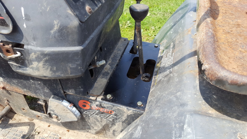

I decided to finally modify the factory shifter plate so I could put it back in place.
Cut out the slot for the range selector and did some welding and grinding to clean it up a bit:
Craftsman GT 6000 Build - Page 20 20180827
Craftsman GT 6000 Build - Page 20 20180828
Painted up:
Craftsman GT 6000 Build - Page 20 20180829
Doesn't look too bad!
I also covered up the old range selector hole with some sheet metal while I was at it:
Craftsman GT 6000 Build - Page 20 20180830
Craftsman GT 6000 Build - Page 20 20180831
Craftsman GT 6000 Build - Page 20 20180832
Not too bad, looks better than before. Haha.

Nice update.  Good to see you doing some body work instead of suspension work. lol!
I like the shifter plate.

Looking good AK, nice touch on the shifter plate.

Thanks Mighty! Yeah the shifter plate turned out kinda neat looking in my opinion, haha.

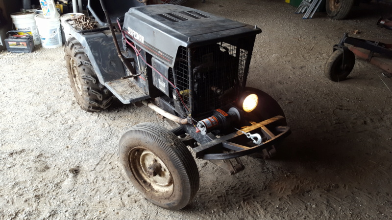

Had the GT out and about today for the first time in a little bit. I was planning on tearing the front end out and painting everything up, but it ended up being kinda chilly outside so I figured I'd save that for another day.

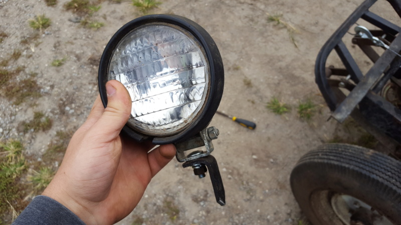

What I did instead was mount a work light to the front of it so I could finally get some night vision on this rig.
The light has a rubber housing which is cracked but I planned on fixing it just so the bulb wouldn't be loose in there.
Craftsman GT 6000 Build - Page 20 20180952
Welded the little bracket to the bumper frame in what seemed like the best spot:
Craftsman GT 6000 Build - Page 20 20180953
Ran the power wire up along the grille support and down to the factory light switch:
Craftsman GT 6000 Build - Page 20 20180954
Works good!

I just drilled a coulpe holes on either side of the crak in the housing and ran a zip tie through and snugged it up. Seemed to fix it pretty well. Nice to finally have some light though, now I can do some sweet night time wheeling!
Craftsman GT 6000 Build - Page 20 20180957
Haha. Let me know what ya think!

nice... that will be useful now that it is getting dark earlier.

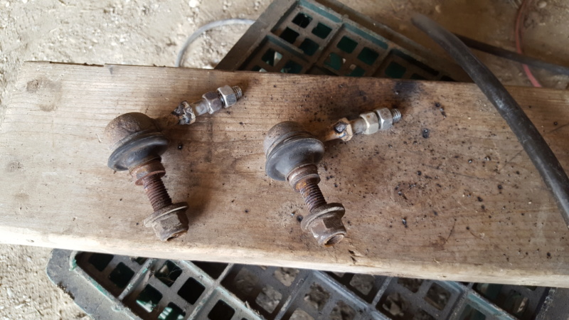

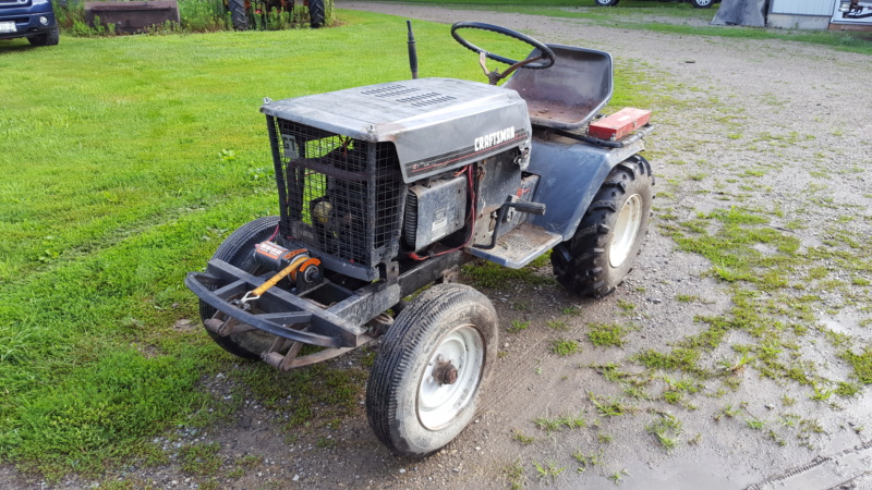

Did some messing around with the GT this weekend and had to pull a Rich:
Craftsman GT 6000 Build - Page 20 20181028
That was fun. Although I broke a weld on my tie rod on the way back down. lol! Figured it was probably time for a new one.
Got some ends made up:
Craftsman GT 6000 Build - Page 20 20181029
Then used some 1/2" or so O.D. pipe to made the tie rod:
Craftsman GT 6000 Build - Page 20 20181032
Turned out pretty nice!
Craftsman GT 6000 Build - Page 20 20181030
Might try and make a skidplate for the front axle sometime, to protect the tie-rod and steering rack. Shouldn't be too hard to fab something up.
Did a little bit of work with it too afterwards pulling my little homemade scraper thing.
Craftsman GT 6000 Build - Page 20 20181031
Still working good, haha. Let me know what ya think!

Home made scraper thing...  LOL
Do you really need the tie rod with the rack and pinion?  ...Or you just using it as a sway bar at this point?

Yeah I definitely need the tie-rod, haha. My steering rack is setup lile redline's was, with only one rod coming off of the rack going to a steering arm.

I like how you welded the bolts onto those automotive style rod ends to adapt them for use on a tractor.

Thanks Carl! Yeah I always liked using that type of rod end on my rigs, as I'm sure you all know. lol!

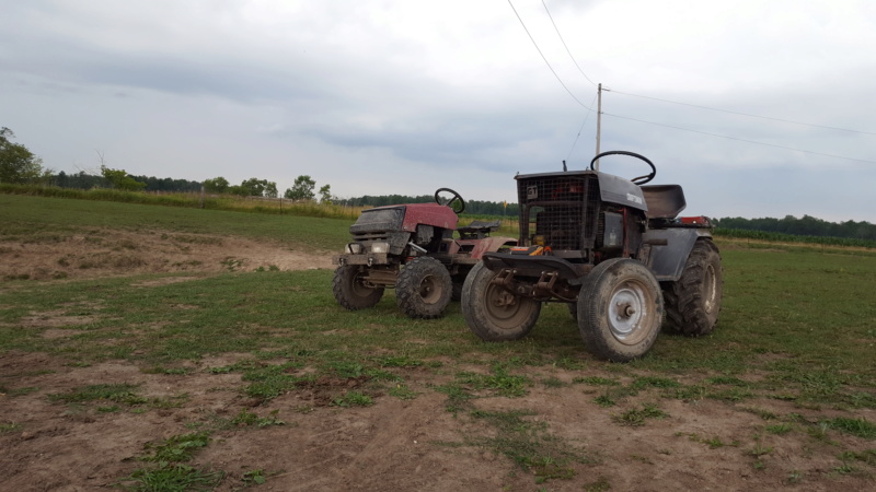

Got a bit stuck this weekend:
Craftsman GT 6000 Build - Page 20 20181110
Craftsman GT 6000 Build - Page 20 20181111
Doesn't look so bad in the pictures I guess, but she was stuck for sure. You can see the B-110 was there in an attempt to tow the GT out, but that didn't work. Even with my brother driving the GT and me pulling with the B-110 at the same time, hahaha.
Finally got some extra help and got the ol' girl freed though:
Craftsman GT 6000 Build - Page 20 20181112
Haha, that was fun. Definitely need to pick up a fairlead though. I couldn't really winch myself out because there was nothing directly ahead of me. I'll probably pick one up here sometime and see if I can make a mount for it.
Got some other ideas too so hopefully I can do some improvments here sometime soon!

Had the GT out doing a bit of off-roading this weekend.
Craftsman GT 6000 Build - Page 20 20181141
Afterwards I decided to go underneath and check over the steering and suspension as it's seen quite a few hours off-road without any inspection of that stuff.
Craftsman GT 6000 Build - Page 20 20181142
A few nuts loose in a couple spots, but not too bad. The main thing I noticed was with my upper universal:
Craftsman GT 6000 Build - Page 20 20181143
The shaft going into the universal isn't being clamped by the pinch bolt very well and is quite loose. I cut the square into the shaft myself when I did the rack setup so I probably just cut it a bit too small. I'll probably just do a few tack welds on one side of the square and grind it smooth again so it clamps in there better. That should fix it.
Pretty glad I noticed it, haha. Other than that she's doing good!
