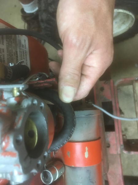

I’m still having some fuel delivery issues. A couple times it sounded like it was running out of gas.  I need to check the vent on the gas cap and reroute the fuel line going to the fuel pump.  It’s almost completely kinked so I’m sure that’s hindering the pumps effectiveness.

Those pics are definitely summer shot worthy. Sounds like your tank isn't venting properly, and the kinked fuel line will hinder fuel flow. Check the tank vent and sort out the kinked fuel line and that should fix your fuel problems. That cam lobe operated fuel pump is awesome, never came across one like that before.

So I still have to test her out but I did a couple of things that should fix my fuel problem.
I couldn't see the vent hole in the craftsman cap I'm using so I drilled a couple of 1/16 holes where the vent should be to make certain it vents.
“Ol’ Red” 1979 Wheel Horse C-81 - Page 11 Img_2316
I removed the air cleaner to gain better access to the kinked fuel line.
“Ol’ Red” 1979 Wheel Horse C-81 - Page 11 Img_2315
My favorite parts stores were closed on Sunday and the other stores I checked didn't have a 1/4x1/4 barbed elbow approved for gas that I was going to use to get rid of the kink.  So I hunted around my shop a little bit and found some Gates brand fuel line that could make a tighter radius without kinking so I installed that and it doesn't look kinked or flattened.  This is just how the original fuel line looked.
