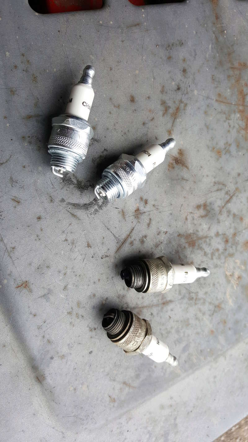

Nothing really new with the MTD, still working good.
I did out a new pair of plugs in the engine today, figured she could use a new set.
MTD off-road build (Mobile Terrain Dominator) "2" - Page 9 20180469
Definitely seems to be running better, then it ran outta fuel. Go figure, haha.
MTD off-road build (Mobile Terrain Dominator) "2" - Page 9 20180470
Had some fun for a little while before she ran out though, haha, so I guess that's good.

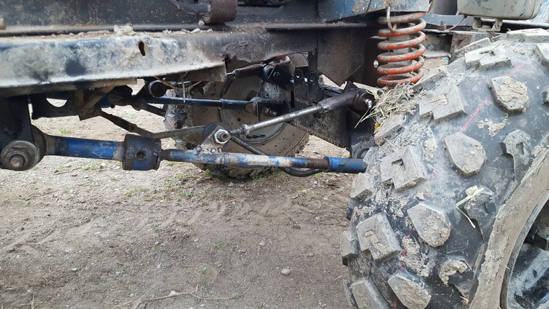

Well been a while since this thing's been running. The misfire actually turned out to be a bad coil, but a new one finally got ordered and should be here in a couple weeks.
Meanwhile, I decided to drop the 3-link suspension in favour of a new setup. The plan was for a long arm/radius arm setup to take its place, something like this:
MTD off-road build (Mobile Terrain Dominator) "2" - Page 9 The_be10
The idea was to scrap my center link and just modify my outer links to make them into radius arms.
Starting to dissassemble:
MTD off-road build (Mobile Terrain Dominator) "2" - Page 9 20180610
Skinned the front axle with some sheet metal to cover up all the stupid looking holes from the axle pivot and stuff.
MTD off-road build (Mobile Terrain Dominator) "2" - Page 9 20180611
MTD off-road build (Mobile Terrain Dominator) "2" - Page 9 20180612
Looks much better!
Then lots of figuring to get the axle located and make sure the geometry was gonna be right throughout the axle travel.
After I got everything where I liked it, I made new frame mounts for the radius arms, they're a bit further back and a bit lower that the old ones, which is good.
MTD off-road build (Mobile Terrain Dominator) "2" - Page 9 20180614
The braces don't look super nice but they're strudy which is what I wanted, haha.
Made some "upper" links and the brackets to mount them to the axle:
MTD off-road build (Mobile Terrain Dominator) "2" - Page 9 20180613
All welded up and the axle went back in!
MTD off-road build (Mobile Terrain Dominator) "2" - Page 9 20180615
Made the tabs to bolt the upper links to the lowers:
MTD off-road build (Mobile Terrain Dominator) "2" - Page 9 20180616
The final product!
MTD off-road build (Mobile Terrain Dominator) "2" - Page 9 20180617
MTD off-road build (Mobile Terrain Dominator) "2" - Page 9 20180618
Then a little bit of flex, haha.
MTD off-road build (Mobile Terrain Dominator) "2" - Page 9 20180620
MTD off-road build (Mobile Terrain Dominator) "2" - Page 9 20180619
Obviously I didn't drive it, but just bouncing the suspension and what not I noticed the axle doesn't rake back during up travel, that's something the 3-link setup did and I never really liked it. But it seems like a good setup so far! Probably gonna do a bit more bracing and also slide some pipe over the uppers and plug weld it on to beef them up a bit. Also woth this setup it's nice not having that center link in the way of stuff, hahaha. All in all I'm really happy with it so far. Let me know what ya think!

It does look like there's more room under it without the center link.
I like the rod bar gussets you used on your link mounts.  They're unique looking and strong.

Thanks Carl, yeah should make belt changes easier too not having the center link. Haha.

Looks good, I had a bit of trouble wrapping my head around how it articulates, but i like it!
