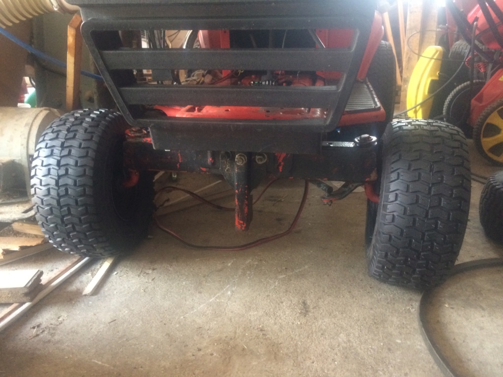

| I had bought those Murray 6" front rims originally for MTD for his 2nd pair of tires, but I changed plans, so I decided to use them for Drifting Dynamrk. I put brand new tires on them (I got them for cheap from the seller I got Drifting Dynamark from)  I think they look great on it!  | |
