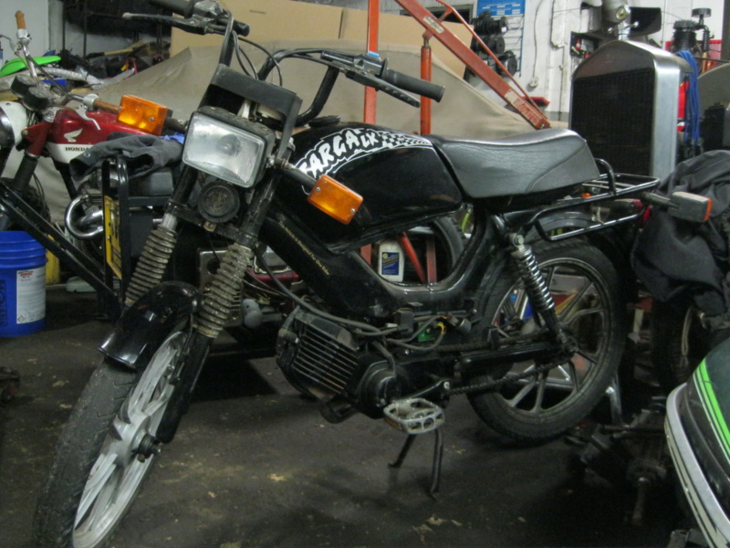

| 1999 Tomos Targa LX moped. 50cc two stroke. Two speed automatic centrifugal clutch transmisson. Top speed, about 34 mph. I bought this about a year ago with the intention of turning it into the ultimate high speed race ped. Mopeds usually get a pretty bad rap for being sissy machines. Ride one for awhile and you'll hear people yelling "Get a real motorcycle!" out their window as they pass you in an intersection. Or the kids walking in the parking lot of your local walmart will yell, "Heyyyyy it's a moped!!" The woman riding on the back of the harley that passes you on a back road will look over and be chuckling. That's to be expected, if you want to ride a moped, you know that it's coming. And more or less, it is a sissy machine. It beats walking or pedaling up a long hill by a lot. But as far as high speed thrills are concerned...uh...not so much. BUT! Maybe not too many people know, there is a pretty large aftermarket for performance parts for these things, especially Tomos mopeds, but also other brands. Big bore kits, exhaust pipes, intakes, different heads. So my plan is to buy all the biggest, hottest parts that are available, and with a few of my own modifications also, have the worlds fastest street ..eh emm.... "legal" moped. I have read online reports suggesting 60mph or more is possible with a 70cc kit My goal is at least 65mph top speed  Stock and tired looking engine. Plastic factory air box and Dellorto flat slide carb. I'll be switching to a mikuni round slide  This is actually not the factory exhaust. It's an aftermarket Bi-turbo exhaust (which is extremely dented up on the bottom) These are the low end of the aftermarket stuff, we'll need something a bit more high tech This one is going on the wall for display  First we gotta tear it down, then order a ton of parts I'll keep the updates coming... | |

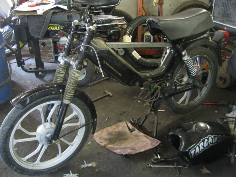

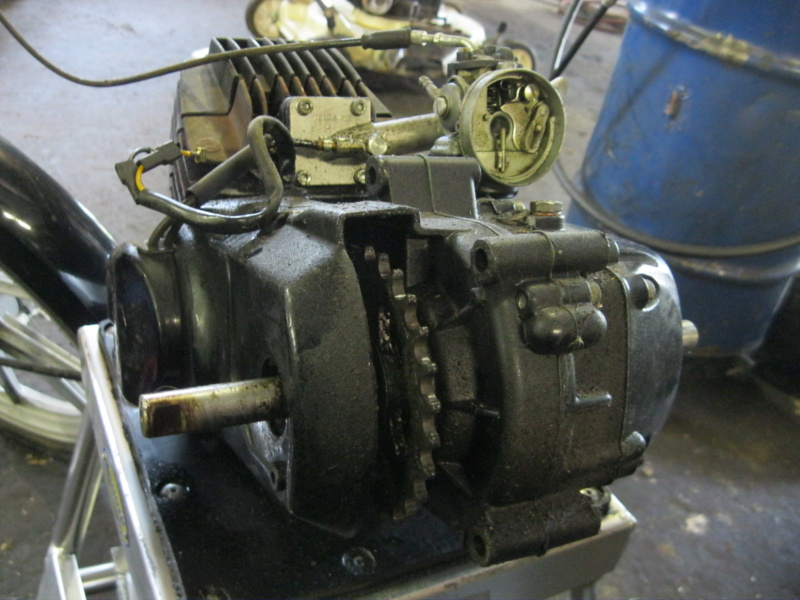

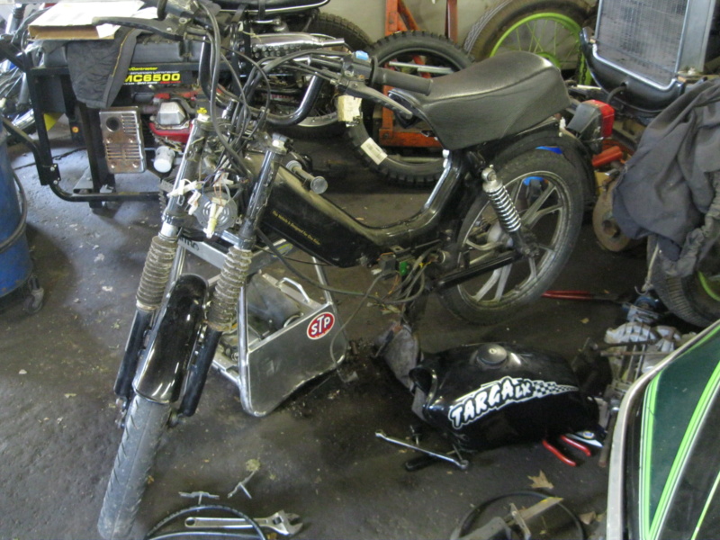

| Thanks. Yeah It'll be sort of a sleeper I suppose. Right now the engine is out and I'm working on the upper frame brace The plan is to weld in some 1" square tube. It should still fit nice under the fuel tank  Pedals removed. The two clutches are under that bulged area right under the carb They have a cork lining and run in automatic transmission fluid One is for 1st gear and one for high gear  Drive sproket and the three mounting points on the engine visible Once I mod the engine, I'll also change the gearing a bit I'll go a few teeth larger on this front sprocket 26 tooth front is supposed to be stock, I hear going much larger than 29 or so requires hacking into the case Going smaller in the rear is hard too because the edge of the rim prevents you from putting a much smaller sprocket on  | |

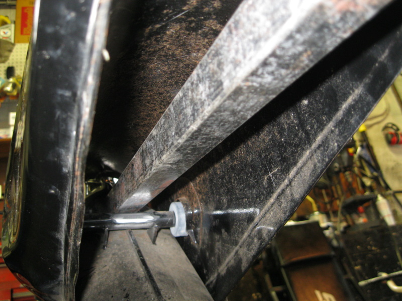

| 1" square tube frame brace. Still needs to be welded in place but I think that should keep things feeling solid during high speed and hard cornering.  On step through models, that fatter front part of the frame is used as a gas tank.  | |

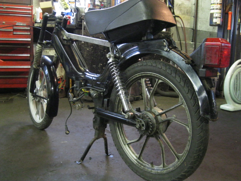

| That's no problem lol, the gas tank goes over it anyway so same difference. Welded in the frame brace  Cleaned some of the mold and dirt off the frame so we look a bit more professional  Still plenty of room under the gas tank around the brace. Clears it no problem.  | |

 | Subject: Re: Tomos Super Moped August 12th 2018, 1:49 am | |
| Those rims look pretty light duty. You sure they'll hold up? | |

| Thanks mightyraze
Rims hold up? I have no idea lol. This morning I found a dented in spot in the rear one. It's out of round a bit, not sure if it had anything to do with me trying to hop over a small log with it a few months back or not...
Other guys have reported 60mph speeds with these with a kit, so it's been done. But with a lot of use and possibly hitting some accidental bumps, I really don't know what will hold together. The whole thing is pretty light. It's not meant for this kinda thing for sure. Buahahahaaaaa. We either hit 70mph or end up in the hospital....or both | |
