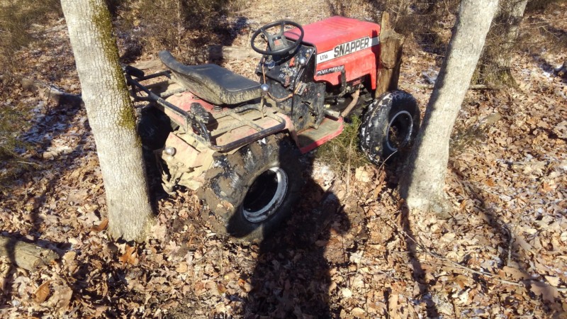

| Stuck it im between these trees for a second.  This big stick was very well attatched to the ground for some reason, the whole tractor rotated around it  | |

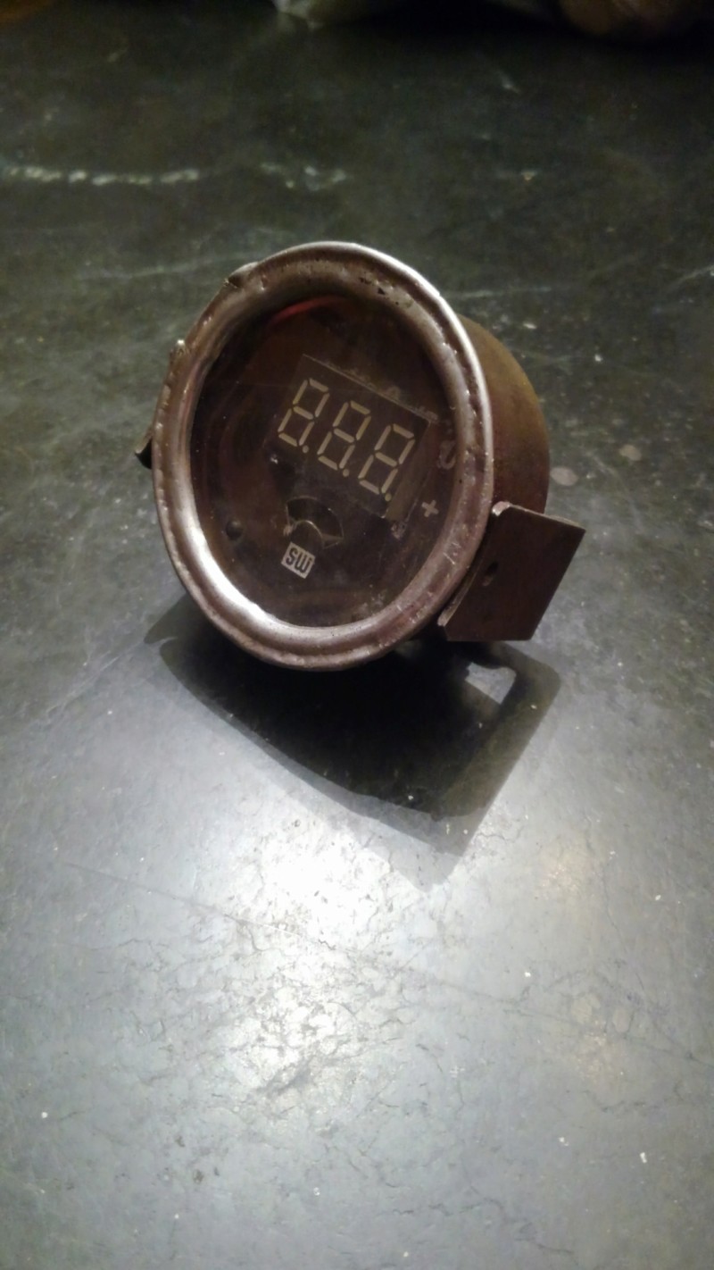

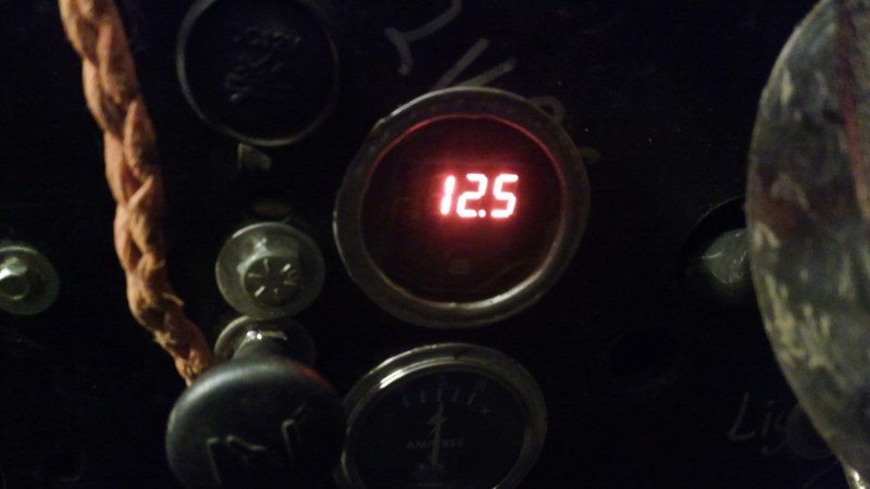

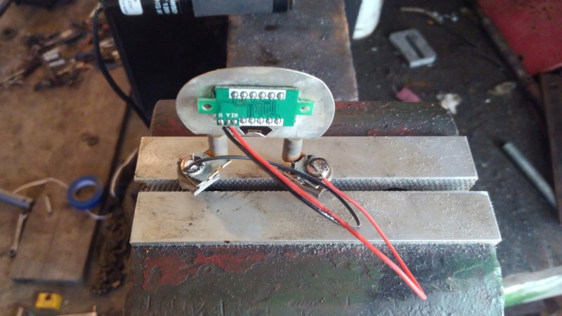

| My friend accidentally ordered 2 extra of these little volt meters so he gave me two to do something with.(thats his hand haha I'm not married)  Took an ammeter that had gotten full of water and stop working. Cut a hole in the face with a sharp chisel and hammer. Cut the bridge in the middle so it wouldn't pass current and soldered the ammeter wires so i could use the posts for terminals like normal.  Test without a window in, looks good!  Cut a piece of plastic from an Utz cheese ball jug for the gauge face. The glass had broken a long time ago from floating around in the bottom of a toolbox. All crimped back together nicely.  Little work with a holesaw and now i have something to remind me that i need to buy a new battery every time i turn the key on this thing.  Also put a diode back in the lighting output of the coil to have a bit more use from the charging system.
