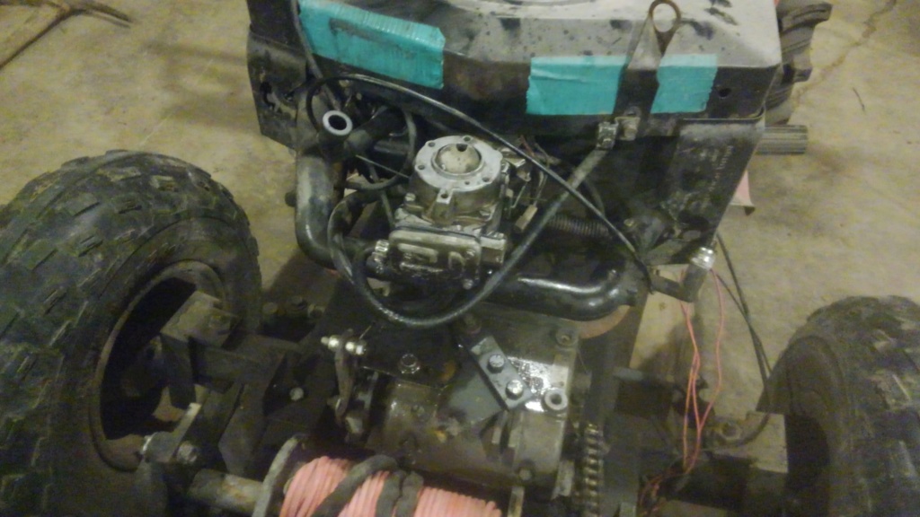

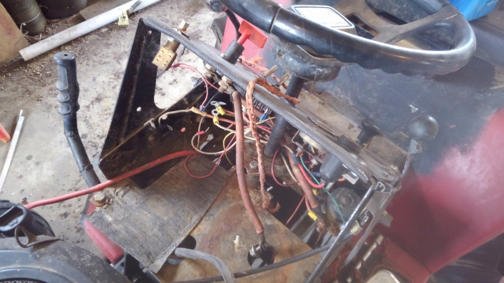

PostSubject: Re: Craftsman GT3000 "MUTT"   Craftsman GT3000 "MUTT" - Page 8 Icon_minitimeApril 10th 2020, 11:17 pm
Long time no see on this one.
Craftsman GT3000 "MUTT" - Page 8 Kimg1718
I sorted through my carbs and found one with bigger jets. Why not, says I. It wouldn't pump fuel at first. I'd never had this carb running before(i think it came with a 20hp that I just swapped carbs off of). I took my beater precision stone to the fuel pump mating surface, changed the diaphragm, and put a bit of spray oil in to help it catch prime. One of those did it and i had a small geyser from spinning the engine with a drill. I'll test fire in a bit, digesting dinner now.
Craftsman GT3000 "MUTT" - Page 8 Kimg1719
Mechanically she's sound. Electrical and the carb are the current problem, and why i abandoned it for a while. I may just clear out the electrical and start anew. It's a mess from the 4 years of my additions.
