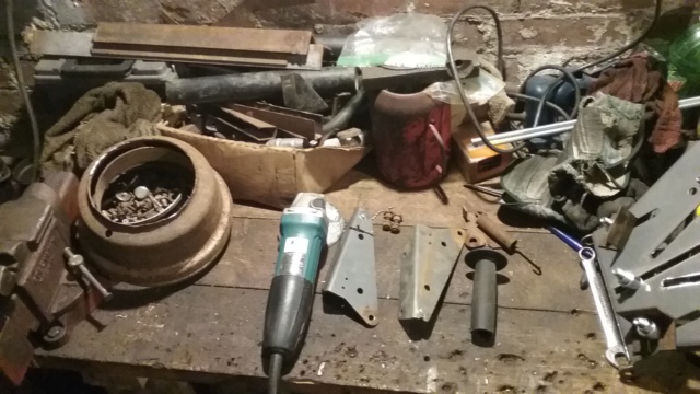

I pick through my best junk for this, the junk on the bench in other words.
drive - Make your own front 4 wheel drive axle? - Page 2 20200125
I mount the side handle on. Then grab the seat brackets and use one to fit it on the hand grinder, then slice it up to fit snug. The bolt on the bracket fits under the grinder handle for support. The hole next to the bolt is where I will mount the assembly to a rod and will swing into the rim.
drive - Make your own front 4 wheel drive axle? - Page 2 20200129drive - Make your own front 4 wheel drive axle? - Page 2 20200130
The side handle screwed on is the only thing holding the bracket on while the bolt up under the bracket  is just there to help support the hand grinder under the handle.
drive - Make your own front 4 wheel drive axle? - Page 2 20200127
A better view of under the hand grinder handle with the bolt bolted to only the bracket. Should keep the hand grinder from vibrating while running.
drive - Make your own front 4 wheel drive axle? - Page 2 20200131

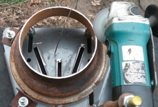

I will cut up a threaded rod for it to come up from the rim holding jig and will support the hand grinder with a cut off wheel, that will swing into the rim. Here are the pieces I use. A couple of alternator spacers, various size spacers and washers, a couple nuts, and a 13 inch long piece of threaded rod.
drive - Make your own front 4 wheel drive axle? - Page 2 20200132

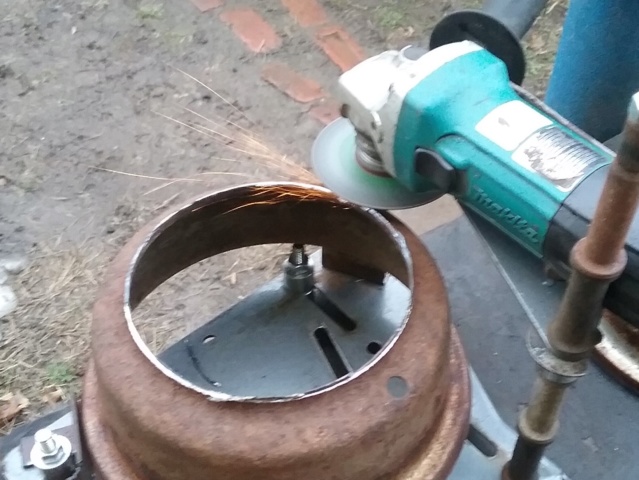

I piece it all together. The hand grinder will be able to be adjusted with it's height by rearranging the spacers, washers, and hand grinder bracket. When I tighten the threaded rod tight, I still can swing the hand grinder into the rim. The setup seems to be stable but with some effort the fixture will flex. Improvements on it will be later but for now and for the most part the assembly works. The threaded rod can be moved in different spots on the rim jig for different rims and I can also just drill another 3/8" hole if needed too.
drive - Make your own front 4 wheel drive axle? - Page 2 20200133
I do a test run now by just scribing a line in the rim all the way around. Worked pretty good. The rim jig needs to be mounted to something so it doesn't move to free up the hand holding it in place. Then I can use one hand to push the hand grinder into the rim and the other hand to spin the rim. For now, I set the cutoff wheel on the rim, turn the grinder on and spin the rim to make a mark all the way around.
drive - Make your own front 4 wheel drive axle? - Page 2 20200134
And the end result. Cool, it works, LOL.

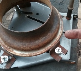

PostSubject: True up the rim halves   drive - Make your own front 4 wheel drive axle? - Page 2 Icon_minitimeJanuary 25th 2020, 8:37 pm
Hay People,
I slice and diced them up. As far as I can tell the jigs worked great for trueing up the rim halves. Definitely need some improvements on the jigs, like a way to push the grinder into the rim by a spring or something. A little grease on the bolts that ride on the rim bead, I had to use both hands to turn the rim. So to cut the rims, I pushed the grinder with a cutoff wheel into the rim till it cut into the rim alittle bit then spun the rim with both hands. The cutoff wheel would cut the rim until the cutoff wheel wore down and would have to push the cutoff wheel into the rim alittle more, then spin the rim with both hands till it wore down again, and so on. Doing all this though took only a couple minutes. Was well worth the time it took to do this. I took a lot of pics too, 14 in total, LOL.
First rim. I redid the bolts and brackets that held the rim in place to fit in the jig better. Had to move one of the brackets to a different spot because a spacer was in the way.

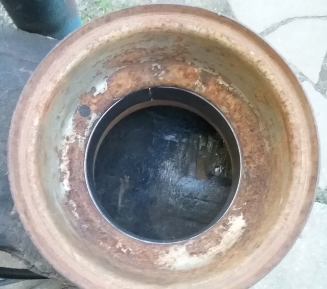

So, after cutting out the hubs completely, trueing up all 4 rim halves, the end result of all this is that the rims when set together have a width of 6 1/4 inches wide.
drive - Make your own front 4 wheel drive axle? - Page 2 20200154
6 1/4 inches wide is not too bad. Yesterday, I went to Home Depot and got some flat stock steel. I got 2 pieces, a 1 inch wide and a 1 1/4 inch wide. I think I will use the 1 1/4 inch flat steel stock to widen these rims to 7 1/2 inches wide, but I might just go and get a 2 inch wide piece just for kicks. I think I'll measure a rim up that is whole first to see exactly how wide a standard rim is and then make the call on how wide to make these. I want mine to be wider then a standard rim, just because I can, LOL. To do this, roll the steel, I need to make the tool. The steel roller will be used for other projects also, not a dedicated jig just for this project. So I will be posting this build of the steel roller in another thread. Guess which one, LOL. OK, that's it for now... Later.

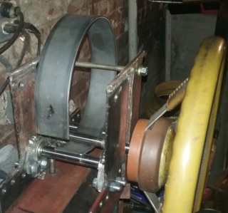

OK, doing the actual rolling is probably not what you are thinking. What you are probably thinking of the outcome of me rolling the metal plate on my tool I made, the outcome of a perfect ring will not happen. The metal roller does make perfect rings, if I was using sheet metal for this which is easy to bend. But I am using steel plate and is way harder to get a prefect ring. Even if I spent the money and bought a professionally made tool, the outcome would be the same. To get a perfect ring, I would have to roll the metal onto itself towards the end of the rolling. Pretty much impossible with steel plate. What will be achieved is a coil like shape wound in an even curl so I can bend it into shape with minimum effort and will bend evenly all the way around when doing it. I pretty much bend it close to shape and then finish bending it with my hands to finish the shape. The final bending will be done when I weld the pieces together on the rims. You'll see, LOL.
On to the rolling.....
I mount the steel in the roller and start rolling back and forth. Cranking on the bottom wheel a couple twists and rolling back and forth. So far, so good.
drive - Make your own front 4 wheel drive axle? - Page 2 20200364drive - Make your own front 4 wheel drive axle? - Page 2 20200366drive - Make your own front 4 wheel drive axle? - Page 2 20200365
So far a 9 inch ring. Nice and even curl to it too.
drive - Make your own front 4 wheel drive axle? - Page 2 20200367
The flat spots are the worst to deal with. I get a small of a curl to roll the end under the rollers to make a smaller curl but I can't get to the end on one side. I do manage to get a smaller then what I need curl. It is easier to unroll a curl evenly then it is to bend it sharper evenly.
drive - Make your own front 4 wheel drive axle? - Page 2 20200369drive - Make your own front 4 wheel drive axle? - Page 2 20200370drive - Make your own front 4 wheel drive axle? - Page 2 20200368

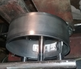

Here is the outcome of the first rolled piece of steel. It's not good but it's not bad either. Definitely a workable piece though. The roundness of it is even and working the metal is something I can do. No way could I get a nice enough piece like this from just bending it around a pole free handed, no way.
drive - Make your own front 4 wheel drive axle? - Page 2 20200371
I do the second piece and I get better at it. I roll the ends differently on this one and make it more evenly curled. Getting better with experience.
drive - Make your own front 4 wheel drive axle? - Page 2 20200373
OK, a little mockup for motivation. Definitely cool, LOL.
drive - Make your own front 4 wheel drive axle? - Page 2 20200374
8 1/4 inches wide, as ordered.
drive - Make your own front 4 wheel drive axle? - Page 2 20200375
I can't be more happier with the outcome of both pieces. I can work the rolled steel with little effort now. The "Behind the 8 Ball Steel Roller" worked great. When I get to welding the rims up, the outcome of the surface will be a smooth curve and not a lumpy surface with flat spots on it. I'll weld the rims up when I get all the pieces made for them. Next step is to make something that makes the hubs of the rims. Need the hubs to fit in the rims and bolt to the wheel bearings. This will be another tool I need to make and will be on this thread since this is the only thing it will do.

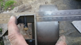

drive - Make your own front 4 wheel drive axle? - Page 2 20200410
I trim one end off using a square, then the other end the same way.
drive - Make your own front 4 wheel drive axle? - Page 2 20200411drive - Make your own front 4 wheel drive axle? - Page 2 20200412
With a little trimming, I guess my tool can make a pretty good ring.
drive - Make your own front 4 wheel drive axle? - Page 2 20200416drive - Make your own front 4 wheel drive axle? - Page 2 20200415
Next, is to trim to the size of the rims. Bending, pushing, grunting, you know. LOL.

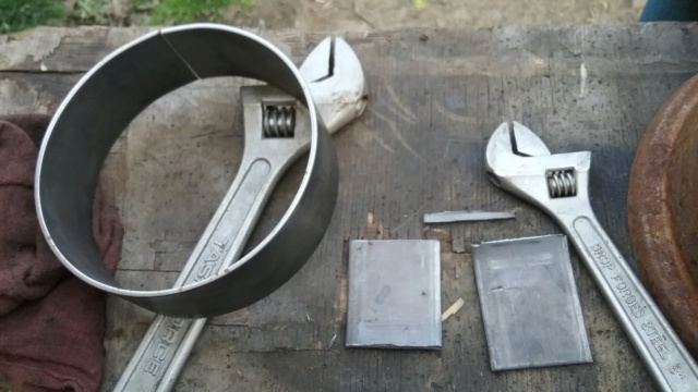

drive - Make your own front 4 wheel drive axle? - Page 2 20200418drive - Make your own front 4 wheel drive axle? - Page 2 20200417drive - Make your own front 4 wheel drive axle? - Page 2 20200419
I got the band close to size by trimming. Here is what is wasted from a 2 foot piece of steel.
drive - Make your own front 4 wheel drive axle? - Page 2 20200420

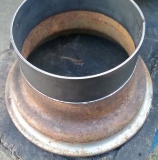

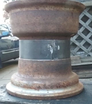

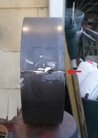

Next, I want to put 1 tack weld on the band to hold it together. I lay the band on the rim, lay the ground on top and tack it up. NOPE! The ends don't line up. I thought laying it on the rim would give it a flat spot to line up the halves, but NOPE. So tacking it in place this way is a no no, LOL.
drive - Make your own front 4 wheel drive axle? - Page 2 20200422drive - Make your own front 4 wheel drive axle? - Page 2 20200421drive - Make your own front 4 wheel drive axle? - Page 2 Inked210
I grind the tack weld off and clean the metal up for try #2. Took about 15 minutes to figure out another way. 2 pieces of steel with the band sandwiched between them. Worked pretty good for what it was.
drive - Make your own front 4 wheel drive axle? - Page 2 20200423
drive - Make your own front 4 wheel drive axle? - Page 2 20200426drive - Make your own front 4 wheel drive axle? - Page 2 20200424drive - Make your own front 4 wheel drive axle? - Page 2 20200425
drive - Make your own front 4 wheel drive axle? - Page 2 20200427
drive - Make your own front 4 wheel drive axle? - Page 2 20200428drive - Make your own front 4 wheel drive axle? - Page 2 20200429
I need to do the other band next. I might weld a little bit more of the seam then flatten it out with a grinder and run the band through the roller some more since it is a ring now. See if I can make it better, LOL. The tack welded area is not perfectly curved. I'm still trying to think of a simple way to make the hubs. Got a plan but isn't a good way of doing it yet. I'll figure it out, no worries.
