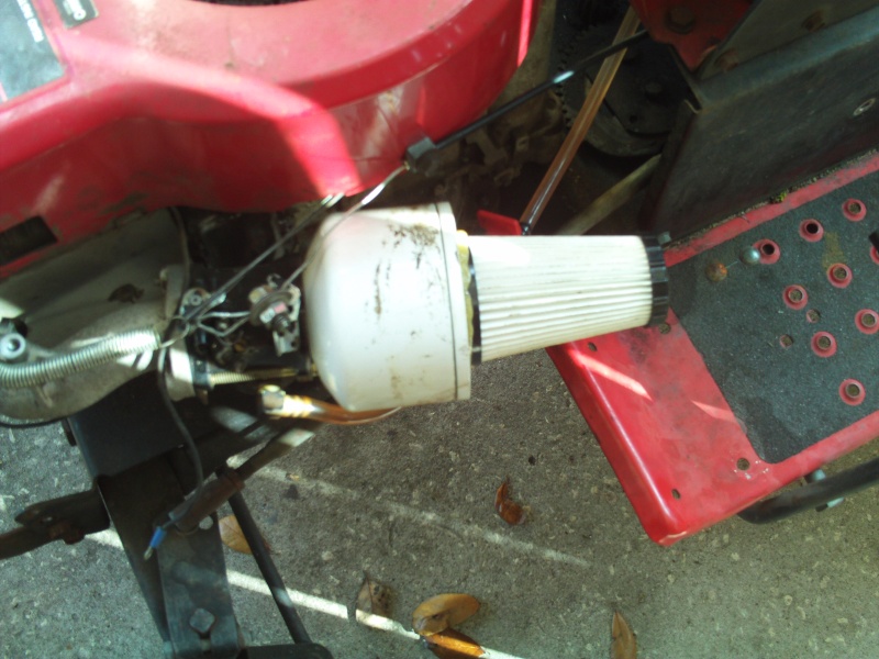

PostSubject: Re: Gas Pedals   Gas Pedals Icon_minitimeOctober 22nd 2011, 6:24 am
You have any spare tractor parts around? I did a gas pedal on my mod MTD for practically nothing - used the clutch pedal assembly off my wheelhorse ( it doesnt need it) , couple springs, couple brackets i had, some bolts and bicycle derailer cables.
Gas Pedals File0012
Gas Pedals File0013
My mod tractors all use the governer, first i dont want to wreck a perfectly good motor and second if over revved the flywheel would explode .
I pushed my mod murray to around 35-40mph - it was too unstable to attempt any faster speeds( it wouldve went faster)- it was nearly all stock and i used the governer.

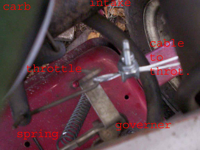

Bandit1: the murray had a 18HP twin opposed on it and a 6 speed trans along with a 6" motor and 4" trans pulley and 8" wheels all around.
Heres how i did the throttle with the governer on the twin:
Gas Pedals Thrott12
Another thing that made the murray hard to handle was i used a ATV brake handle for a throttle on the steering wheel as a first attempt at building one - not good for driving and trying to steer and shift all at once. And it had no brakes - another challange....
The smaller motors i tried would barely hit 15 mph- figured with a whole lot bigger motor it would move lots faster..... the MTD could barely get out of its own way - BUT after looking in my MTD owners manual from my 92 white, adjusting the speed control rod wouldve propelled it a bit faster - the PO on my 91 stock mower tweeked it, thing goes fast in 7th. Dont have my MTD together anymore tho......
