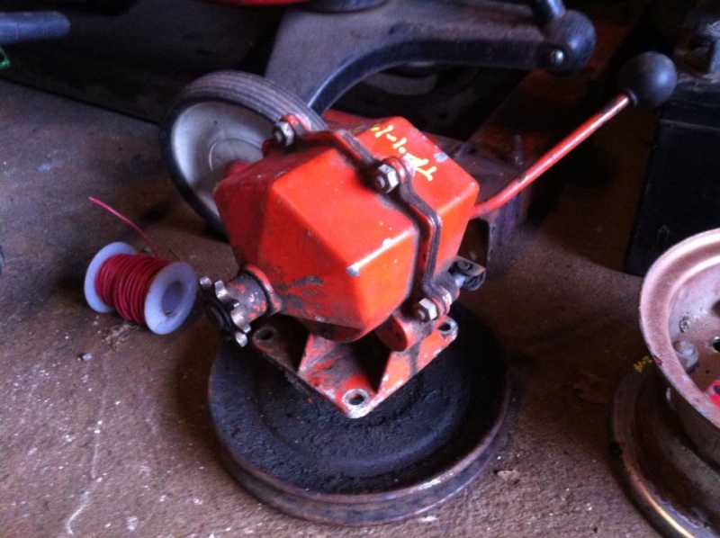

I bought this at the junkyard from a jacobsen. RAGB F-N-R tranny. kinda a secret plan for this thing as a spring project.
MTD off-road romper build. - Page 19 15265610
On a side note, i think i found a 633 or something like that axle with 3 bolt hubs on it. cast iron-maybe. Will they work on my 820? they have set scres so it doesnt slide back and fourth. Id need a puller to bring to the junkyard, maybe they will come off.

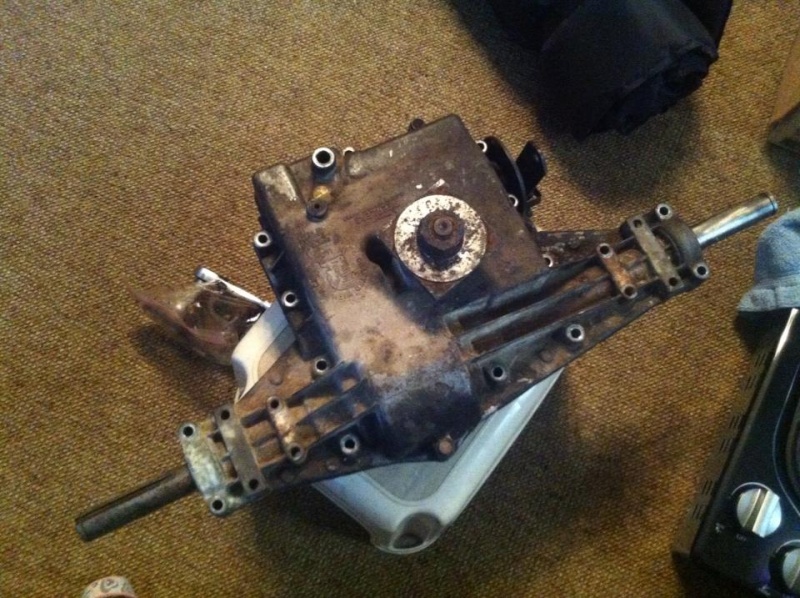

Cleaned the 820 and got spiders out for fozzy lock.
MTD off-road romper build. - Page 19 7282_410
MTD off-road romper build. - Page 19 Screen17

I think the transaxle I pilfered off a lawnchief at the scrap yard is an 820. A 3 speed...
I got it for a spare incase the one under the craftsman decides to die.
Found out what tranny this is. ITs a foote model 35.
Little info twards the bottom of the page on these. $65 a gear affraid
http://www.gilsonsnowblowers.com/snowparts2.html

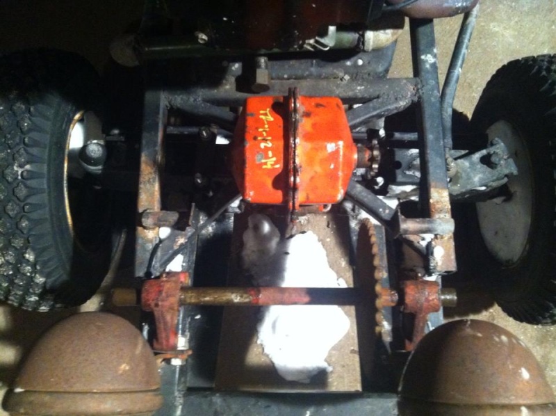

Interesting. That's a neat little transmission! I didn't realize it had dual outputs. Are the locked or Diff'd?
Points : 7060
MTD off-road romper build. - Page 19 Empty
PostSubject: Re: MTD off-road romper build.   MTD off-road romper build. - Page 19 Icon_minitimeFri 24 Jan - 16:44
liked, but mine doesn't have dual outputs lol

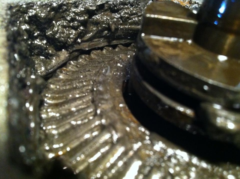

More Pics of this gearbox im cleanin up.
MTD off-road romper build. - Page 19 15555711
MTD off-road romper build. - Page 19 15463110
Stripped gear
MTD off-road romper build. - Page 19 10165410
FFS!
MTD off-road romper build. - Page 19 15124810
Ill just flop the gears and grind down the teeth on the other one. Some people can guess what im doing with this Rolling Eyes

Fozzy locked the 820. Now i can slap it all back together and see how this locker works out! Yippie lol
MTD off-road romper build. - Page 19 17436511

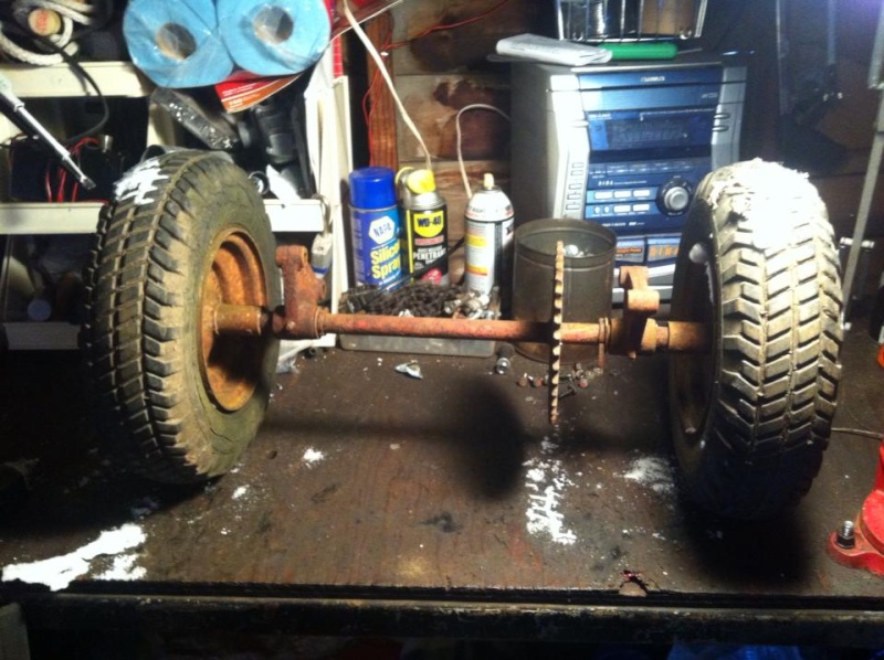

820 almost together. Not in a rush but glad not to have parts everywhere.
MTD off-road romper build. - Page 19 15662_10
Now plain and simple, im making a winch for my tractor. the foote was a perfect subject for this. Very small and everything checks out in it.

Cut the end of the axle off and fought the sized axle bushing. Got if off with a bfh.

Bazinga! everything apart. obviously need to trim the axle when i figure out mounting points.

Here's moc up. Tranny and jack-shaft will be moved forward a little. Probally moving lights, no biggie. just everything set on there. Original grease zerks works friggin amazing, and i cleaned the axle a little and greased everything and they work flawlessly! I think these will work great concitering the drum will rarely be moving compared to stock.
