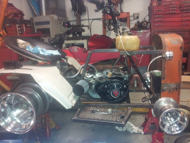

| Yea it won't be the same without that nose. That nose is absolutely perfect, the mesh, the pointed part to it, and the location is all spot-on. | |

| ya i sort of fixed that with the battery over the front axle but it will never be perfect because of the wheelbase and the tires other than that the thing turns like a champ | |

| any mods to the engine or is it stock? | |

| the engine has a dyno mod 2 cam, longer connecting rod, aluminum flywheel, and i removed the governor i also plan on getting a bored carb | |

thats a GX200 clone right well i would go with a mikuni carb and go with a GX160 head and have you upgraded the pushrods if you havent i would also get chrome moly pushrods and 18lb valve springs that cam is a good cam but it wont give you a whole lot of power i recommend a .265 cam that with the mikuni 22mm carb will give that engine some Power | |

| i forgot to mention the 18 lbs. springs the engine is set up for 9.5:1 compression any more i would need racing fuel to get it to run right but i would like to get better push rods and some 1.2 or 1.3 to 1 rocker arms and good idea on the mikuni carb ill look into that | |

well since you got a longer con rod you need to watch out on the rocker arms you dont wanna give your valves to much lift because you might just screw up the piston lol and if you wanted to keep your compresson like it is you could always upgade to a 22cc big valve head ive ran one on my old dupor clone it was running good but i wanted more so i got that big valve head and my dupor really woke up lol | |
