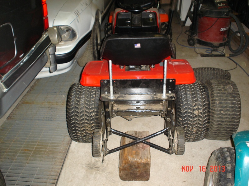

this project has both the vari-drive and a 6-speed peerless.94 MTD pulling tractor Projec19

I was thinking the other day about how the mtd vari-drive works, and how most of there tranny's are a single speed foward and reverse. Your gears are controlled through the vari-drive pulley's.  What if you took out the old single speed foward/reverse tranny, and replaced it with a 4 or 5 speed, and left the vari-drive intact? You would still have the 5  gears from the vari-dirve(I've seen some with 6), plus the 4 or 5 gears on the tranny. If you did it with a 4 speed tranny and 5 speed vari-drive you would get a total of 20 possable gears! A 5 speed tranny with a 6 speed vari-drive would give you 30 gearing options.
Are you all getting what I am saying? I know we all hate the vari-drive, but what if you made this work? I think It can be done quite easily! In fact, I have an old complete 6 speed mtd body and frame, and two 4 speed tranny's, one peerless, one foote.
Hmmm.....  Twisted Evil
Hey fearless, I did it with a 6 speed peerless from a Murray and an MTD varidrive with a 18 hp opposed twin. it goes about 15 mph, and I use it for lawn tractor pulling in the 750 lb modifyed class. the only problem is finding the right belt. the size was between 45" and 46", and I finally found a 45 1/2" from a heavy-duty Chevy 4500 coe with the Izuzu desil? idk how to spell it, but it works pretty good, I will get pics soon

Big update! the engine is now the kawi from the murray and the tranny is a 930 from a john deere. the 930 has a short shift shaft and input shaft, and the mst had long ones. nothing would work, so I riped out the hole sistem. built a new clutch in using the vari-drive mount and got it all reddy for a drive! time for school thow. the originall deckbelt fit purfectly!
