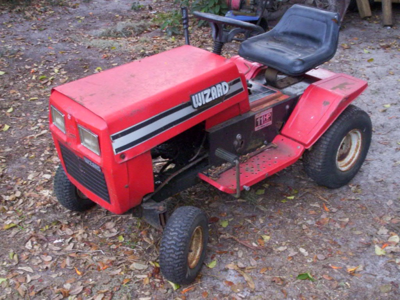

Well, been meaning to tweek n mod my wizard now for about 2 years ( or more) - wasnt sure at first what to do with it, but came up with the idea of using my 5HP honda horizontal shaft motor and a go kart clutch to power the little beast.
Grocery list of goodies :
Lowering ( 4" ride height)
1" straight axle
6" split steel rims
4 tubes ( needed for split rims)
bering hubs for front
keyed hubs for rear
2- 1" pillow blocks
drum brake
foot throttle
lowered seating position
lowered front axle
I plan on running a 4" axle sprocket for a first setup , also plan on building a custom set of spindles for it for max lowering.
Before:
MTD Wizard 'go kart' build 22516510
Disasembly:
MTD Wizard 'go kart' build Stripp10
Ive already removed all the deck hardware and handle, i still need to lower the front axle to get my ride height set- i might need to adjust the fender height and keep it in mind while marking stuff out. Ill also need to reinforce where the rear axle is, so i dont rip it out.
Get further updates soon.
