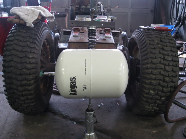

Might use this zero air can as a gas tank. I ground through the spot welds and took off the bottom ring and handle.
BAJA SEARS BUILD - Page 2 Img_3131
I'll cut off the nozzle. I was thinking that a gas cap and filler neck from a car might be neat, but I have to find one that's in usable shape. My cage bumper will protect the tank. I imagine it probably holds around three gallons but I didn't check it yet. They aren't coated with anything inside so I would probably use some of that gas tank sealer to prevent rust before final assembly. Yes it was a little tough getting the tank to sit on the end of the grinder.
BAJA SEARS BUILD - Page 2 Img_3132

Definally diggin that tank. Id go with it.

I really like that tank  Very Happy

Yeah, I always liked the looks of the "barrel" fuel tanks. Makes me a little nervous about the placement though.... Is anyone on here old enough to remember the Ford Pinto cars that would explode if ever rear ended? Also, don't back into anything or hang too high of a wheelie!!!  Laughing

i like the tank idea, just dont get hit

One tank of gas would last you a month haha! A design you should incorporate is a marine type "flip top spring loaded" type of gas cap. It would top off a classy look with what your going for. Ill post a pic.
Just remember to vent the tank. You will need to vent it because its a large tank. It will cause a vacuum in it and gas wont get to the engine. This goes for using a car filler neck too. The cap isn't meant to breath very much.

Another benefit of having a nice solid steel tank is that the fuel will stay fresh forever, unless you vent it too much.  Cool
BAJA SEARS BUILD - Page 2 52689512
yup... I remember... while I never actually owned a "Pinto" I had 4 mustangs if the pinto design (Ghia) Loved that 18 to 2300 engine series
as to the vent problem in the tank... weld in a ball check valve. LOL think of it as a fuel diode Laughing

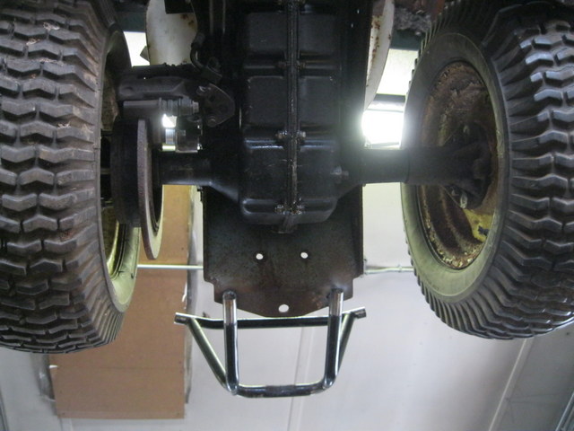

Started on the rear bumper. Some overly wide bicycle handlebars happen to look pretty close to the look I wanted without excess cutting and welding.
BAJA SEARS BUILD - Page 2 Img_3216
One upper bar on. I'll admit I took the easy route placing the bar under the edge instead of notching the tubing. It takes forever to notch it with a grinder though and never lines up straight when your done. I was going to try it with a hole saw, but the tubes would have had to be notched on an angle because of the way the bicycle handlebars bend towards the mower at the ends. I think once everything is together it will look ok. I could always weld the ends shut with washers or caps of some kind to change the look if nessesary.
BAJA SEARS BUILD - Page 2 Img_3220
Up in the air shot.
BAJA SEARS BUILD - Page 2 Img_3217

Second tube welded on. Next I'll make the cradles to hold the gas tank.
BAJA SEARS BUILD - Page 2 Img_3221

Looks pretty sturdy... should protect your tank okiedokie!
