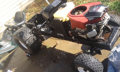

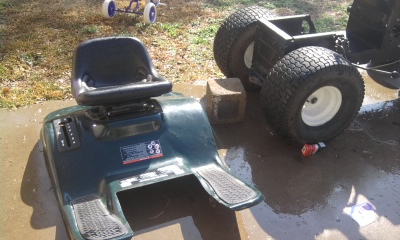

Alright so i will be moving my build up to the school shop sometime this week so the real work can begin:)
Speed Build - Page 3 Photo036
Speed Build - Page 3 Photo037

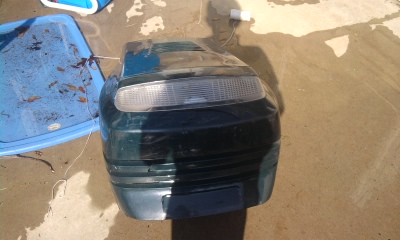

front grille is cracked up pretty bad. any suggestions on how to repair it? thinkin i might just cover with strong tape and paint over
Speed Build - Page 3 Photo038
topped off the gas so i have plenty to run it in the shop
Speed Build - Page 3 Photo039

i did some cleaning up ... all the tools loose bolts and parts gathered up and i washed the whole thing down. its ready to go now
Speed Build - Page 3 Photo042
threw the tarp back on to keep it safe

to fix the cracked plastic i think you might be able to get it where you want it then heat up a peice of metal and then besicly weld it back together just by melting it, i know a guy that did that on his four wheeler and it looked pretty good

ph wow thats a great idea i didnt even think of that. i saw a post where someone used a sodering gun but i dont have one so yea... thanks

about the grille- my original murray hood was cracked - i used a 2 part epoxy - that didnt hold worth a hoot- i have seen a plastic welder tho - similar to welding metal- cept it welds plastic.
