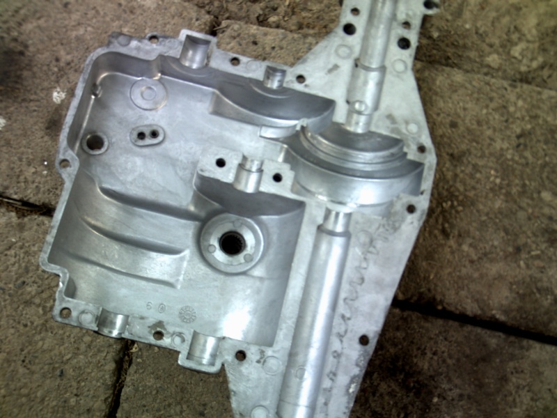

ok, this is the trans inside CLEAN I DON'T THINK I CAN GET IT ANY BETTER

so overall things are going well, im taking my time on this trans, im having the rear custom made to be possi, and there will be no spider gears or anything, just the ring gear. Im going to get new seals for the 3 external shafts, and then fill it with some thick gear oil. Well thats it for now, ill post more later on as usual.

Now this is the proper way to go about it! You shouldnt have any problems with this set up. Very clean too Shocked

good god thats a very nice tranny u got yourself there, very nice]
