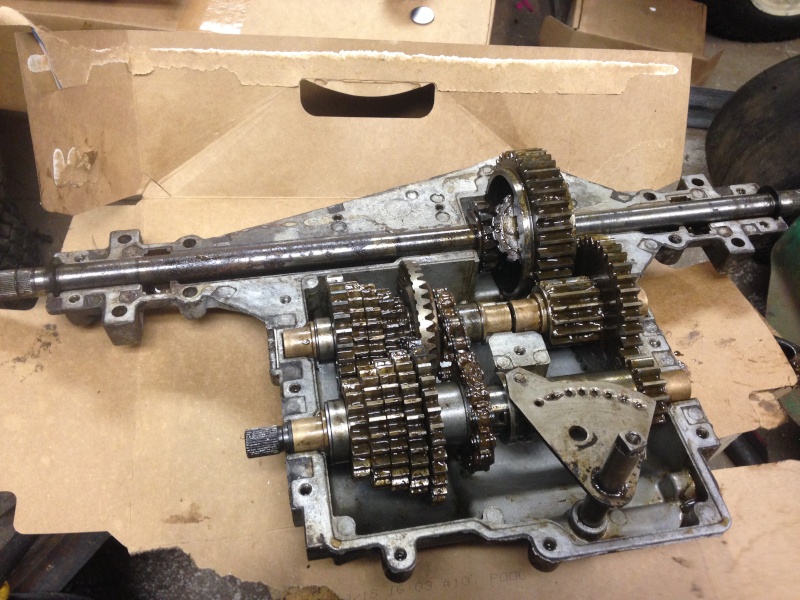

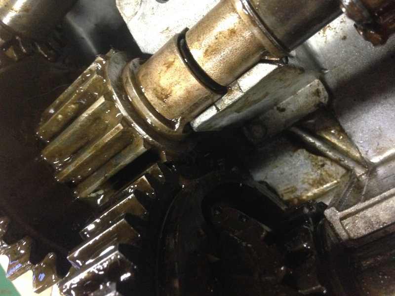

im not sure i didnt look at the tag but it is a rear steer axle im going to be using on the front, heres some pictures of what im kindof shooting for
redzz02 dynamark build Photo110
redzz02 dynamark build Photo210
redzz02 dynamark build Photo310
let me know what you think

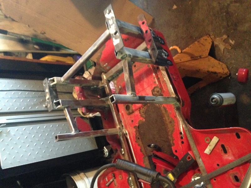

started reinforcing the frame and making axle mounts i dont have pictures of it yet, but gave it 5 1/4 inches of lift and only have the rear axle mounts made so far

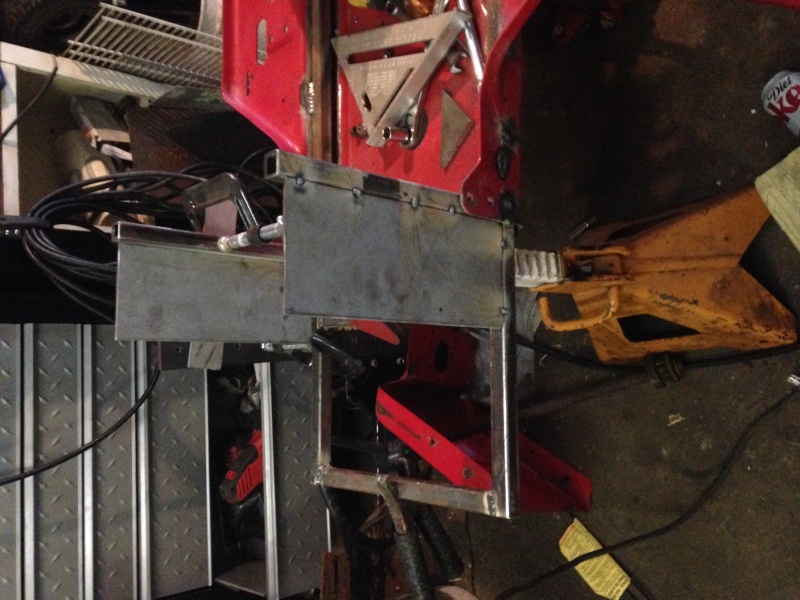

got some more frame work done
waiting until i find the correct tranny to make the front brackets and finish the bracing
redzz02 dynamark build Photo311
with the tranny mounted
redzz02 dynamark build Photo410

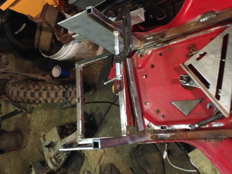

starting on the front frame extension for the steering axle mounts
redzz02 dynamark build Photo510
the start of the mounts
redzz02 dynamark build Photo213
and another shot
redzz02 dynamark build Photo112

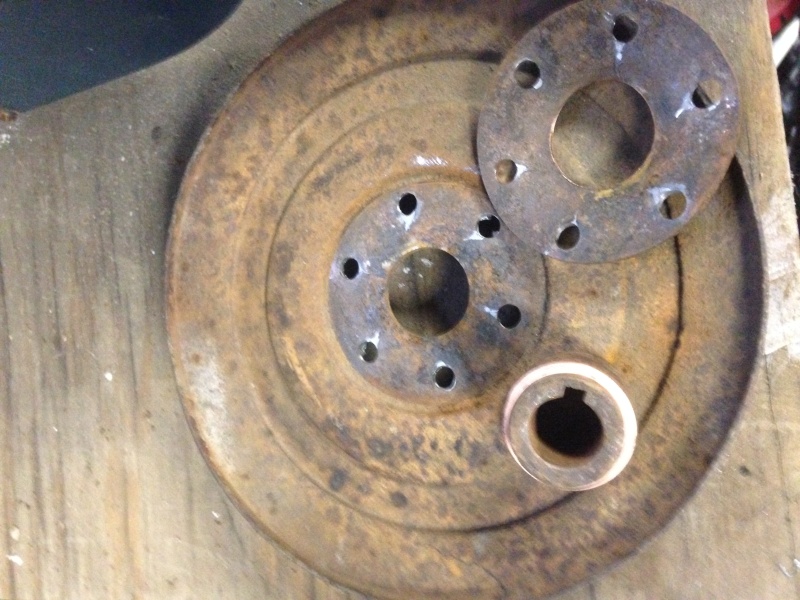

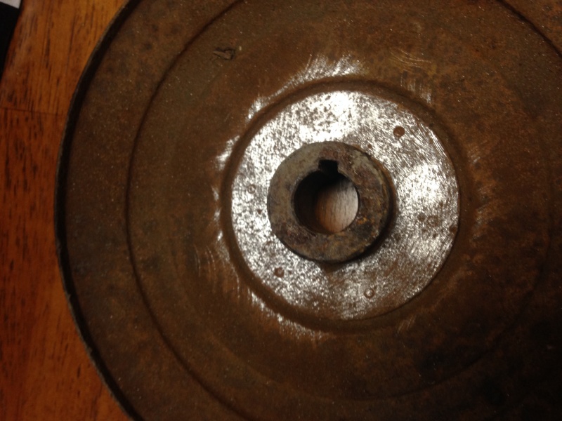

heres some pictures of the progress, i got the front end pretty close to being done minus the shifter the clutch hooked u and deciding what size rim id to run in the front, i need to order some rod ends, fuel line,  fuel pump, and more little goodies
some pictures of making a hub for the deck pulleys
redzz02 dynamark build Photo10

(photo below) the center pulley is the deck pulley with the center of the above pulley pictures welded as a hub, and the small flat idler is going to be the clutch for 4x4
redzz02 dynamark build Photo_10
redzz02 dynamark build Photo_11

heres some of an update i got the front axle all gear oiled up and sealed, i have the exhaust done as of today.
the to do list:
finish intake
make fuel tank
make shifters
add brakes
finish frame(waiting on metal)
dash board
paint
heres some pictures for now
redzz02 dynamark build Getpar10
the little tabs on the bushings inside the transaxles, you have to make sure they are down in the groove
redzz02 dynamark build Getpar11
if they are up like this, your going to have a problem
redzz02 dynamark build Getpar12
front axle all oiled, greased, and sealed
redzz02 dynamark build Getpar13
some mock up
redzz02 dynamark build Getpar14
two inch side pipes not welded to the headers yet
redzz02 dynamark build Getpar15
