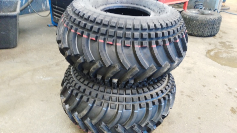

Man those tires look great. What brand are they and what size?
parrafin23
Age : 42
Join date : 2015-04-14
Points : 2936
Posts : 31
Location : Norway
Got me an Lawnmover (Again) - Page 2 Empty
PostSubject: Re: Got me an Lawnmover (Again)   Got me an Lawnmover (Again) - Page 2 Icon_minitimeNovember 21st 2015, 11:47 am
Brand :
Got me an Lawnmover (Again) - Page 2 Img_2015
Size :
Got me an Lawnmover (Again) - Page 2 Img_2016
Im realy lookin forward to try these..

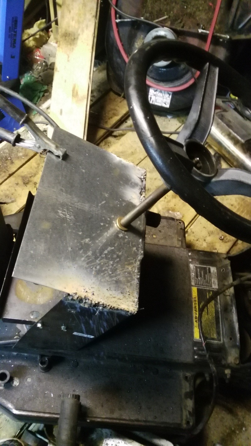

Had some fun trying to pimp up the strenght of the front a bit, just for the "susp" towers to get some more support and the front lower end :
Got me an Lawnmover (Again) - Page 2 Img_2017
Added a bit more iron to the match
Got me an Lawnmover (Again) - Page 2 Img_2018
Got a plate cut to size that I wanted Drilled a hole for the steering shaft and welded it on. its sheet metal 2.5mm in thickness.
Got me an Lawnmover (Again) - Page 2 Img_2019
I didnt get finished with it, cause i was out of flux core. damn.. Filling smal gaps is no problems, but when it comes to bigger ones, its difficult. I have more fluxcore, but im tired and a tad hungry, so this will have to wait for tomorrow..

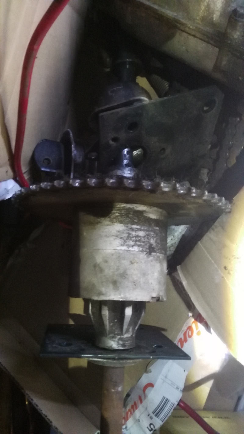

I have started to lock the transaxle, following redneckcomputergeak's instructions. You'r Video is rly good. I dont Think I would have dared to open it and try and lock it if I didnt see your video first. But the welds doesnt look too good with my welder.. I think im goin to grab my stick welder on full juice, 100Ah or 120Ah, not sure and try and weld the sucker sollid..
Im goin to fill it with oil, no doubt, But I do need a breather hose of some sort.. a one way valve perhaps, that i have to drill and tapp a hole somewhere. Or can i just fill it partly up and skip the breather part? If I do so, im afraid the oil seals will be blasted out due to the preassure build up in the case.. Im not sure. I have to start working more on it, its been sittin all winter and I have done nothing at all to it..

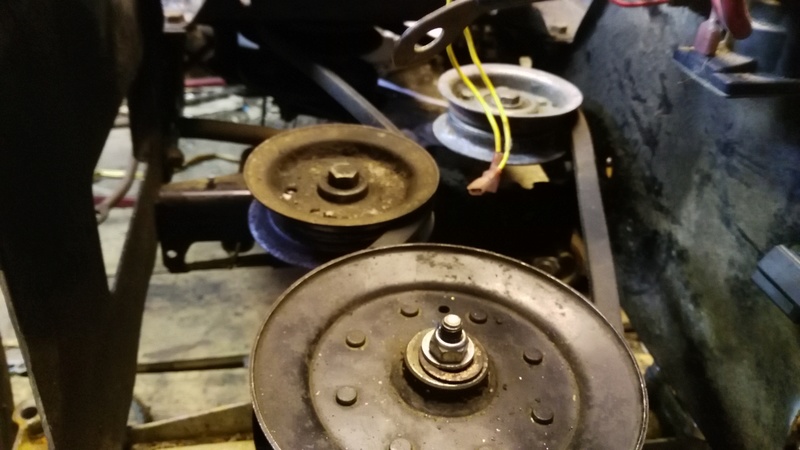

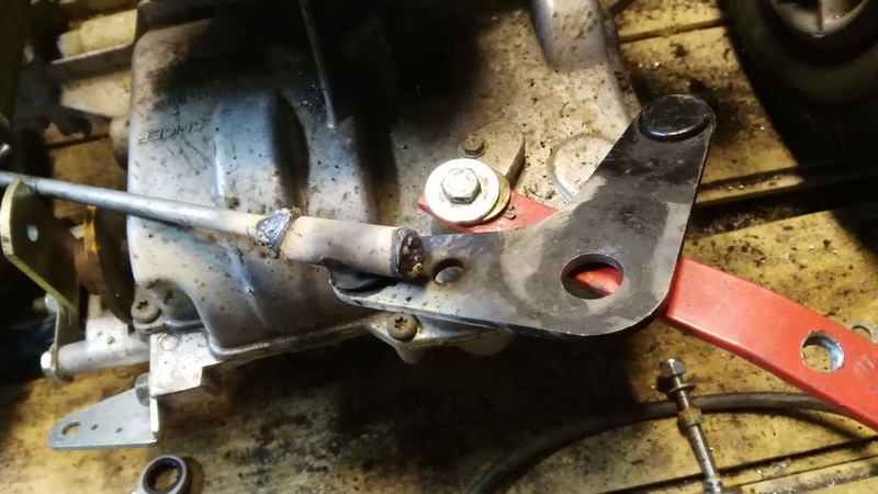

I got some done today, managed to get a 1/2 belt that was a tad too long, I added an idler so now it looks better, but time will see if it hols up or not.
Working with the shifter linkage is not so easy as i thought.I wanted to use the slot allready present for the deck height adjustment. I dont have alot of stuff around that I can use. So making something up, takes a long time, testfit and redo, test fit and redo.. I have lost count on how many times i have done this with just the rear part of the shift linkage.
