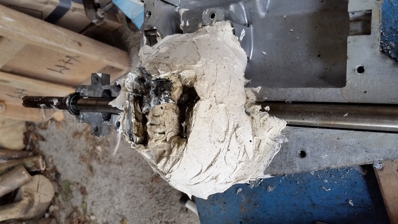

I then used plaster of paris and tin foil to make a mould to pour the zinc into the way redneckcomputergeek did, well almost. I think the plaster was still too wet and went off like a volcano for around 3-5 minutes and this was the result bfore taking it out of the mould.

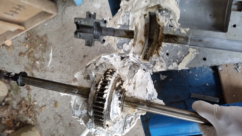

Waited around 45 minutes and pulled the diff out.
First mod on my Italian plastic fantastic. 20160415
Cleaned off the plaster of paris/tin foil and made a quick video.
https://www.youtube.com/watch?v=yWCSXgnCJA4
Then I attacked the zinc with a variety of tools and ended up with this.
