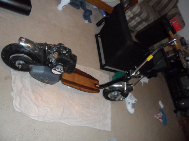

| This kid found a motor scooter in the bottom of a pond and he braught it up to the shop at school but he moved schools so now i got a free motor scooter. i dont know how long it was in the pond but it doesnt seem to be in to bad a shape. its not locked up and it sounds like its got good compression. it had no gas so i dont know if it will fire up. i doubt it will start but i plan on tearing that engine down to get a good look at the insides anyway. hopefully it wont be to expensive to fix but that will be a fun thing to play around with this summer. the wood part that u stand on is pretty bad but i can just make a new one. it also needs a throttle. and its got dual mech. disk brakes and decent suspension so thats pretty nice:) i think its a 50cc
i will have it home by friday. then i will get some pictures up

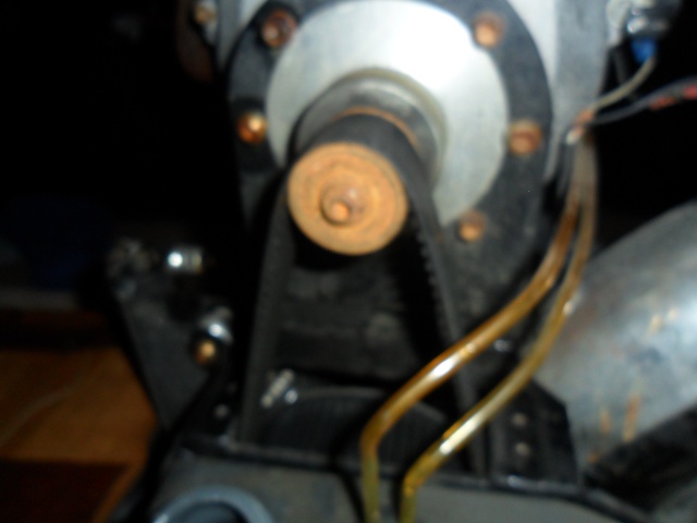

| i got the motor scooter home today. its a 40cc (not bad but wish it was a 50) and its a 2 stroke with 7000 rpm max [img]  [/img] u can tell that wood is pretty bad [img]  [/img] [img]  [/img] dual disk brakes are nice. also has front and rear suspension  for a small scooter thsis thing has a suprinsgly somplicated driveline. theres belt from a clutch to a jackshaft then from the jackshaaft to a pulley on back axle. [img]  [/img] took the engine off [img]  [/img] this carb is tiny.. lol

| Its in really good shape for doing a immatation of the titanic . Id run the motor till it blows up , then find a 5-6HP horizontal shaft motor - modify it to mount some lawntractor tires on it and go off roading with it.
Im sure the crankcase is full of water- that could be the other reason. | |
