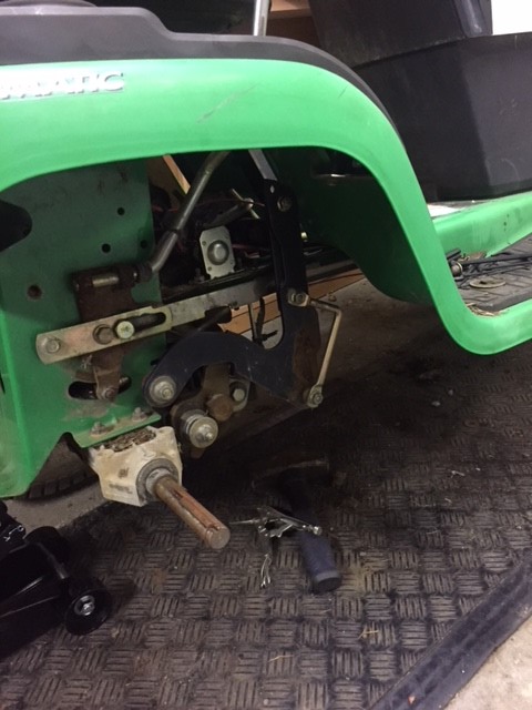

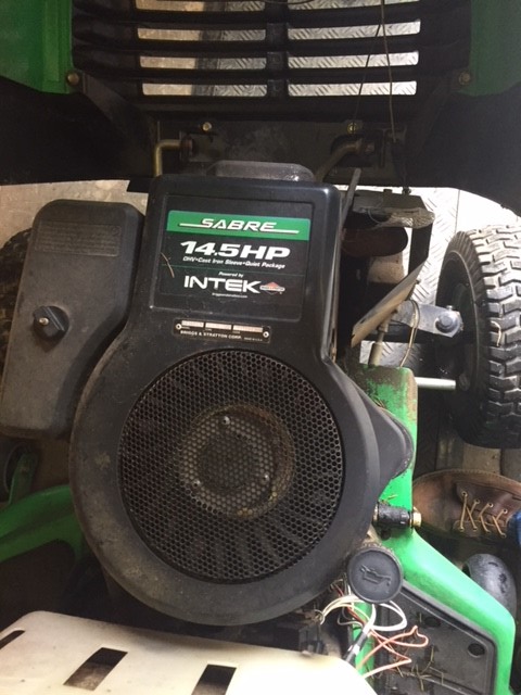

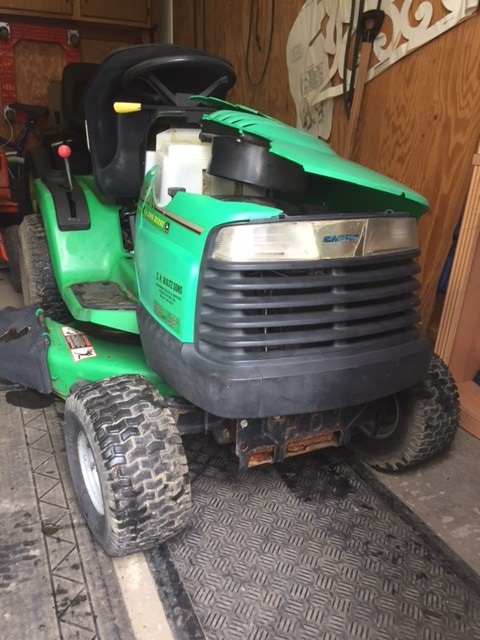

I haven't been as active here as I'd like to be but I've shared my Stanley(Murray). Anyway, I picked up a free Sabre, I was going to flip it and then my father in law asked me why I didn't keep it for Lilly my daughter. A light went off in my head and I said, YEAH! It's hydro and on the side, so it'll be easy for her to operate with changing speeds instantaneous, so no making it go fast, she'll be able to use it out at camp with me on the Stanley and her pap on his 4 wheeler on light trails. So when I got it, it didn't start, the starter was shot, robbed the one from my Simplicity and still wouldn't turn, took off the valve cover and adjusted the valves (they were sloppy) and then she fired up. I started tearing all of the mower stuff off of it today, I got her to help me the other day with the muffler and shield and she was happy and wanting to help which is a WIN, a daddy-daughter project. I plan to at least put 4 wheeler or the V style tractor tires on the rear, going to swap out the front bushings for wheel bearings, and maybe Lincoln lock the differential part of the transaxle. This tractor will do until she's older. I do however need a HOOD which they make this style in the Sabre, Scott,s and John Deere, so if any of y'all in PA are on here has a hood or knows of one, message me, please.

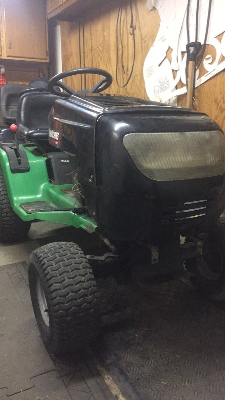

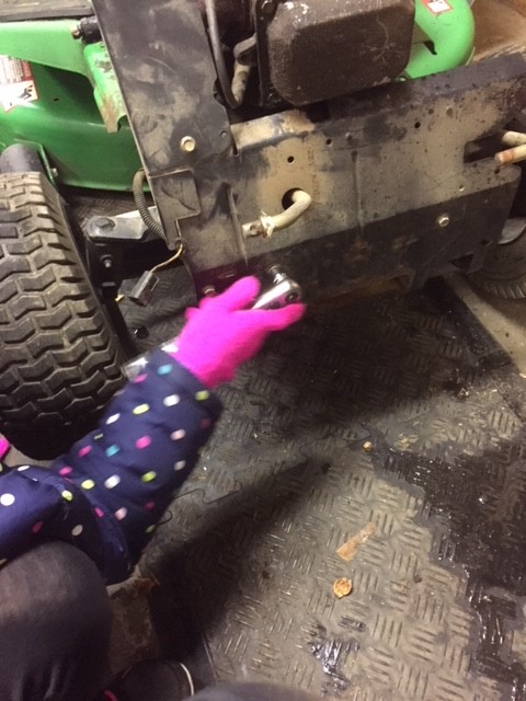

Alright, so I bought an MTD for a parts tractor. It's the first tractor I've bought and was for parts only and sell the rest to whoever wanted MTD parts. I got the bright idea to try adapting the front end to this tractor since I have it. The hood is a little wide for the dash but tonight I drilled holes and fixed the front end to the tractor. I did a "fitment" beforehand and asked Lilly what she thought and she was worried about the decals being gone, it being painted purple and that she'd have lights. Lol, she's the cutest. So tonight after school and work, we went to the shed and put the front end on. I'm probably gonna get a light bar for her tractor and mine from the Walmart because they're cheap and bright, lol. At least right now, the engine has some protection and its metal, she loves driving this thing around, I can't wait to get the ATV tires on it and for her to run it out at camp. We have a drainage ditch on the property and she loves running in that and flexes the front end out even though I don't think she realizes shes flexing it.
