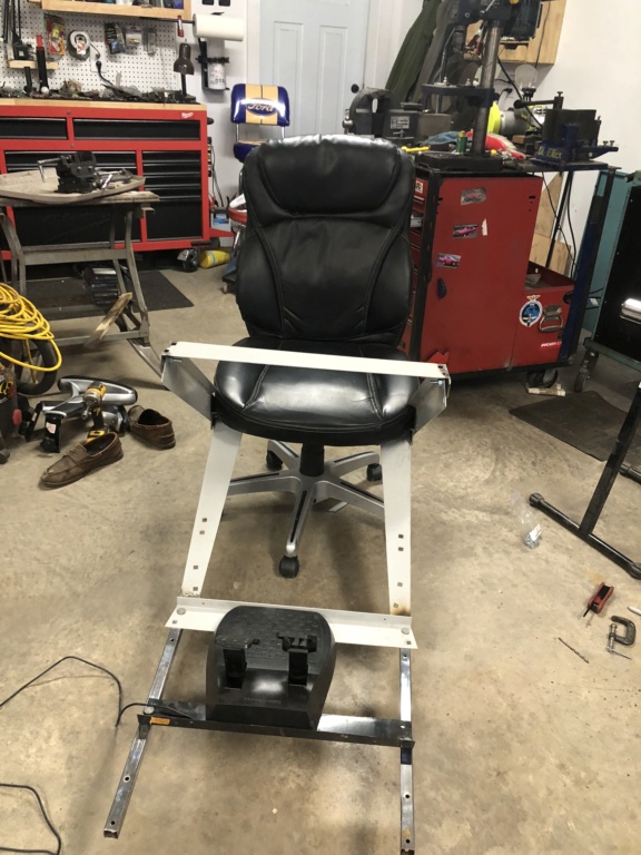

I was walking through the thrift store today and ran across a leather office chair. Arm rests were chewed up (like most old office chairs) and it was overall fairly well used. But the base and back were in decent shape and all the adjustments worked. It even had a touch of a bucket seat look to it, albeit low back and cushy. More dad's Ford LTD II than Ford GT40.
Tag says 12 bucks.
Yoink! Mine!
So I drag it home and yank the armrests off. I put them away in case I want to use them later.
I rummage through my scrap metal pile and come up with the old legs and supports for a Delta table saw and some other useful bits.
I yank the seat bottom upholstery and bolt on a couple side brackets, then staple the upholstery back into place.
A little cutting and welding and I have two side supports and a crossbar to clamp the 458 wheel to. A bit more cutting and welding and I have two lower side supports and a couple crossbars to sit the pedals in.
It’s all bolted together solid for now, but I made the uprights with the ability to fold down to make getting in easy.
As it currently sits:
Gaming chair....on the cheap! 65a6ff10
Gaming chair....on the cheap! 96f40810
Gaming chair....on the cheap! 6052b110
Initial feel is good. Since I was building it, I could put the wheel right where I want it and same with the pedals. I made it future adjustable so I can change game wheel if I want later on. Something with a shifter and clutch pedal for a bit more realism and fun.
I have some cutting and cleaning up to do tomorrow and I have to add a couple screw down rubber “feet” to the front pedal support (make it solid and keep the chair from swiveling on me). Once that's done, a quick shot of paint and it should look pretty good! Probably just go with a semigloss black (since the chair is not supposed to be a "stand out" part in a sim) and call it done.

All painted and ready to go:
Gaming chair....on the cheap! Fr_45711
Gaming chair....on the cheap! Fr_45710
I finished up the metal work, skinned the top with body fill, leveled it and then shot it all with a semi-gloss black. Because I'm a little broken up after 28 years of SAR (and it's only going harder to move and bend as I age), I made the table "foldable":
Gaming chair....on the cheap! Fr_45713
Gaming chair....on the cheap! Fr_45712
Nice and easy to step in and sit down with the arms lowered. They secure with two bolts that have large plastic knobs on them for ease of use. I went with bolts so I can reef them down and make the table top solidly mounted when in use. Nothing worse than something wobbling or jumping when trying to move the wheel. I wanted all of this chair to feel solid and I achieved it. Nothing moves that I don't want to move and now I can actually use the wheel and pedals like they were intended to work. First time out with the new chair, lap times dropped drastically for me.
I put the armrests back on but flipped the left for right. That had a couple advantages. It "reversed" the armrests, which put the chewed up parts at the back where they aren't a real problem and you don't see them. It moved the armrest back a bit more, so they're not in the way when you are using the game. But most importantly; it gives me something to hold on to and steady both the chair and myself as I work myself into (or out of) the rig.
